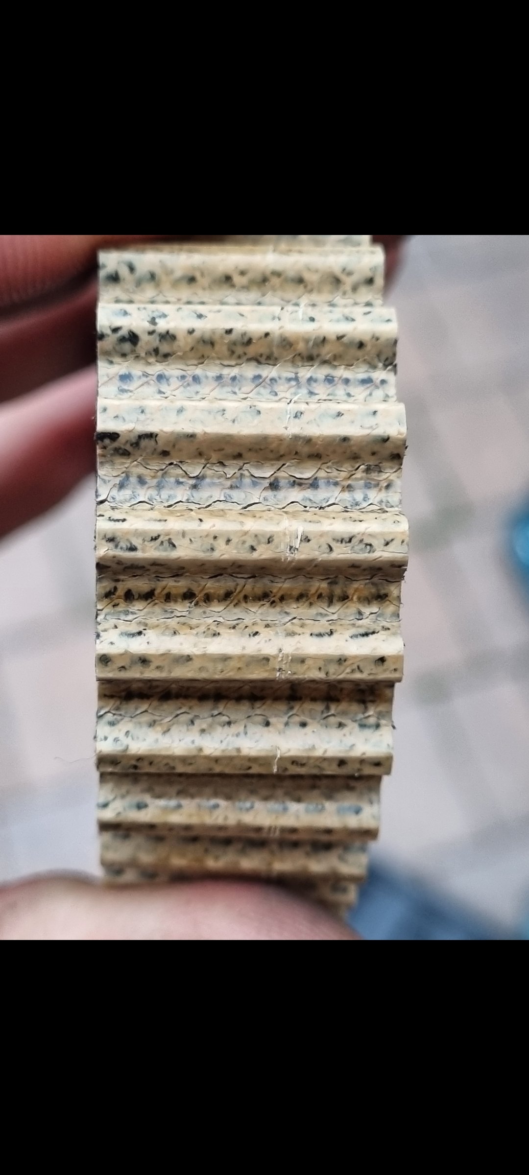

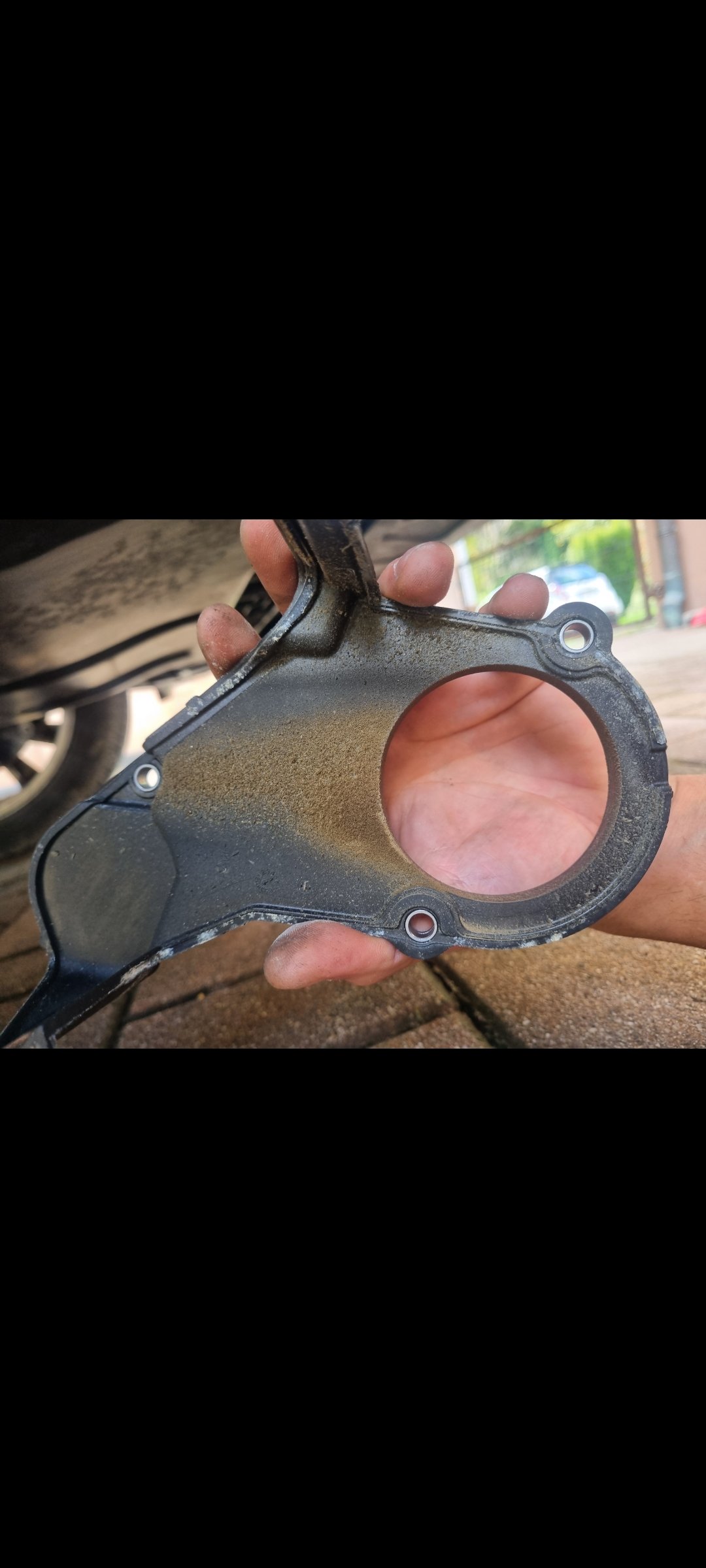

  1. Update on original post: I sucessfully changed the timing belt (my way), now ive done about 4000km after the change and so far car runs flawless.. About the old belt (that some say is timeless). After holding the old belt in my hand and inspecting it, im very glad ive changed mine. The belt was looking fine from outside, but had countless small cracks on the inside (where the teeths are).. Also alot of belt dust around the plastic belt covers... CHANGE YOUR BELTS FOLKS

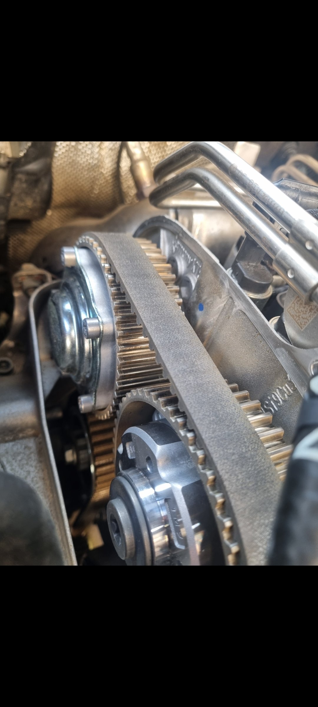

  2. Thank you for the info, but I do not trust either elsapro or 8 year old cam belt! We had engine rebuilt in ford galaxy 2008 because the belt snapped.. I do not plan to risk it.. For anyone seeking the same question as me (about not needing extra timing equipment), check this video: https://www.youtube.com/watch?v=eUw0pm4C2cg&t=18s
