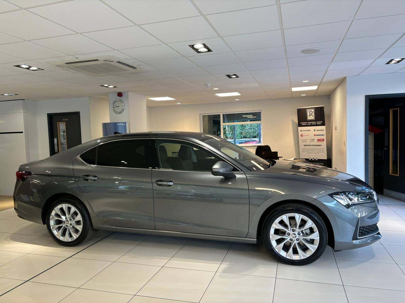

  4. HI, I am back in the skoda fold again. First time was a new Rapid Hatch in 2014, then a Rapid spaceback sport in 2016, then all sorts of other cars including Kia, Toyota, Volvo, Merc, Audi, and as of this month a new Superb 1.5 SE L Hatch.
