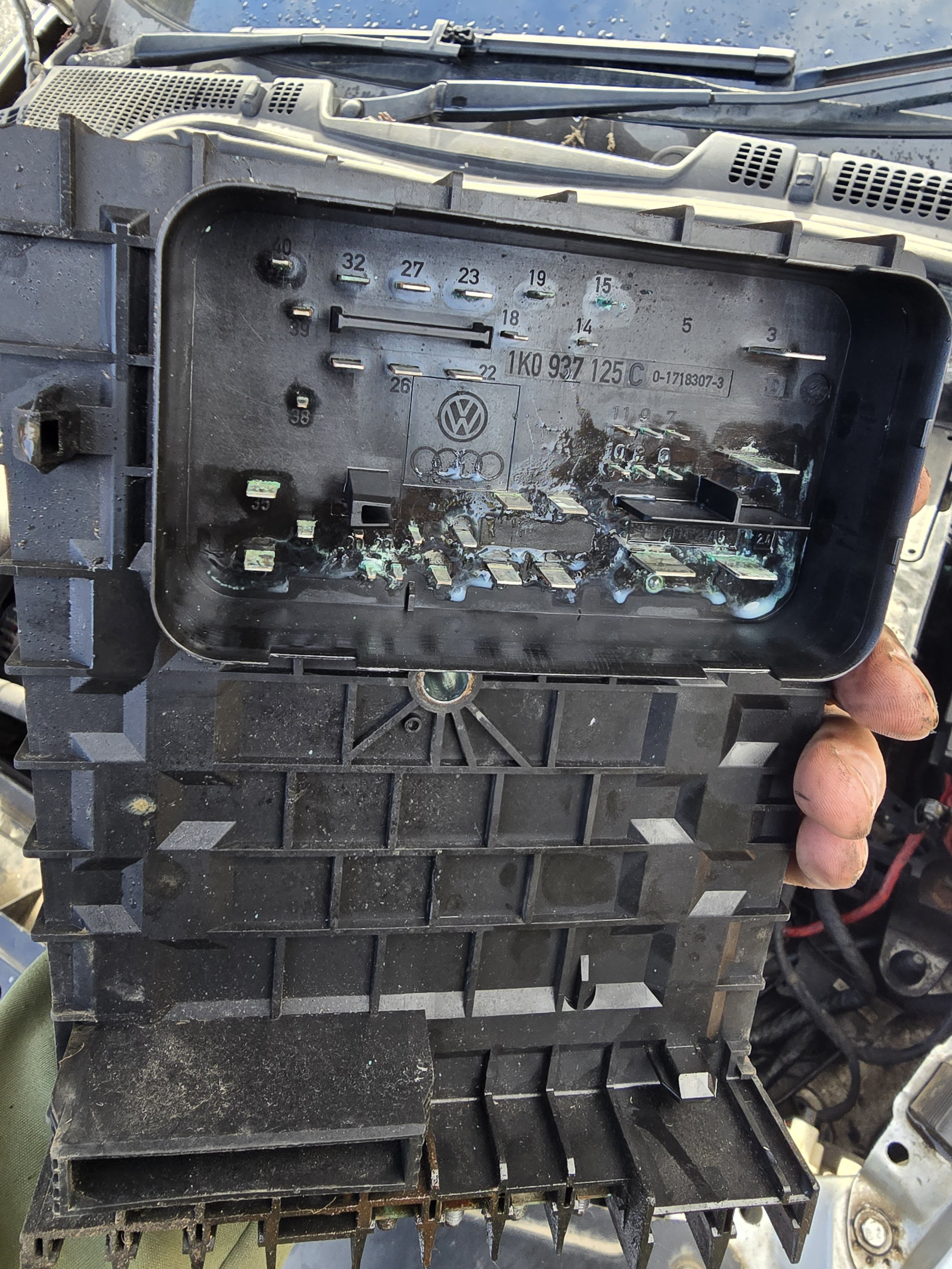

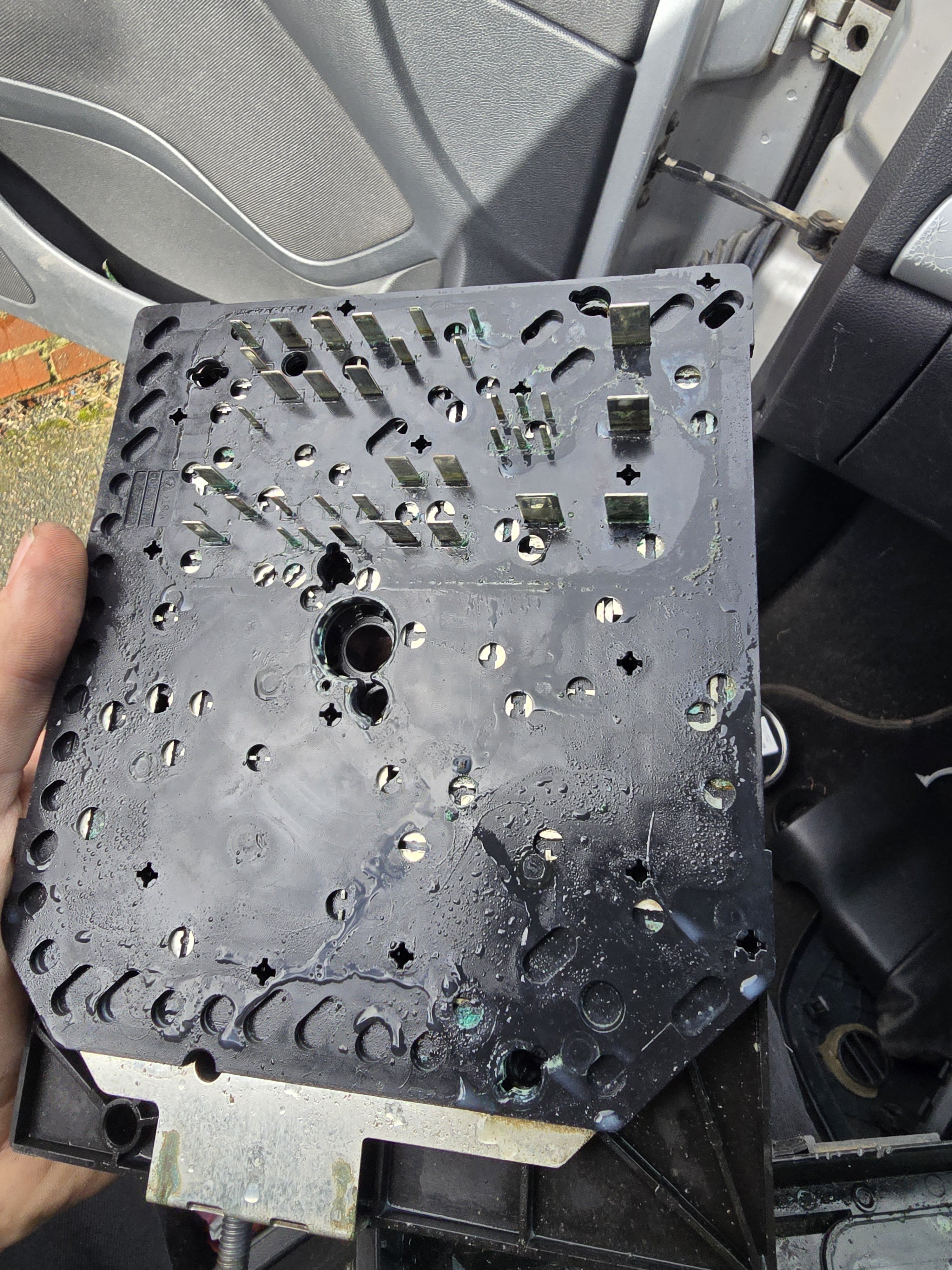

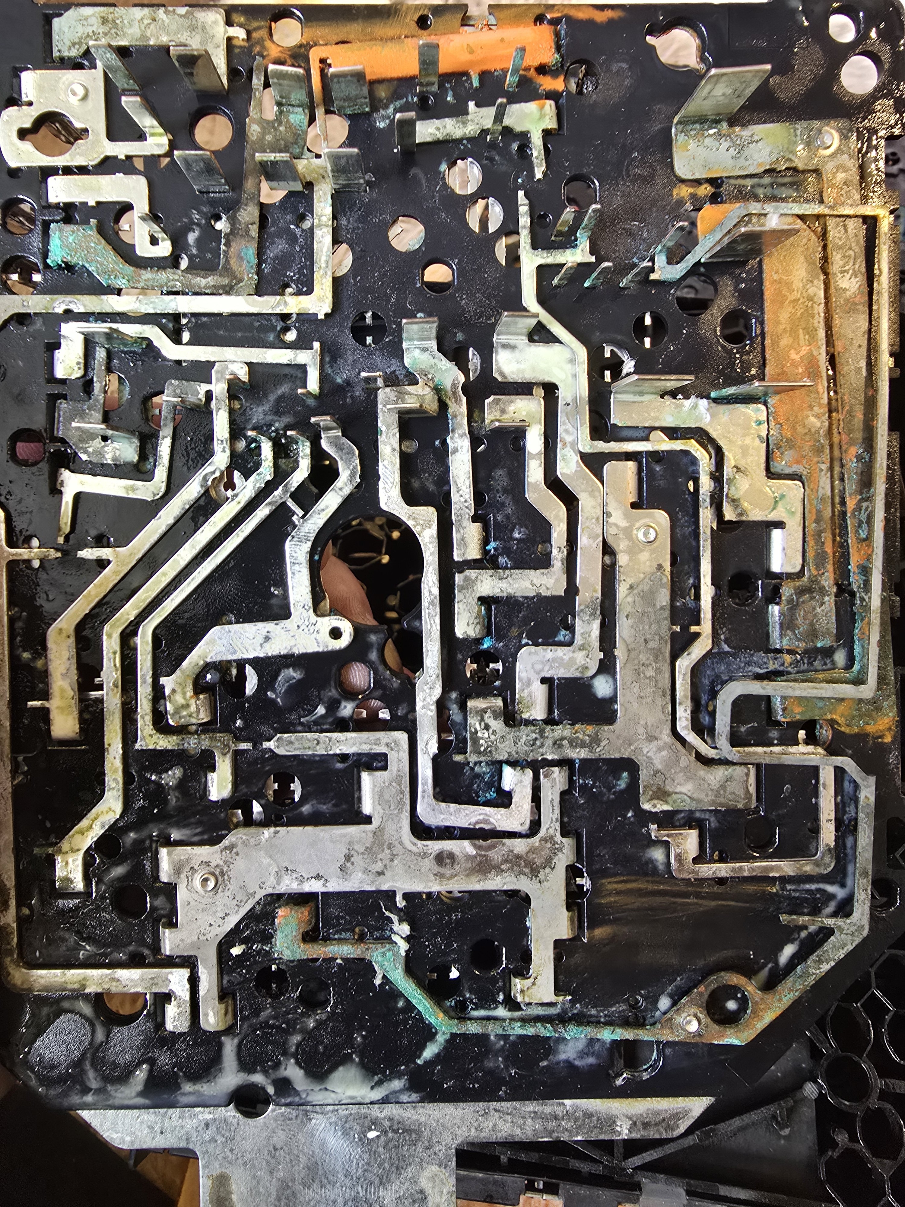

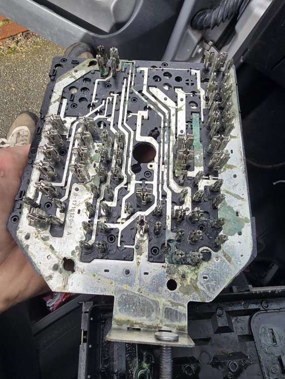

  9. Stripped fuse box out water had got in cleaned it but too rusted so put another on from another car we know was good and still the same any ideas
  10. Tried cl3aning it it was goosed. Tried another fusebox on off another car and no good still the same 😭
  11. I've opened up fuse box under bonnet it's green and milky allover going to clean it best i can and try again
