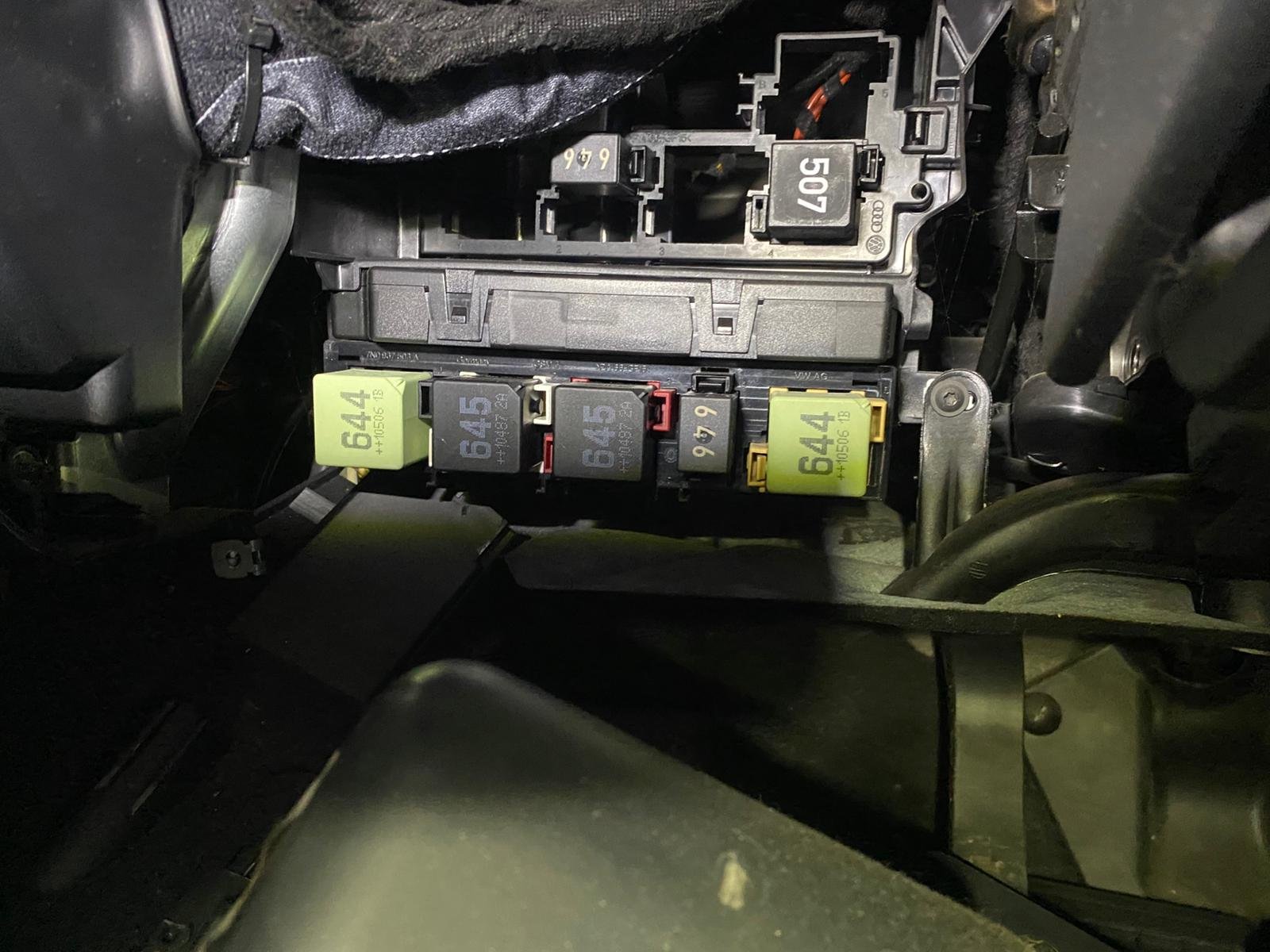

  1. I understand, but since it does not display on the clocks that the trunk is open, and I can lock the car with the remote control even with the trunk open, I think that the sensor detects it, the trunk light does not come on when the flap is open, which means that it detects that the trunk is closed all the time and the rear wiper should be unlocked. ?
  2. Octavia II FL Station Wagon from 2011 The rear wiper stopped working, the front wipers and washers work, the rear wiper washer works. There is a voltage of 0.04V on fuse 41 (from the rear wiper), but after pressing the rear wiper washer, there is a voltage of about 2.7V on this fuse (at the moment of washing) I have verified the wiring between the boot lid and the car and the wires are OK, there is no water in the lid after removing it. I swapped the relays with the same numbers except for relay 507 because it was the only one. Does anyone have an idea what else can be checked? ------ Regarding the trunk lid lock, when the trunk is opened, there is no information on the dashboard that the trunk is open, the lights in the trunk do not light up, they light up every now and then and then until the trunk is closed, these lights light up. With the trunk lid open, I close the car with the remote control and it closes, it seems to me that since the trunk lid is open, the car should not close, but I am not sure about that. One more thing, the trunk normally locks with the remote control after closing, and opens with the remote control and the button in the lid.
