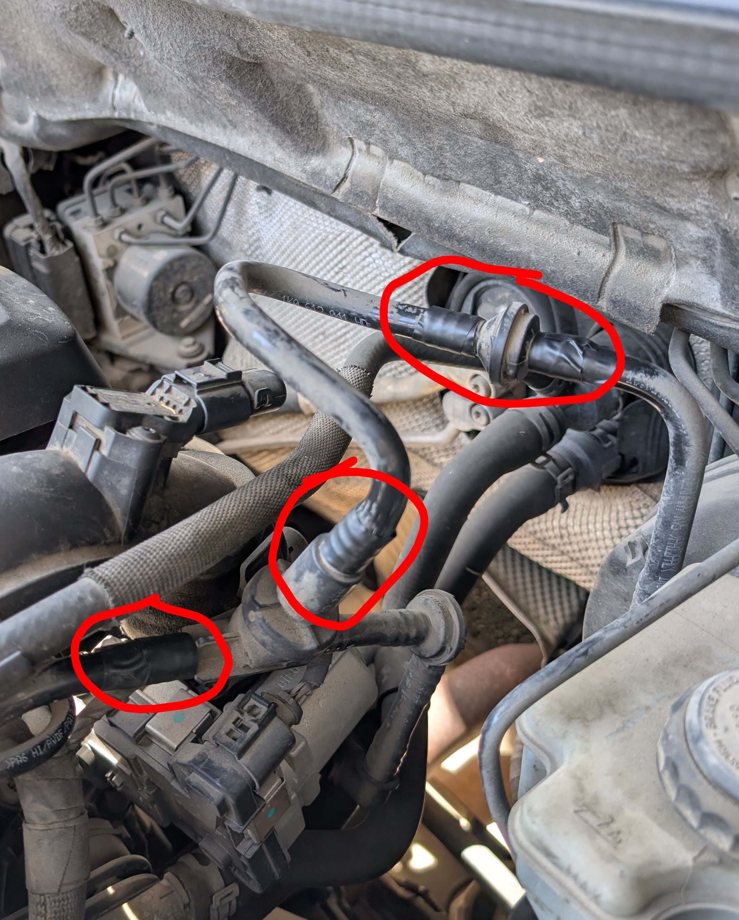

  5. So I did a homemade vacuum leak test, used a vape instead of a smoke machine (removed 2 years from my lungs) and I found that there is a quite big leak from a hose connector going to the brake booster (lower red circle in my first image) that I tried to tape but I probably didnt do a good job. So I need to replace that hose and maybe (I hope) it was the cause of these issues I was having.

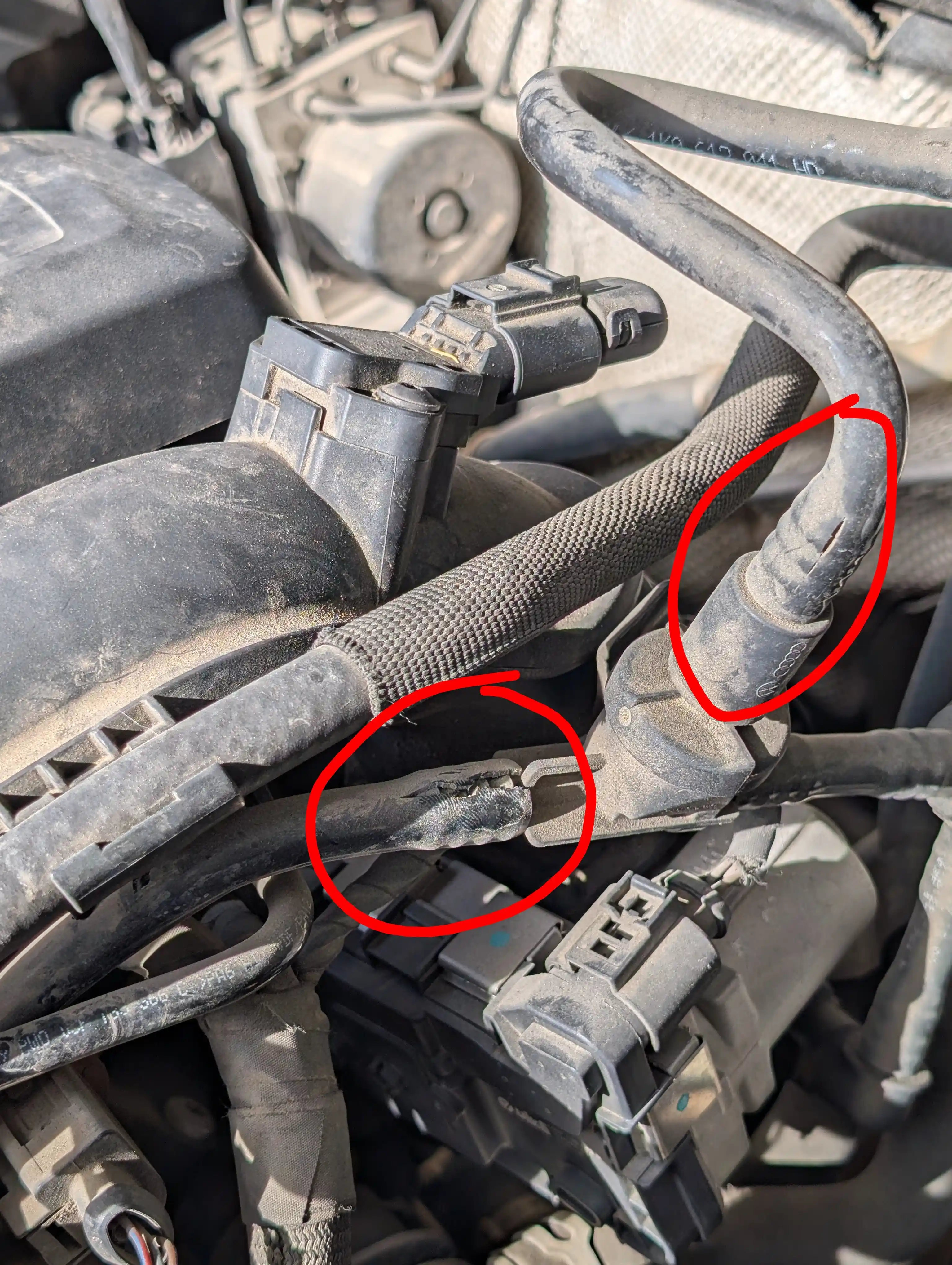

  11. Hi all, my 1.2 tsi isnt running the best, in higher gears and higher rpm the engine hesitates a bit and the idle feels like it could be a bit better, there is no check engine light or something. It has new spark plugs, new spark plugs wires, new air filter and new throttle body (when replacing the spark plugs it looked like they were running a little lean) Before I replace the coil pack I decided to check for vacuum leaks and I saw this line super cracked and more lines going to the brake booster to be cracked also. Can I replace them with rubber lines? these ones are rock hard.

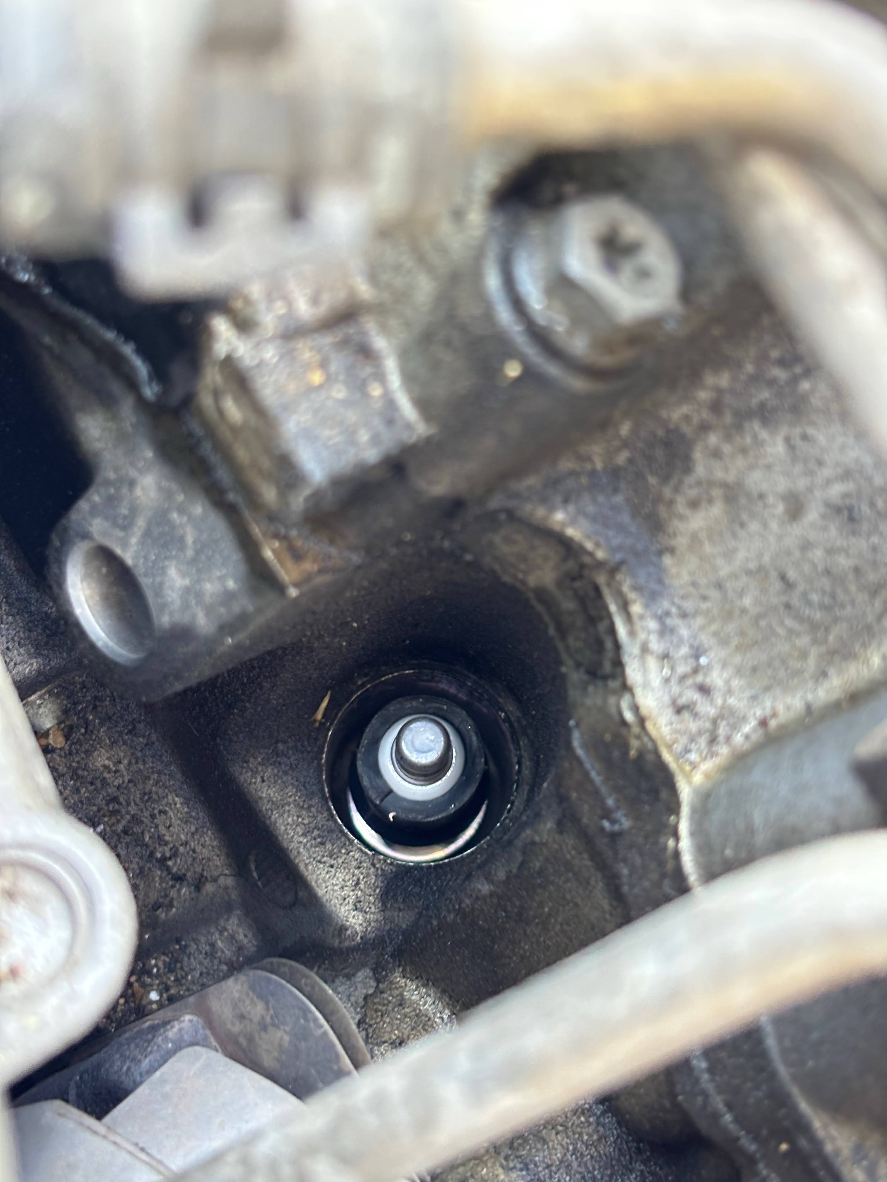

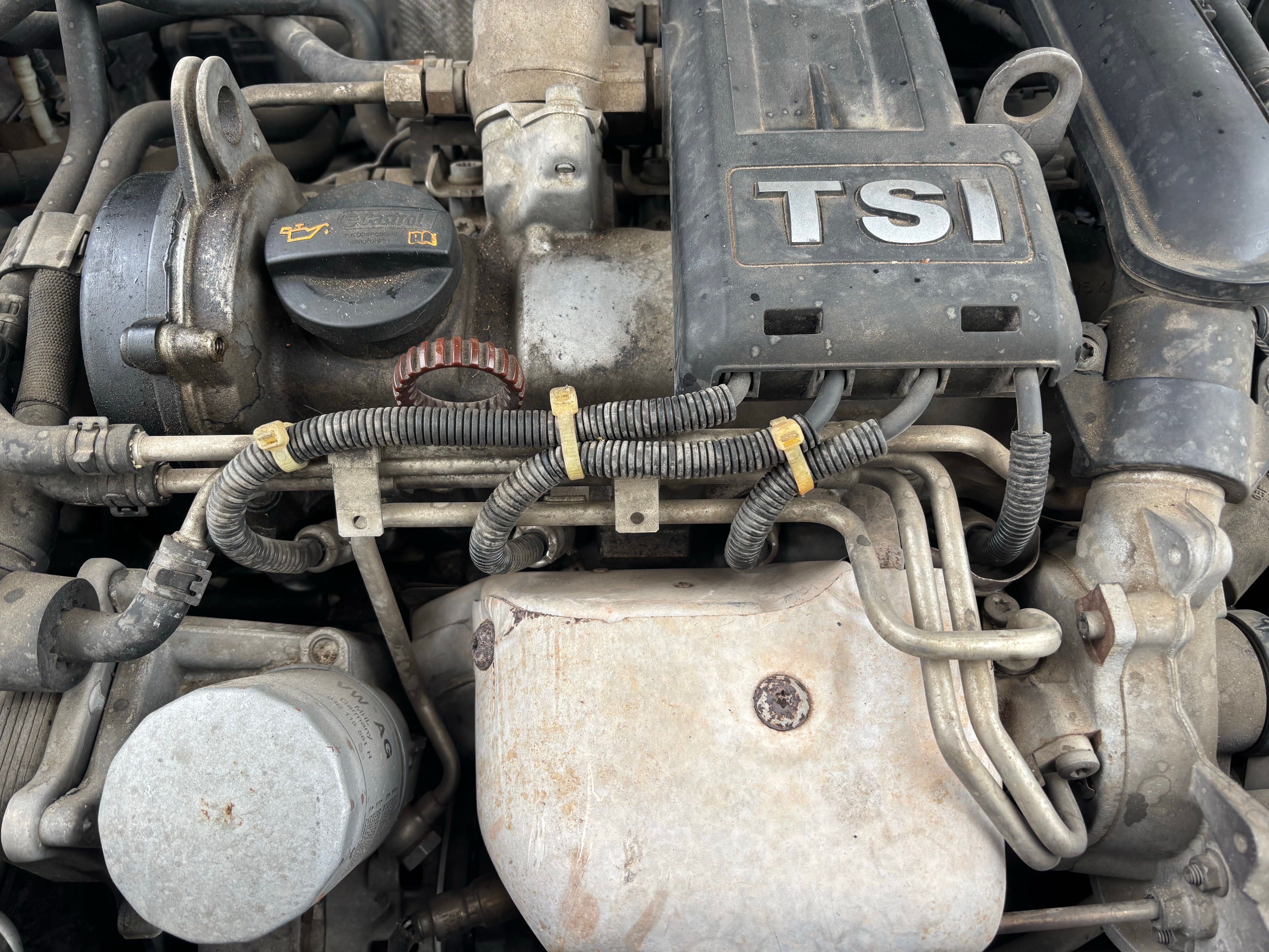

  12. Update: After a long hour that broke my back I managed to remove the rubber boots that got stuck on plugs 1 and 2, then I removed and inspect them and they seem ok (I have seen worse, I was so stressed that I didnt buy new ones because I just wanted to fix the mess I made). Then I bought new spark wires that cost about 75$. After replacing the 1 and 2 spark wires the car ran great and after a short drive I think it even fixed the original problem I had with it.

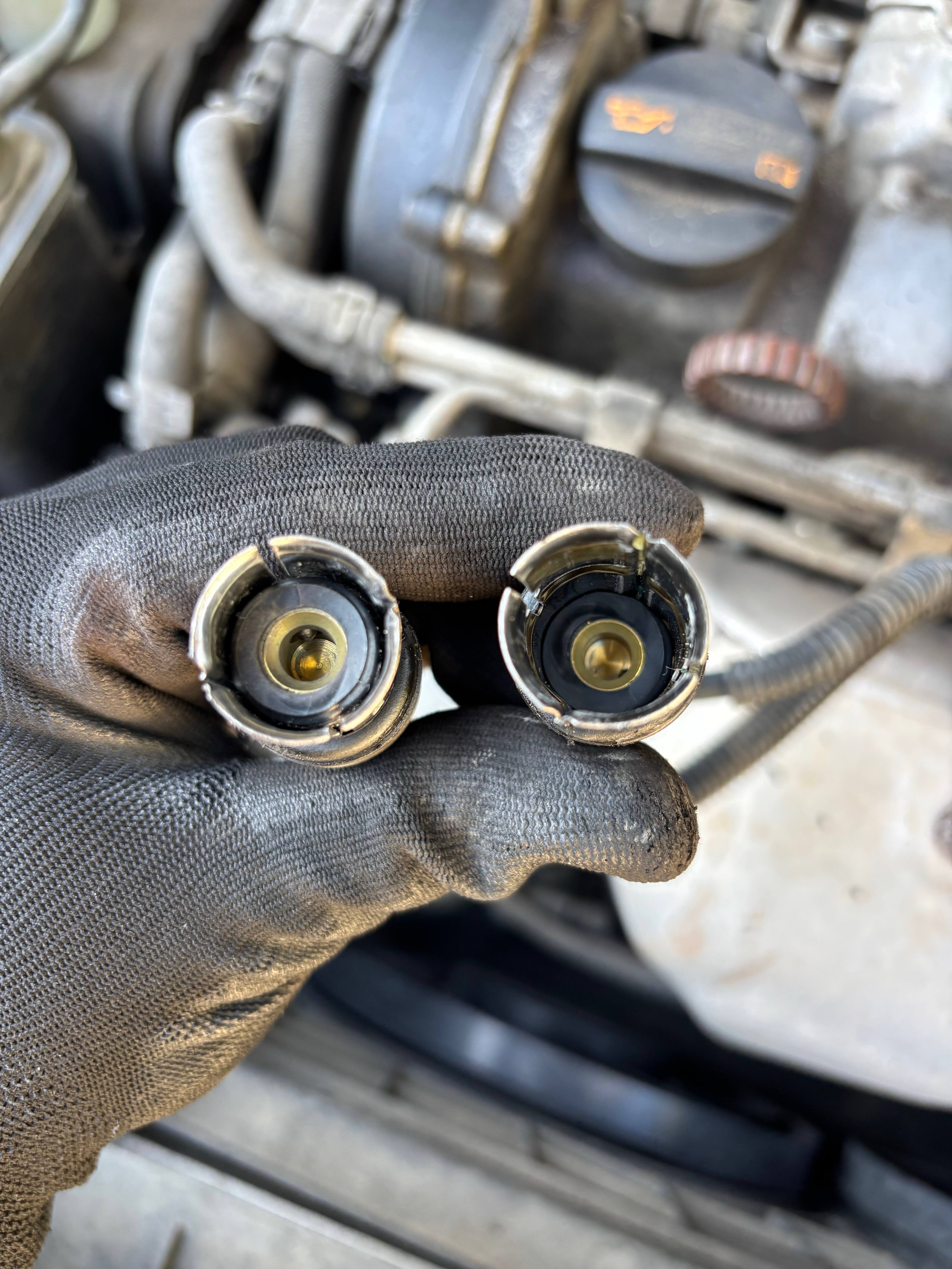

  13. Something went bad, I tried today to replace the spark plugs but my socket (16mm) would not fit because the plugs have a rubber boot on them (maybe from the spark leads?) this is how the 1 and 2 spark leads look like (1 on the left, 2 on the right): So I connected them back because i couldnt remove the spark plugs but then a random misfire started (Im almost sure from cylinder 1 because I put my ear near the engine and everytime a misfire happened there was a click (probably a short?) coming from the 1st spark plug. I went for a small drive and if I put some load on the gas pedal the car shakes and cant output power at all, I need to give it a gentle gas to drive smoothly. I tried to connect and disconnect the number 1 spark lead several times and still no difference. The only thing I did to the engine is to disconnect and connect 1 and 2 spark leads, can it be that the number 1 lead is failing?
  14. Yes they have the armour around them, they are even ziptied so I guess they have been previously replaced. I still havent checked the sparkplugs so it will be a task for the weekend.
