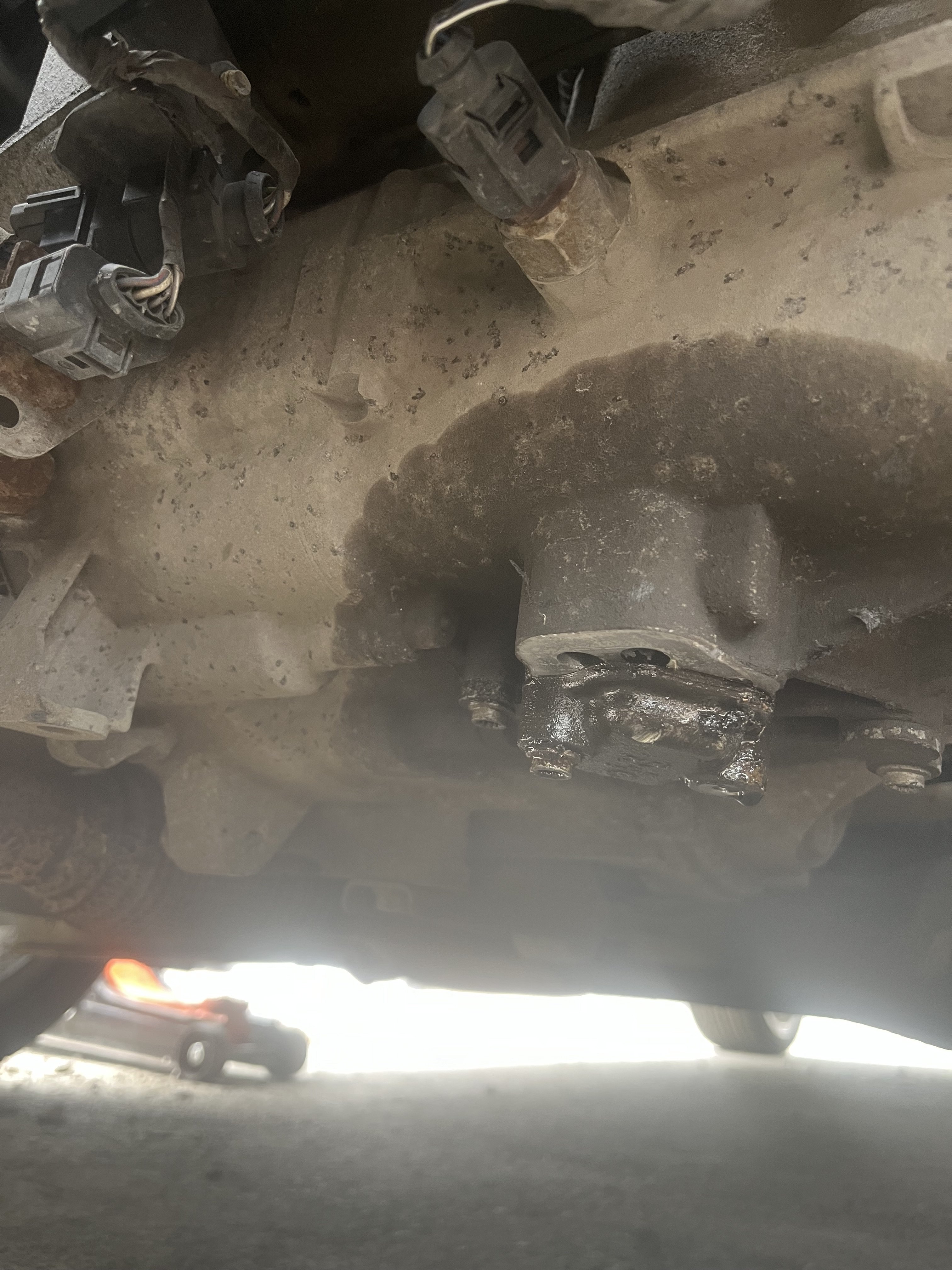

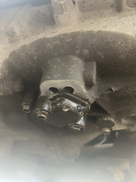

  3. Rebuilding a fabia mk2 monte carlo, suffered a hit to the front left, put new lower arm and ball joint on and it now drives and is aligned better, however when driving forwards there seems to be a tapping that goes with the speed of the wheel, listed a video of the sound below
  4. aligned the end cap and it works perfectly, will get the bolt extracted soon and drain out what’s left of the oil and fill it up - thank you for helping
  5. does it look as if the end cap is holding anything in - as in if i fully remove it will i expect to see anything else come out with it, will try aligning it first and see what happens
  6. Will give it a try tomorrow, if it doesn’t seem to fix it i’ll take the sheared off bolt out too and inspect more
  7. bottom right of bumper is gone, wheel is fine but lower arm has been bent quite badly back, power steering pump bracket has been mangled too but pump seems salvageable, managed to find the part number on the sheared off part - 02t301252A, seems to be a shifter tower end cap so hoping it’s the spring or minor damage on it causing the first few gears to not engage
  8. will definitely take it off soon when i get the time, could be to do with the selector and have a spring from what i could find
  9. It’s the manual 5 speed, only other picture i had but can take more tomorrow
  10. Purchased a crashed 2014 monte carlo 1.2tsi today, i knew about all issues including the fact it didn’t go into reverse, first and second. However, 3rd, 4th and 5th are smooth, i noticed this damage and leak under the gearbox and assume it has something to do with this, can’t seem to find much information about what it is or how to fix it

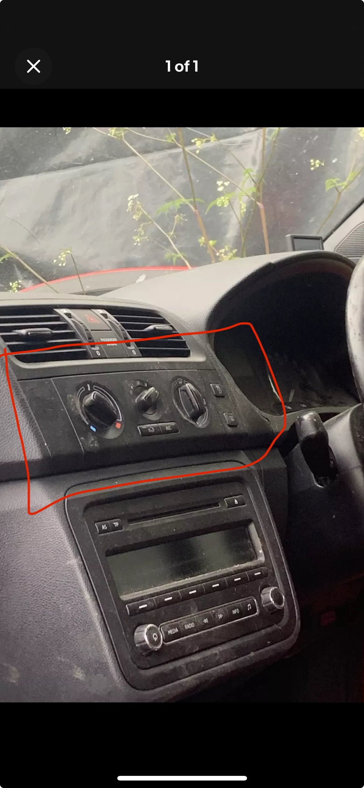

  11. I’m looking for some trim which goes beside the climate control panel, it’s on the left in the red box
