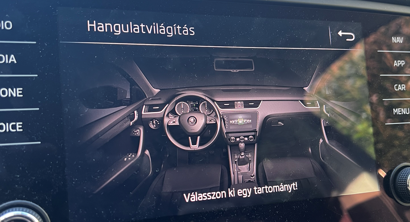

  1. Hello Everyone. I have a Skoda Octavia 3 (5E5) combi from 2014, it has been retrofitted with the MIB2 Amundsen head unit + screen, however since it has been upgraded I cannot access the adjustment for the footwell lights, I cannot turn it off, adjust the lights from the center screen. In the original Bolero screen the option was there as only a line in the settings, now I have the Ambient Lights option only but no option to change anything at all on the screen. The car was originally built with the footwell lights. Any idea how to get back the option to adjust the foowell, I can code it in VCDS, tried a couple things from the forum but didnt work any of that. I dont want colours only to be able to manage the brightness, or turn it off from the center screen. Any help is greatly apprecitated.
