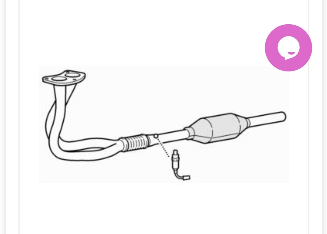

  3. Do you happen to know what the pressure should read? Thanks

  5. Thanks for all you help, il get a picture tomorrow as I'm not with the truck at the minute. I do have injector cleaner to put in. iv ordered the sensor and I'm going to remove the exhaust to double check there definitely is not a place for it. Then I will get a new one ordered. Thanks again!! 😁
  6. I don't have a heat shield..just a manifold and no place for a lambda..this is what the pipe I have looks like but without the lambda bit..after doing some digging that pipe says it's the cat for a 1.6 Felicia pickup ??
