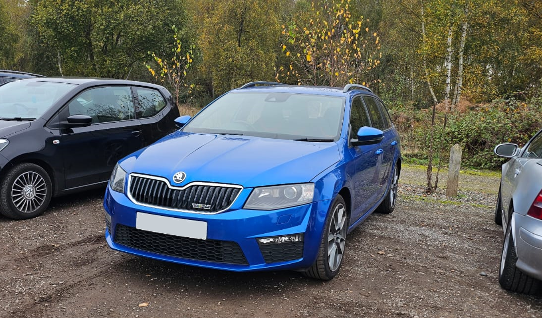

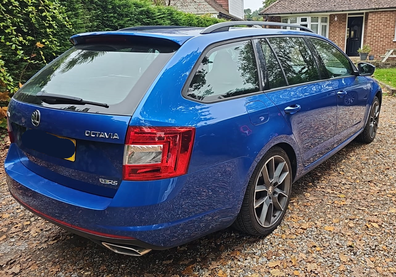

Hi, New owner of a 2015 Octavia VRS Estate and loving it, despite having an issue already! I will post that in the relevant forum area.
