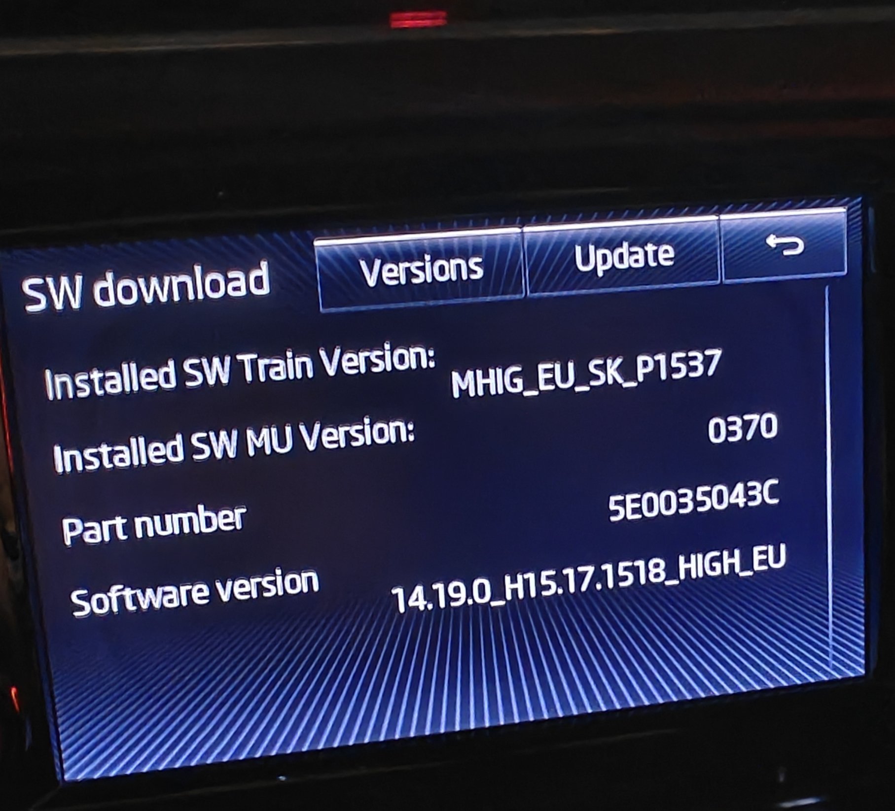

  13. Hey @pab567 any updates for my infotainment?
  14. Hey @pab567. Is it possible to get update for my infotainment system ? Ty kindly
