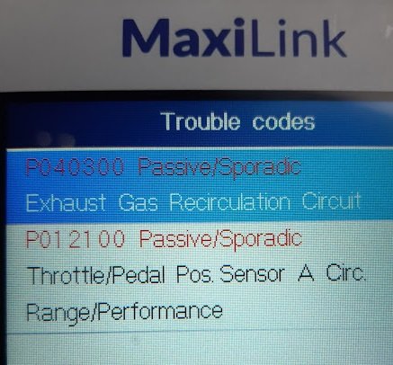

  2. Hi Thanks for the replies. I've scanned car today and cleared codes which were as follows. The P040300 has come up previously (about 3 times in 10,000 miles) and I go for at Italian tune up which gets rid of EGR light on dash, then I cleared the code. The P012100 code is new and didn't come up before when EGR light lit previously.
