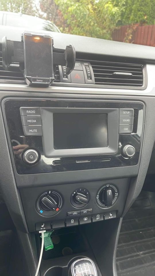

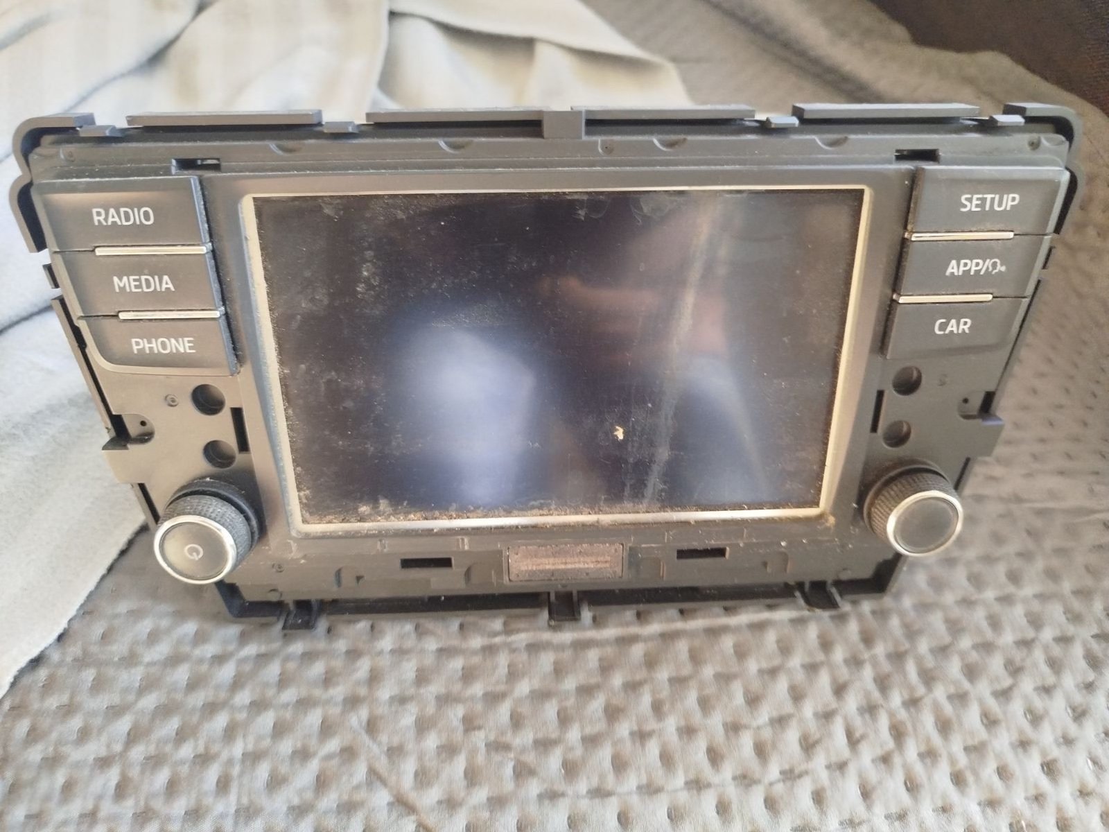

Head Unit looks like this but instead of sound its App and instead of mute its phone. I think its pre facelift because its 2017/2 and the facelift came a few months later.

I got the same frame like you in the picture, and it has some other screws on the inside, so i was thinking it can be taken out so the new one can be put in

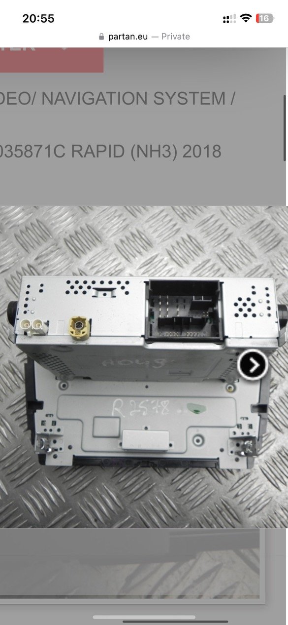

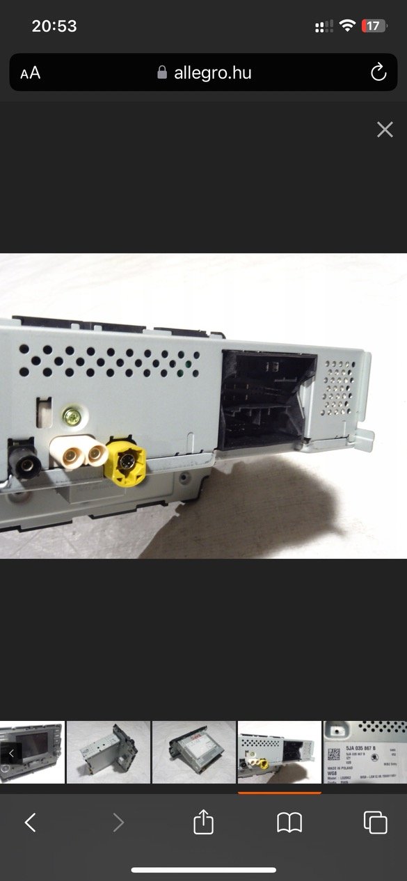

Hi guys, I wanted to swap out the media in my 2017 Skoda Rapid for a better one with SmartLink to have Carplay in it. I found one from a scrapyard Rapid, but I have some concerns about it: Firstly, as you can see in the pictures almost everything looks the same on the back except my original (Swing - Pic 1 and 2) mediaplayer has a black output but the other one (Bolero - Pic 3 and 4) doesn't. Why is that and what does the black output do? Second, has anyone done this kind of swap and will it work? I know I have to activate Smartlink to have Carplay, but at first I want the head unit to do the exact same things as the original one (rear sensor, read my phone through usb) then I will go to a guy who can activate SmartLink. Third, the new head unit's cords are cut, will the cords from the original work with those? Are there anything else I should be concered about? Thank you for the help in advance!
