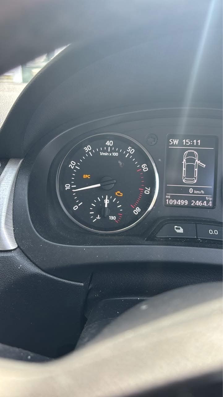

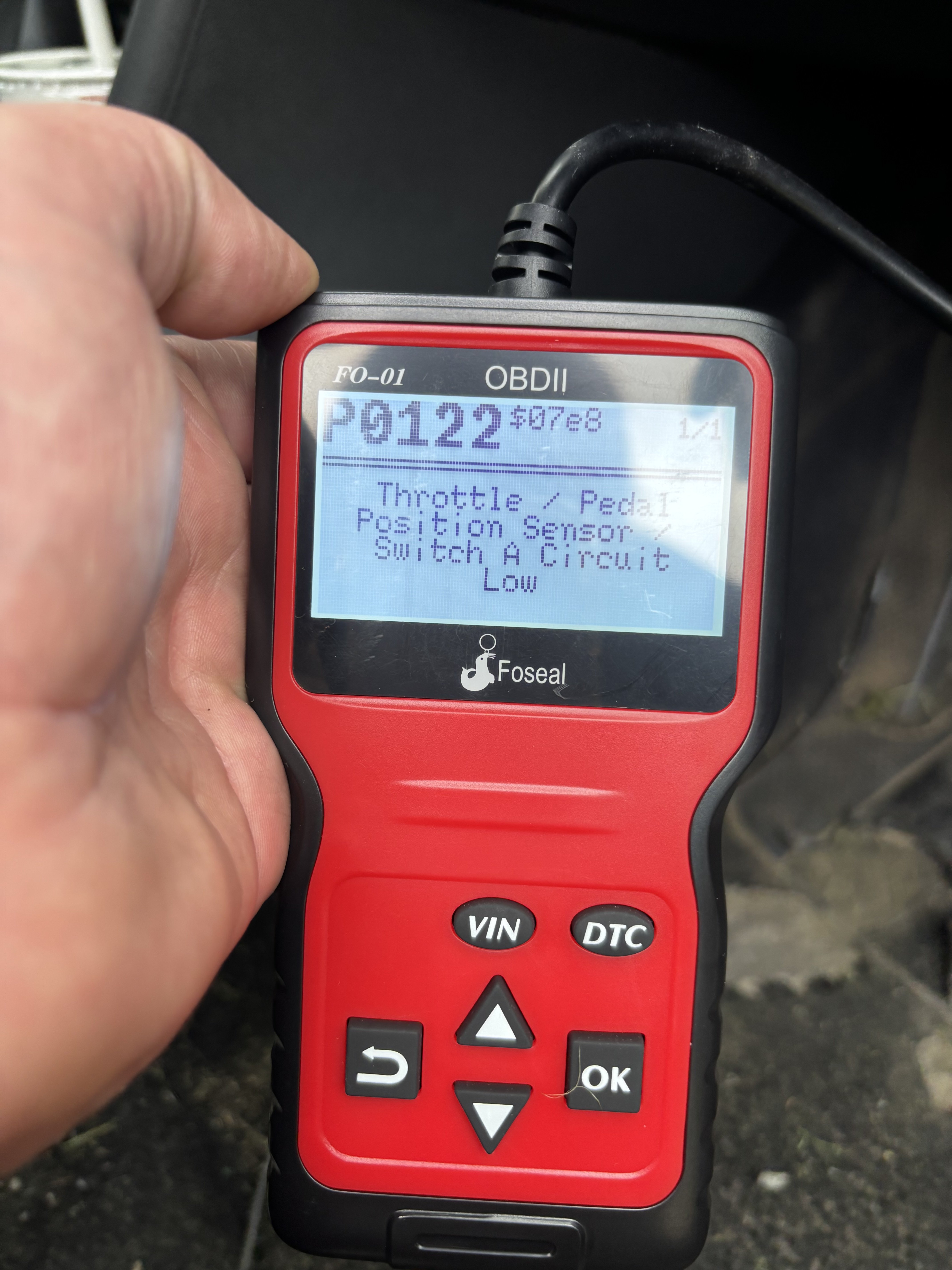

  2. Good afternoon everybody. I have a 2014 Skoda rapid with 1.2 tsi petrol engine in. A couple of days ago I had the EPC light and engine management light come on and the car was restricted revs wise and throttle response was poor. It later went into limp mode and was barely drivable literally creeping about 5mph the vehicle stability warning also popped up. I have since plugged into a machine and pulled up code P0122 which is (Throttle/pedal position sensor switch A circuit low) Upon researching this I have come across a few possible options to remedy the situation. 1 being the pedal switch. 2 being the throttle body. And 3 being throttle position switch. Has anyone had the same issues with their vehicle or have any useful information that could pin point the issue? Any help would be greatly appreciated. Thanks Stuart .
