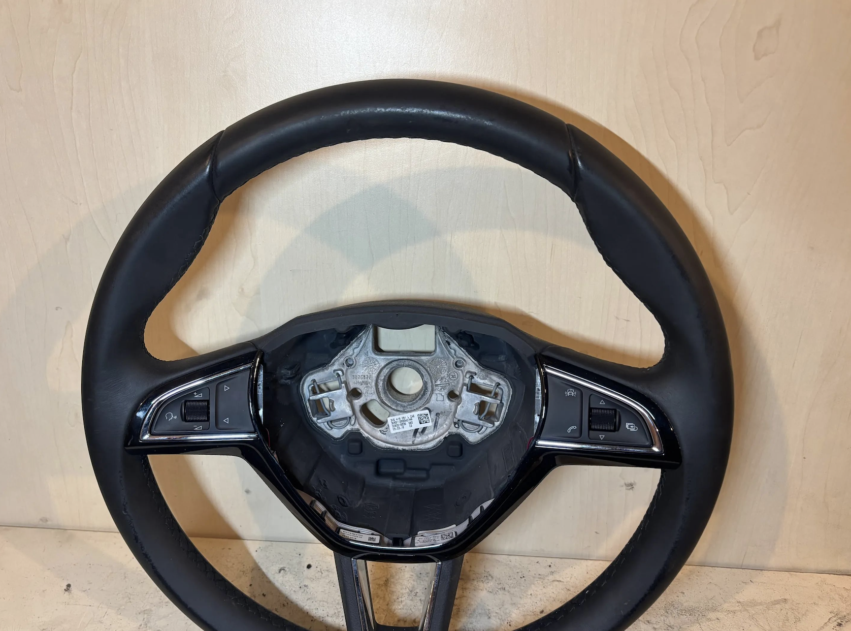

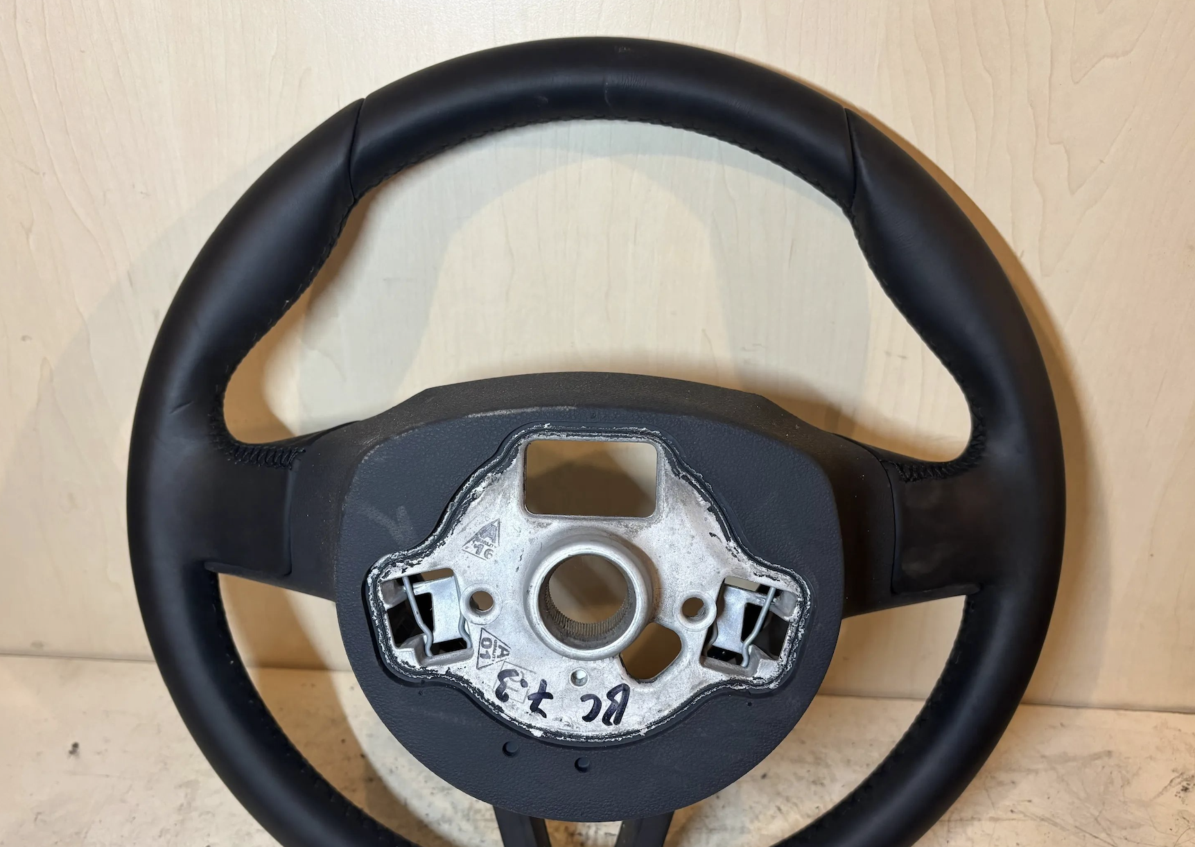

  2. Pretty straightforward - they are kind of plugged in if I remember correctly, just slowly wiggle them out. There probably will be videos of that as well. Try button fixing videos and they'll disassemble them there.
  3. Hi Lee, Yes, it did. It is literally a five minute job.
  4. Thank you both for your replies! I fitted the new steering wheel and moved the blank buttons over to the new wheel, as my airbag I had only 1 connector and nothing for the buttons. Very simple swap.

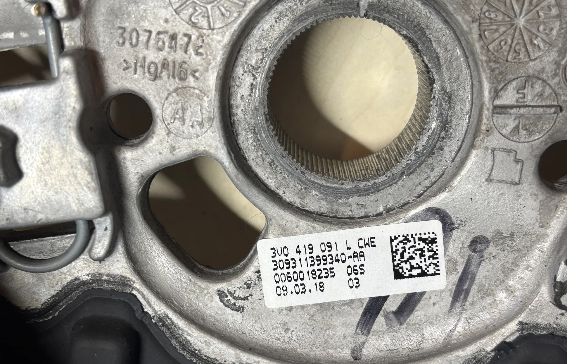

  6. Hi Skoda enthusiasts, Although there are quite a few topics similar to this one already on the forums, please allow me to ask - my 2014 Octavia Combi currently has a 4 spoke steering wheel with no MF buttons. I have cruise control on my left stalk and control the small screen on the dash from the right stalk. I wanted to upgrade to a three-spoke steering wheel, just for the looks - I found one for a fair price, but wanted to ensure it would fit. The part number is 3V0419091L and it came off of a 2016 Skoda Superb. It also has buttons on it. I would appreciate it if you could help me clarify the following: Is it possible to move my no buttons part to the new steering wheel? (i.e. remove the buttons from the new steering wheel as I think it's a lot of trouble to set them up); If I were to keep these buttons, would I be able to connect them and these buttons light up in white or green as they're from a 2016 Superb? (If it is possible that I just connect them to have them light up with no functionality); Would my airbag fit the new steering wheel without any further modifications? And finally, do I understand correctly that everything should be plug and play and quite simple? Below you can find photos of the new steering wheel. Thank you!
