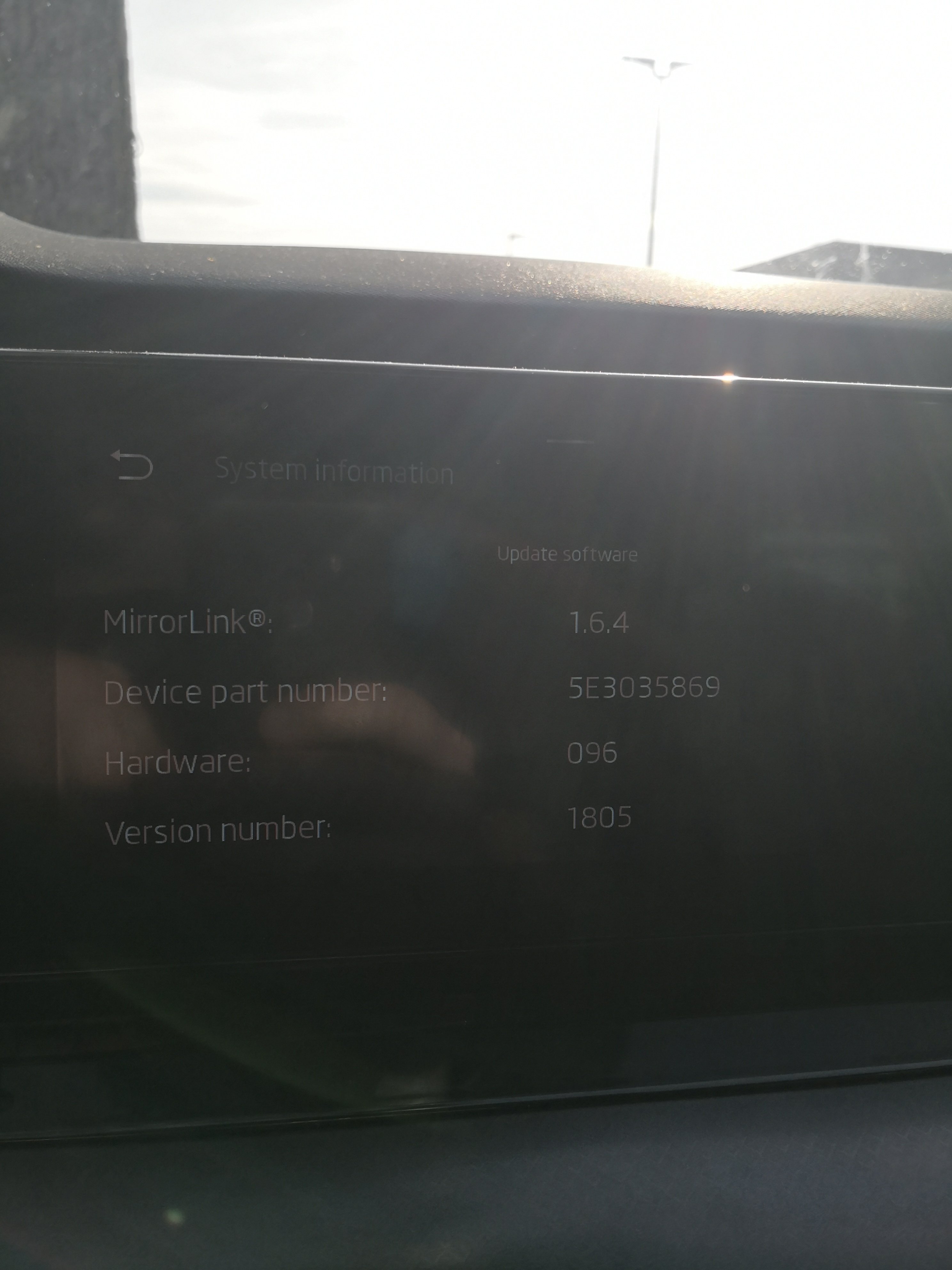

  4. unfortunatley, no I would have to pay for a FEC/SWaP code to unlock wifi.
