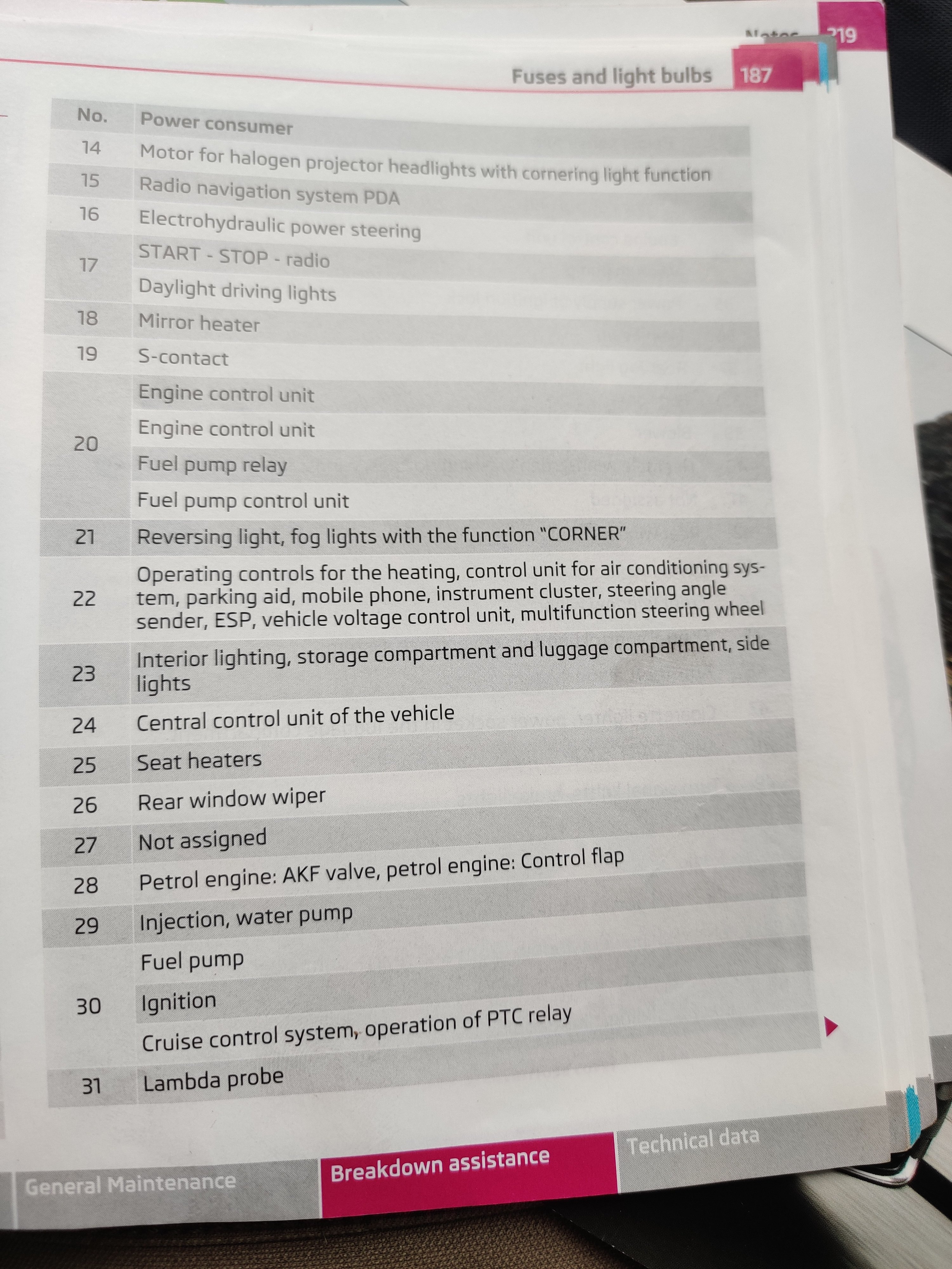

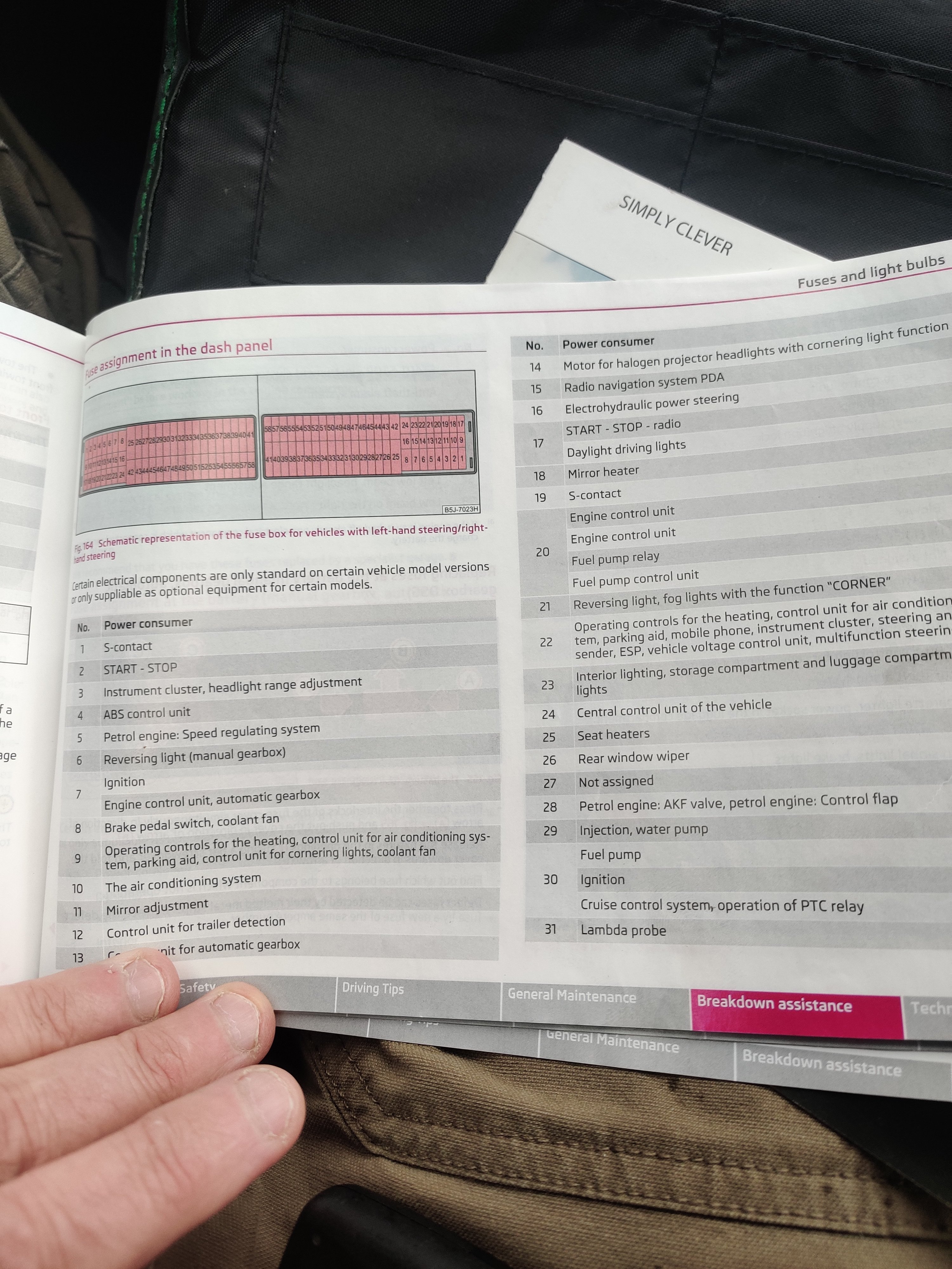

  12. Sorry above pic missed out side lights here it is
  13. Sorry didn't see your update. It's listed in handbook.
  14. Cheers. They stopped working overnight last week.
  15. Hi, Thanks for the reply, Fuse 23 is listed as interior lights and side lights. When I looked I don't have a fuse 17 which is for DRL:s My model doesn't have drl's the side lights have to be manually switched on?...
