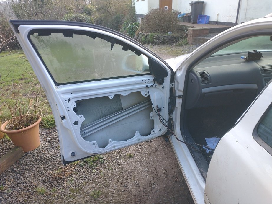

  1. Well, I gambled on a used controller unit from Ebay for a whole seventeen of your Earth pounds. Without fitting it I just swapped the wiring over and the indicator repeater started to work once again. Quite possibly that means the various other problems relating to that door are also fixed, but as tomorrow is the last day the car can be re-tested I swapped the controllers, reassembled the door and whizzed the car back down to the garage for them to look at. After that I just need to deal with the alternator issue. Well, I say "just". In fact I now have a log from VCDS with all the details from the car. I couldn't justify the price tag, but an acquaintance who has a copy kindly offered to run a scan for me. So I have a file with "useful" stuff like this: Address 03: ABS Brakes Labels:. 1K0-907-379-MK70M.clb ... 1 Fault Found: 01309 - Power Steering Control Module (J500) 008 - Implausible Signal Just need to work out how to interpret it now, but I see the manual is online so hopefully that will help me through. James

  13. Same thing happened with my daughter's C1 about a month ago. i used the Dremel cut-off wheel to remove both the nut and the splined bush. Worked a treat. I cut through the nut as far as I dared on opposite sides and it then broke apart when I put a socket on it to try to turn it. The bush I had to cut diagonally because there wasn't clearance to cut along its length and then I just levered it apart with a screwdriver until it fell off. James
