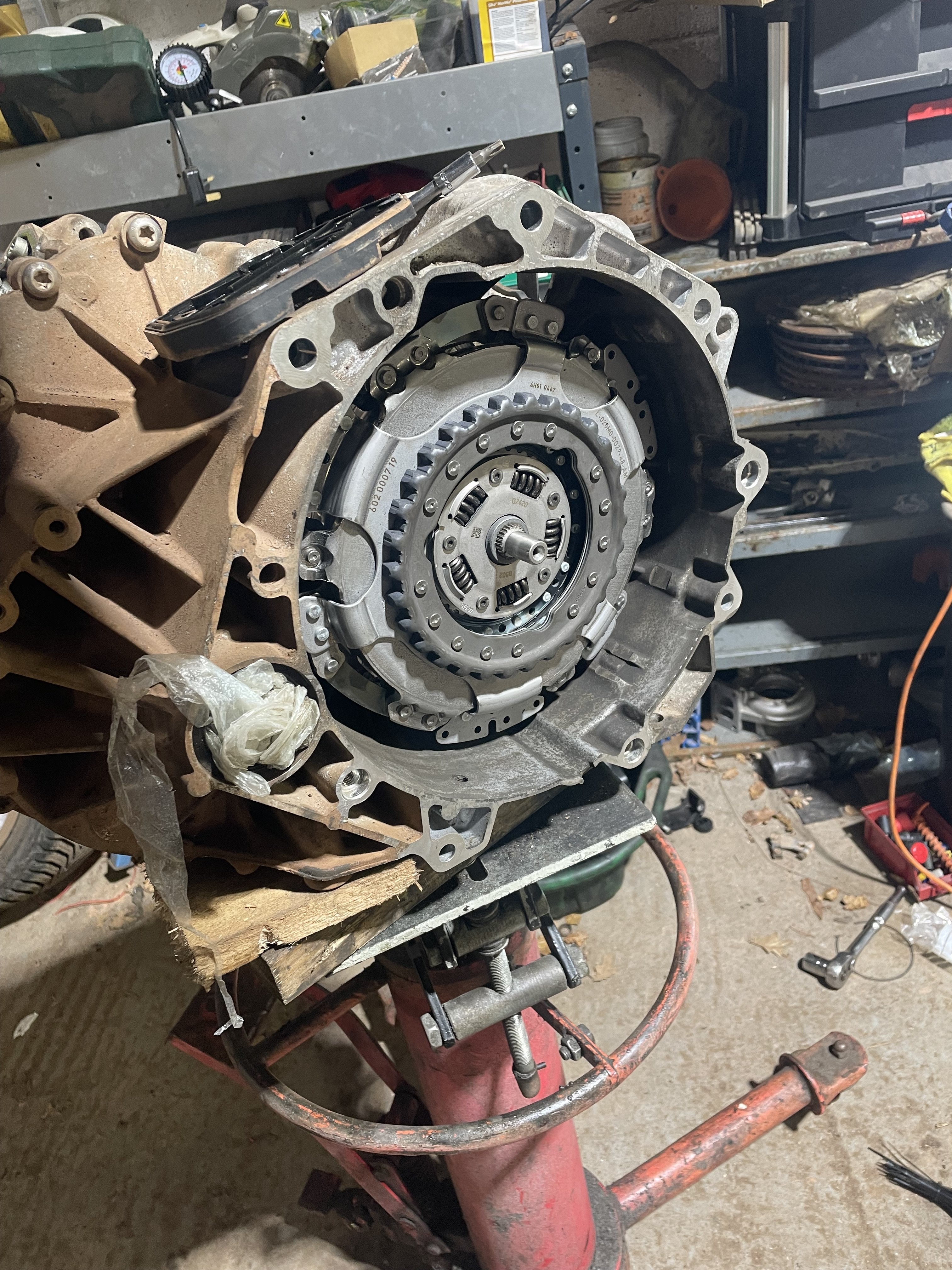

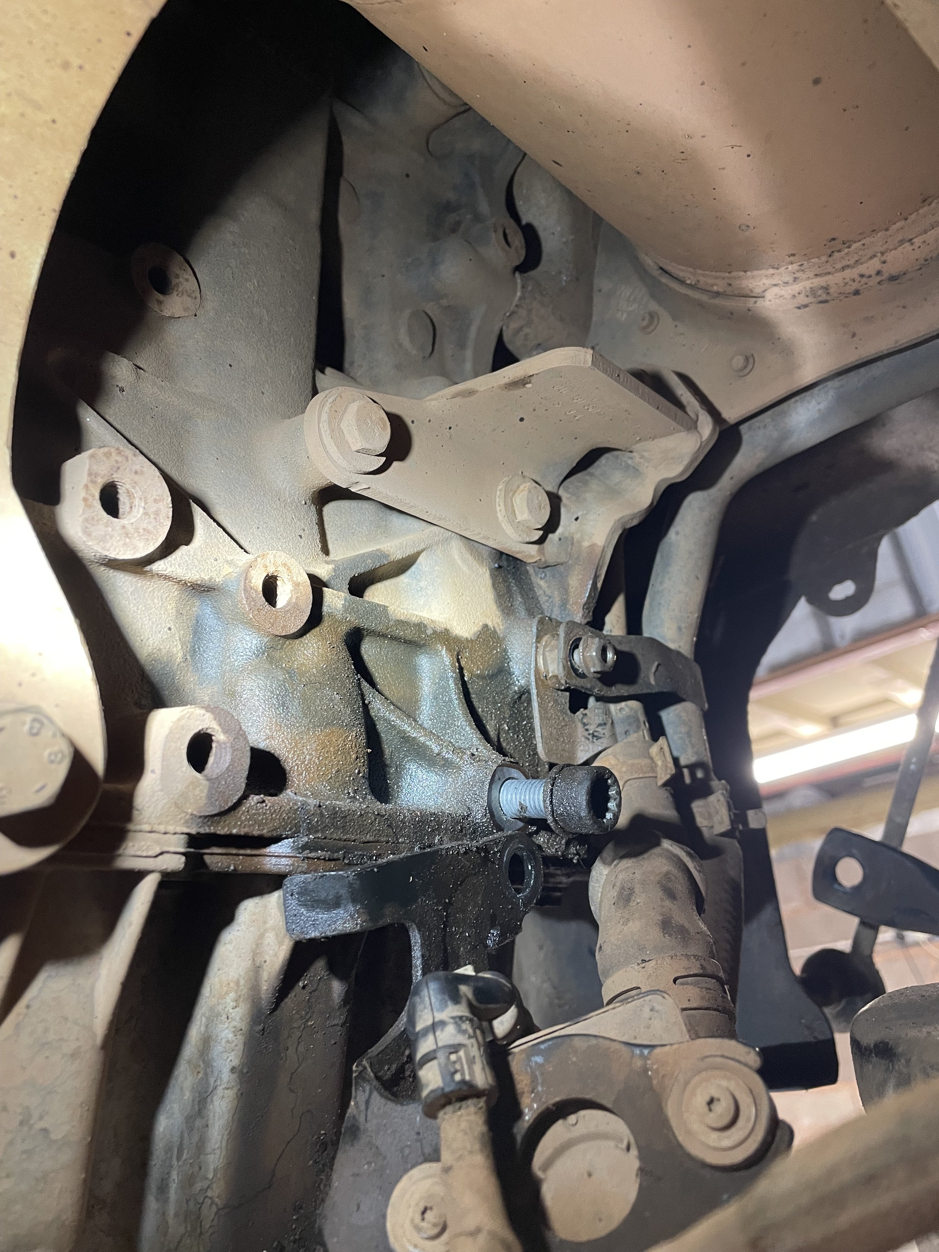

  2. gearbox was very fiddly to get out but easier to get back in again had to take the cv drive cup off the engine side to be able to navigate it round the engine, as mentioned above the little metal shim between the engine and gearbox is also a pain. definitely made a lot easier by a proper lift and transmission jack hopefully this helps someone else in the future as when I was looking there wasn't much available online but after days of looking about managed to save £100s in buying LUK tools

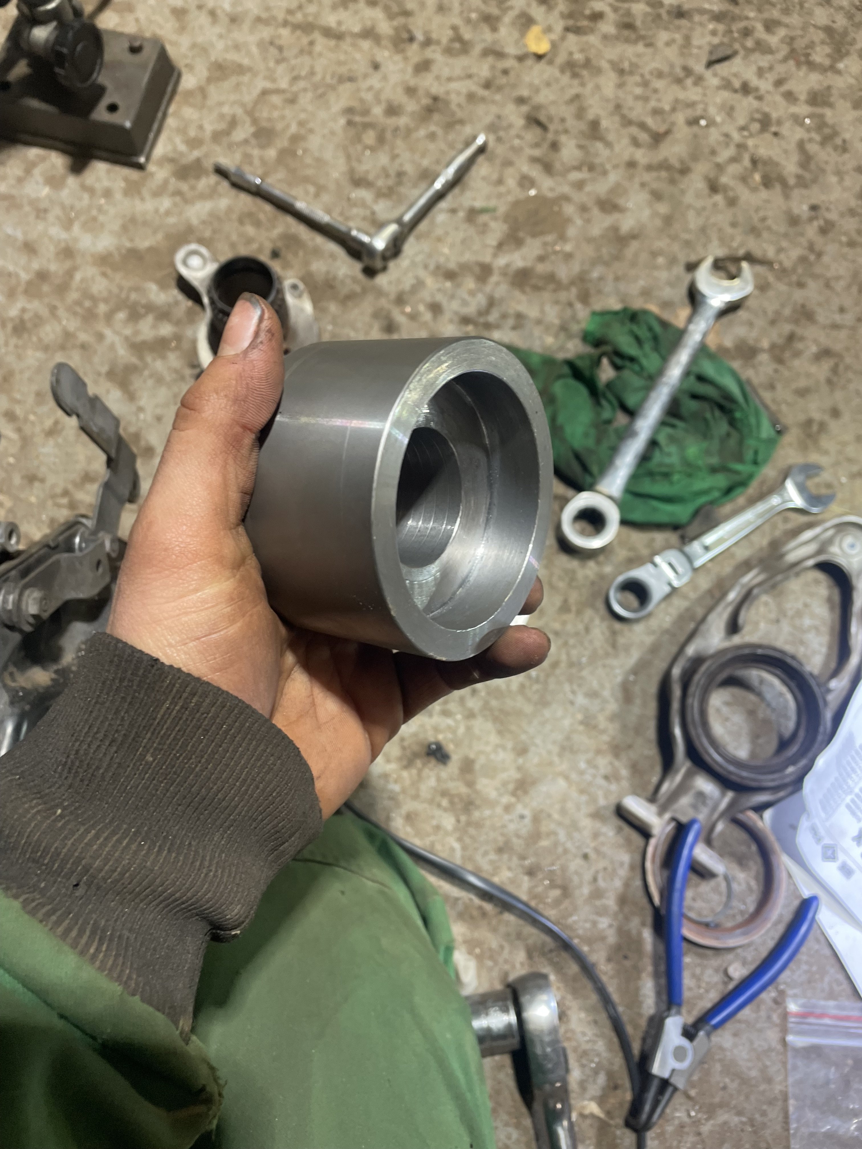

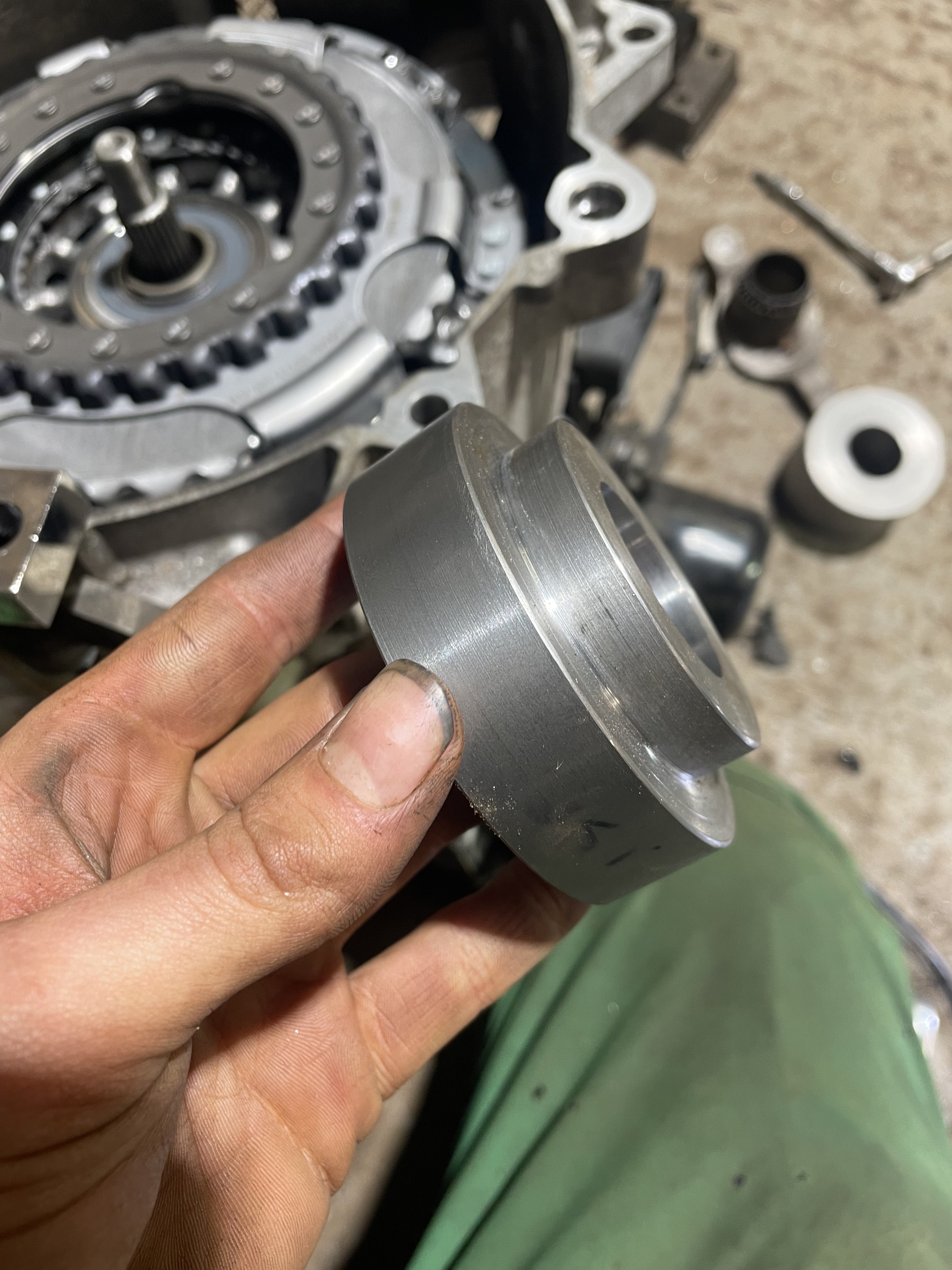

  3. Brought the clutch&flywheel from Parts In Motion who verified against my VIN that the parts were right Made my own shimming tools from some dimensions I found online that match the very expensive LUK kit. Landed more or less in the middle of the shim range so seems right. Brought £50ish puller/press set from eBay for removal and reinstallation which was worth it, but apart from that didn't have to buy any tools

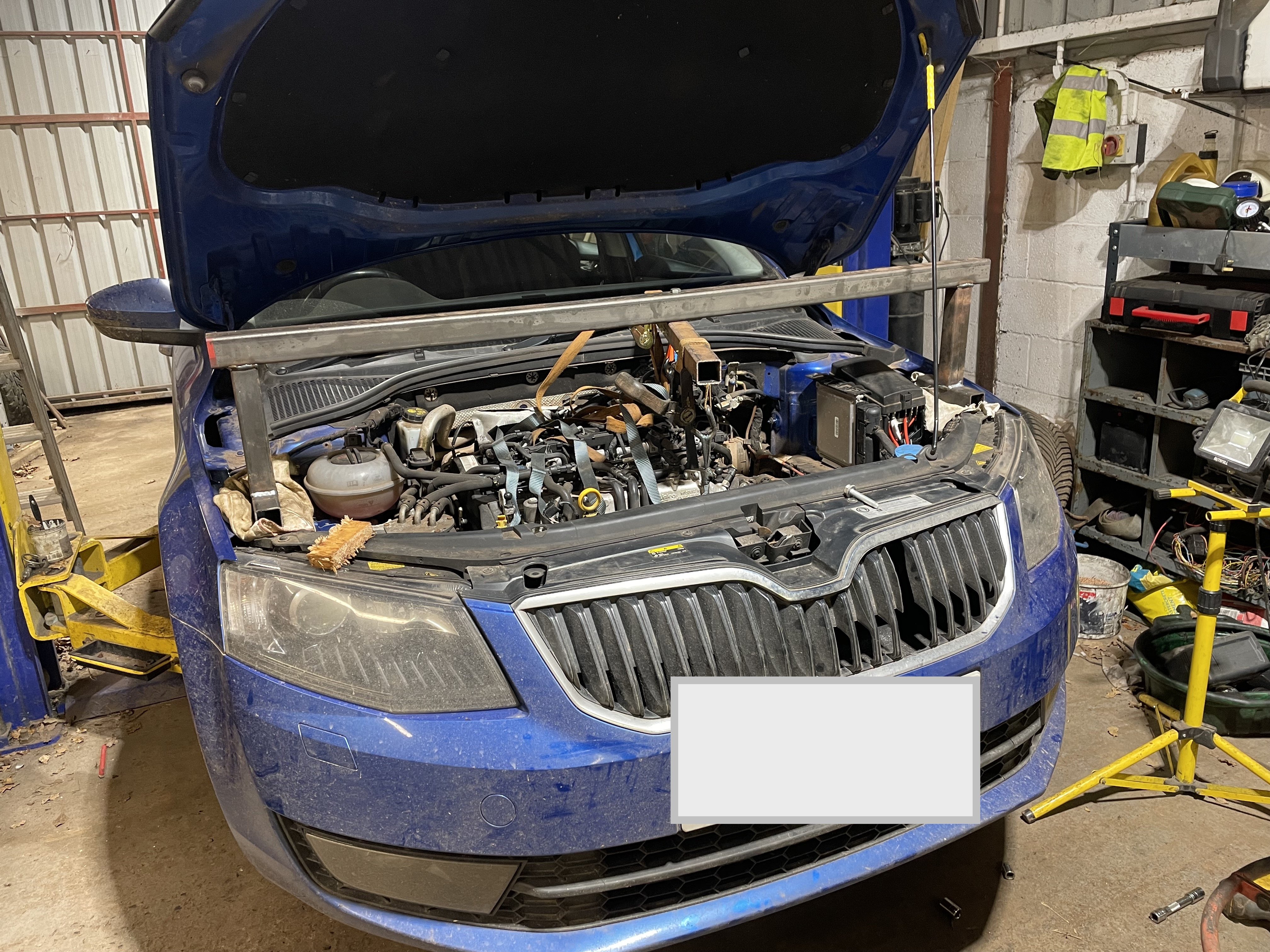

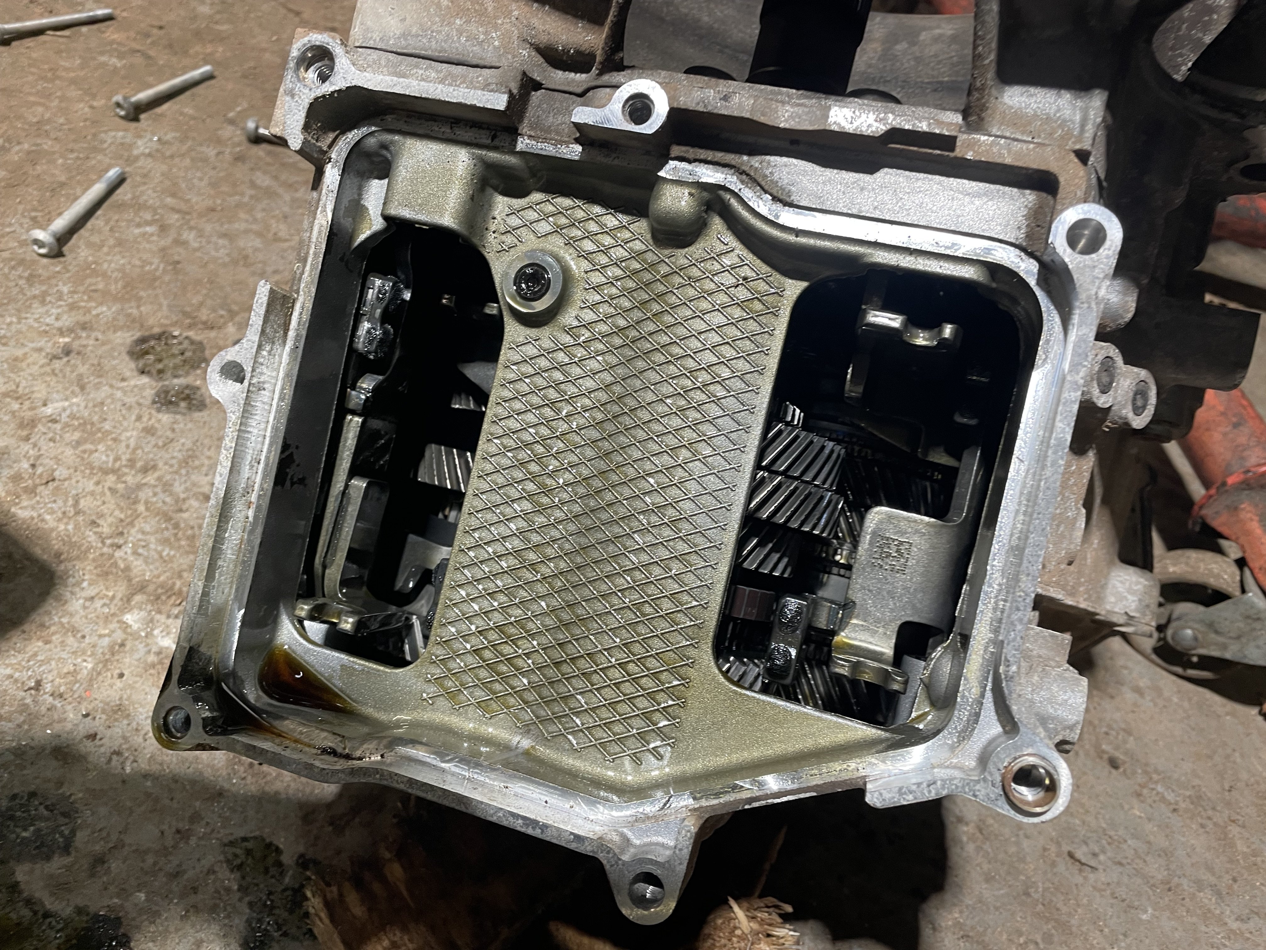

  4. thanks all done between Christmas and new year just had a proper (2000ish mi) test drive down France and back, all seems good still made the engine brace up myself and luckily had a 2post ramp I could use from a mate. While I was in there I took the mechatronic off the side of the gearbox in order to aid putting the oil back in easier (and to check the reverse and 6th fork bearing) and found that there's a handful of magnets (8 I think) which were totally blocked up with iron filings so obviously cleaned them out and new oil too. (which really doesn't seem like it should be sealed for life it definitely smelt like off gear oil when it came out

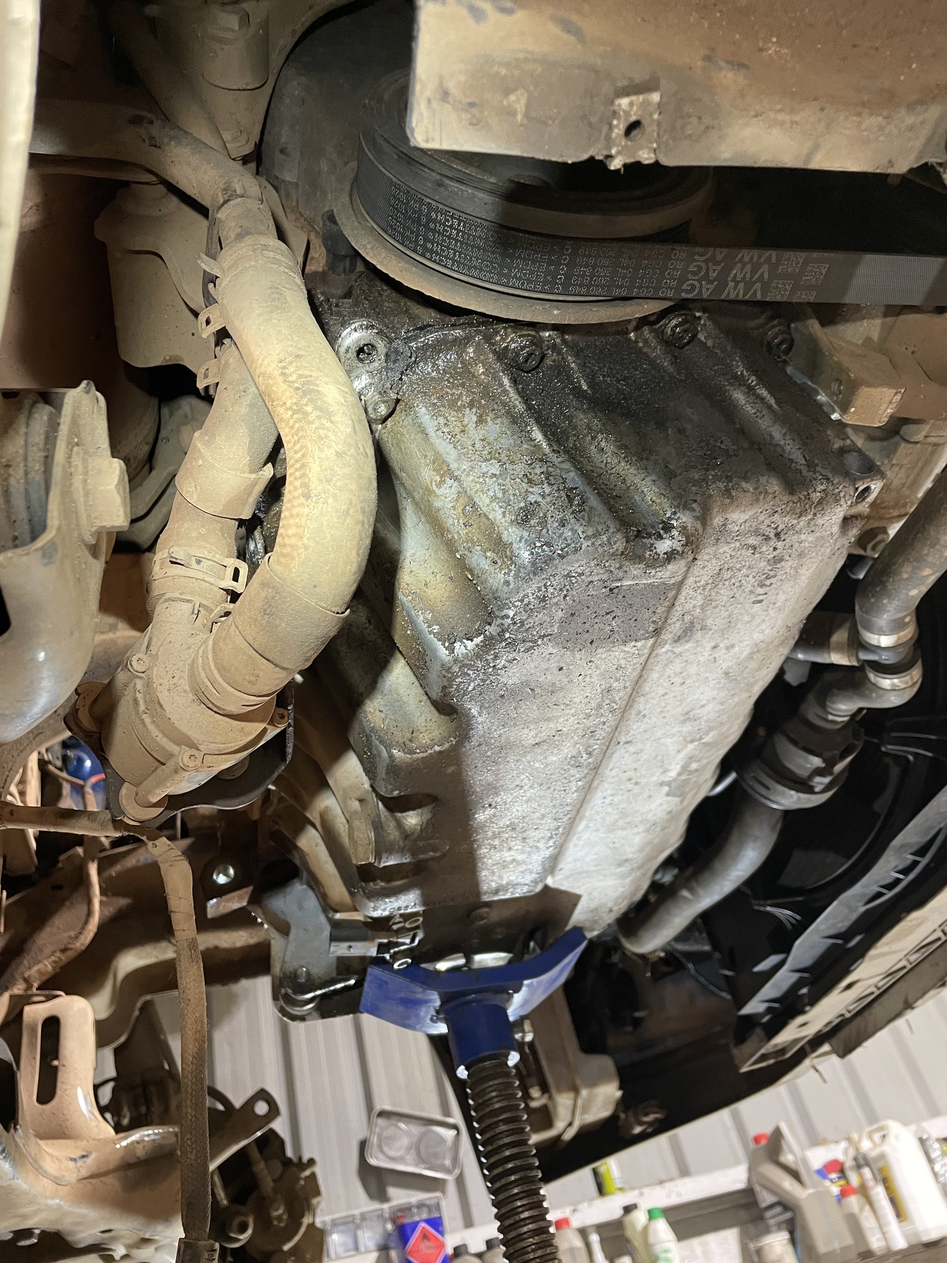

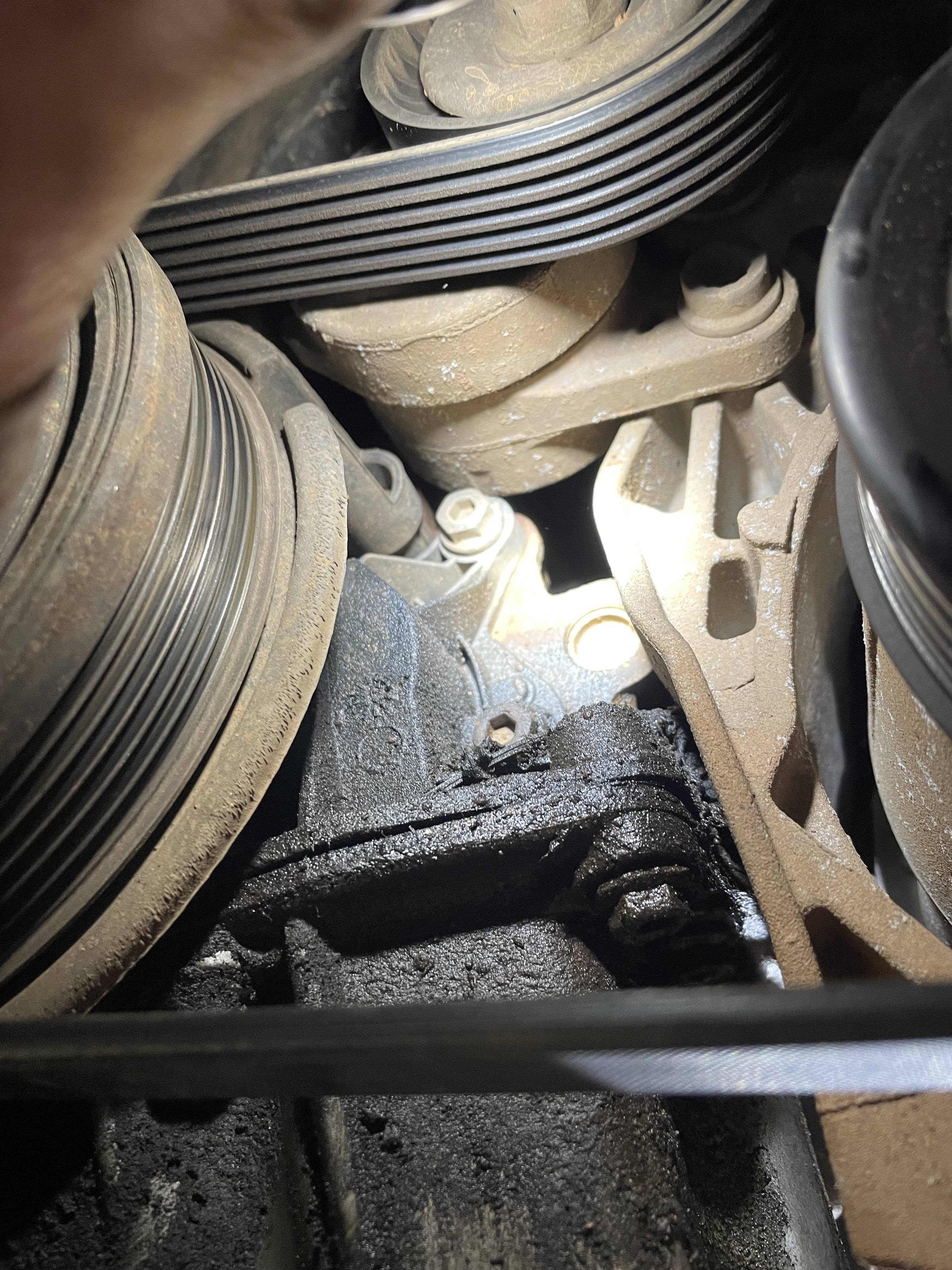

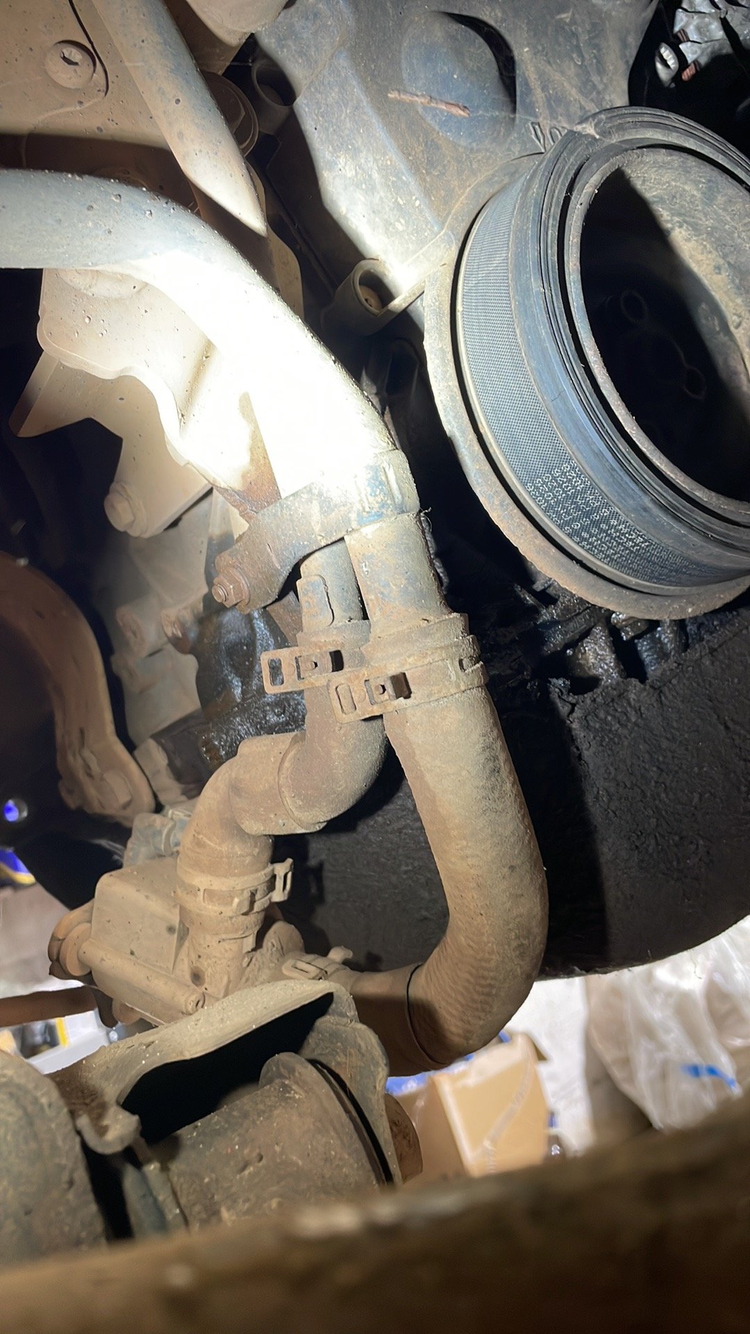

  6. Merry Christmas all - Any common causes for a slight oil weep drivers side back of engine on a CXXB engine (1.6TDI 2016 Octavia)? Going to give it a good clean up and hopefully that'll help me spot but its not a very good spot to see or access really
