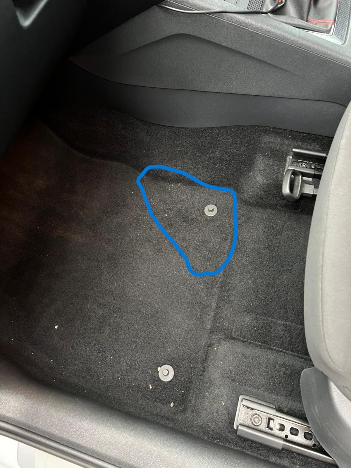

owca6666
  1. Im actually not sure it could be from the top now that i think about it, but i checked roof liner and didnt find any wet spots. ATM i have no way of checking if under carpet is wet. Not sure about the windscreen i bought the car used a year ago from a dealer. Im gonna have to have a look behind glove box on the weekend (mon-fri work 😞 ) Regarding the hose i think i will go to the car wash and monitor the footwell i got no access anywhere.
  2. I have tested sunroof again by pouring quite a lot of water into the drainage hole up top, nothing leaked into the cabin and water escaped near the wheel like it’s supposed to.
  3. I have red coolant in the car as i dried that area with white tissue paper i didnt see it being pink-ish i also smelled it, but couldnt detect anything that way.
  4. are there any schematics where i would look for it or should i go to garage?
  5. Hello, I seem to be getting a water leak somewhere in the passenger footwell up front, car is right hand drive. I have checked sunroof drain holes as well as under the windshield none of them are blocked As you can see in the picture only the marked area seems to be getting wet and im at my wits end with this. Did anyone encounter similar issue?
