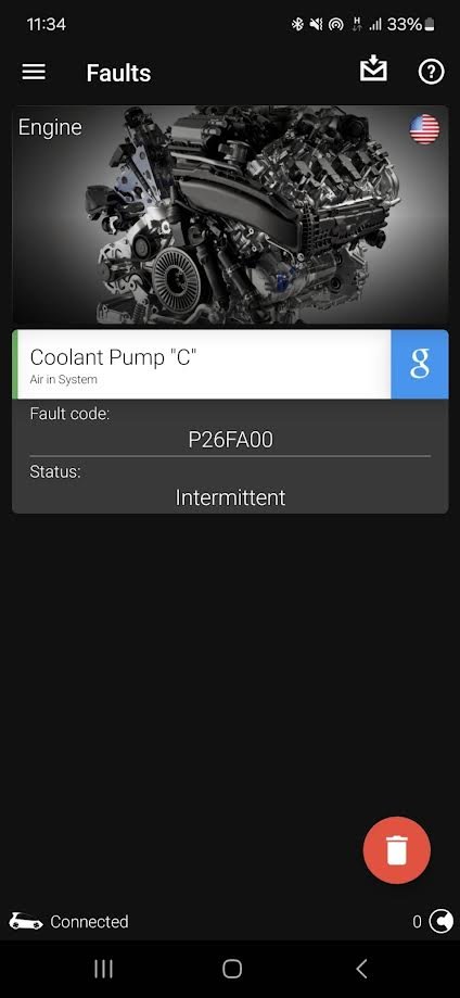

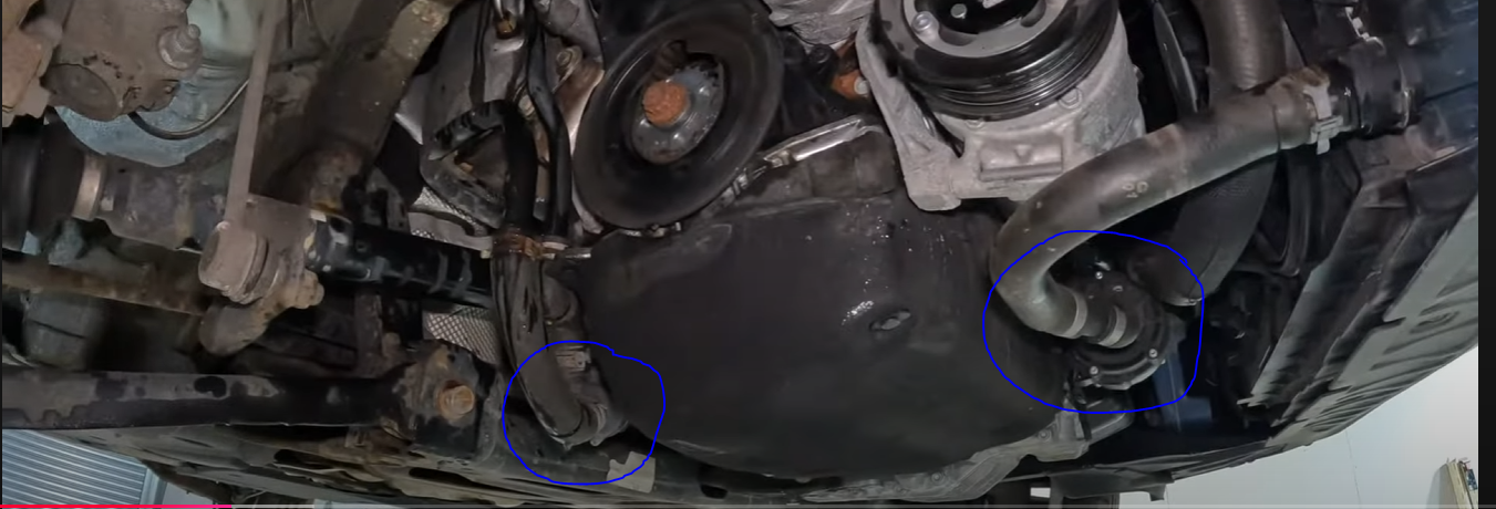

  2. Hello, i have skoda karoq 2.0 tdi 110kw / dffa engine I noticed that the temperature is rising to 110 degrees Only when you get up and press the accelerator pedal hard This means that if the road is straight and I press the accelerator pedal hard for a long time, it does not rise. Only if I encounter a slightly elevated road does the temperature rise. If you release pressure on the accelerator pedal, it gradually returns One day I was driving the car hard and when I got home the temperature was normal at 90. I turned the car off and started it 10 minutes later. I was surprised that the temperature was 120 and the car was off. I changed the water pump and timing belt , But the problem was not solved I purchased obdeleven and check, and I was surprised that there was a problem with the water pump C I did some research on the location of this pump, but I did not find a satisfactory answer. I learned that there are 2 additional water pumps. Can you help me? Is this the one in the front of the car near the oil filter or is it behind the engine? Is it reasonable that all these problems are from them? Sorry for the long post and thank you
