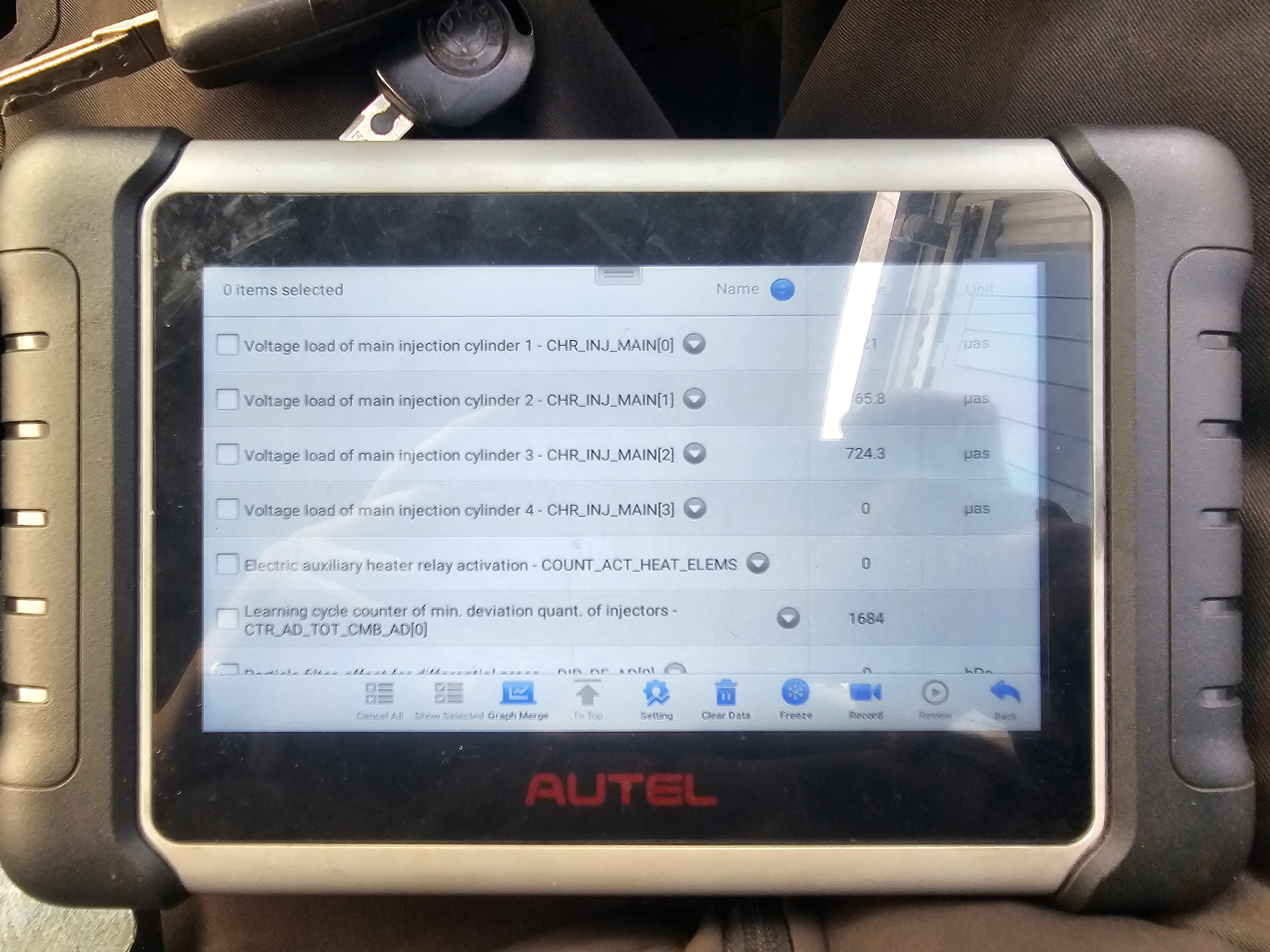

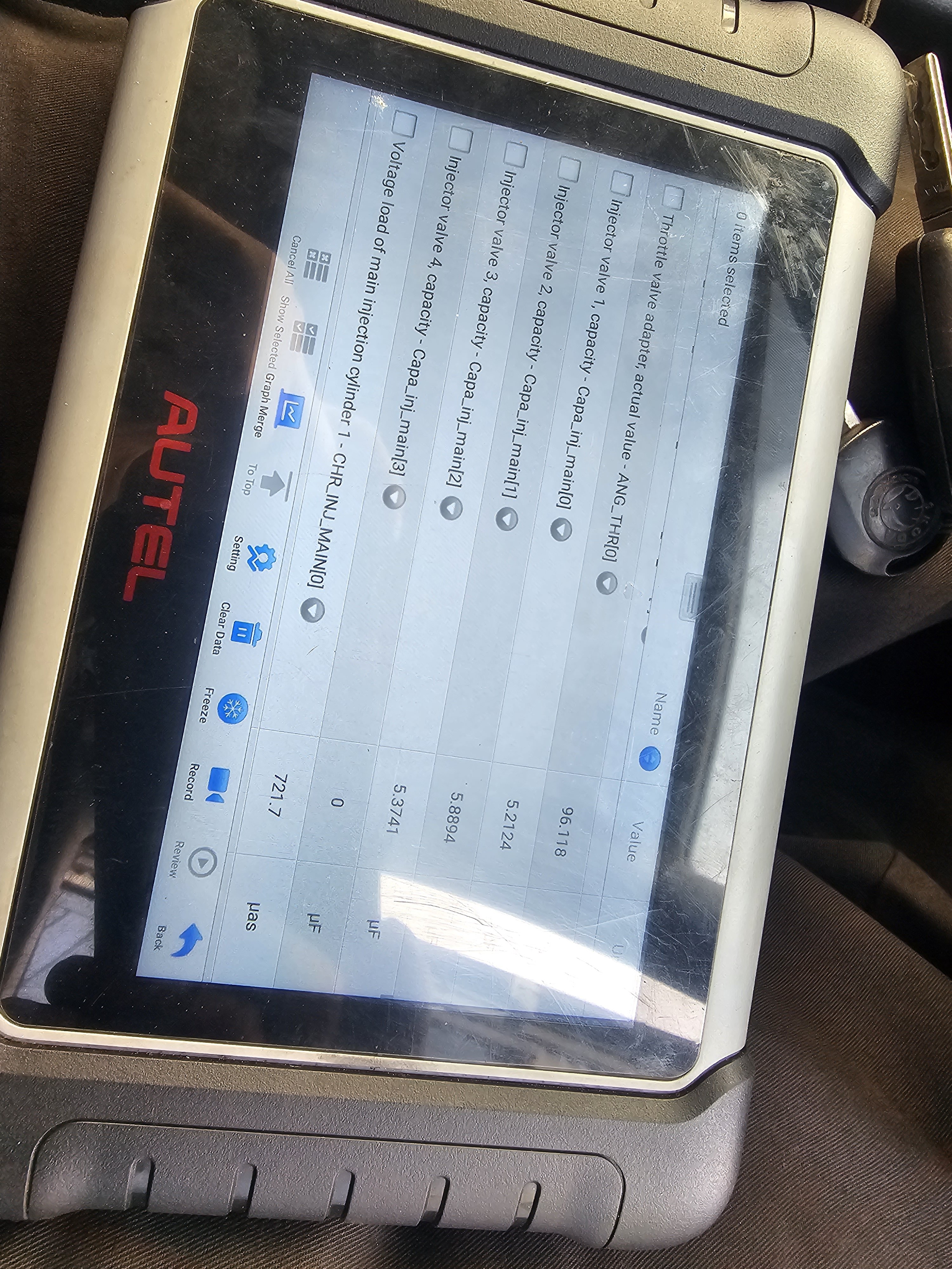

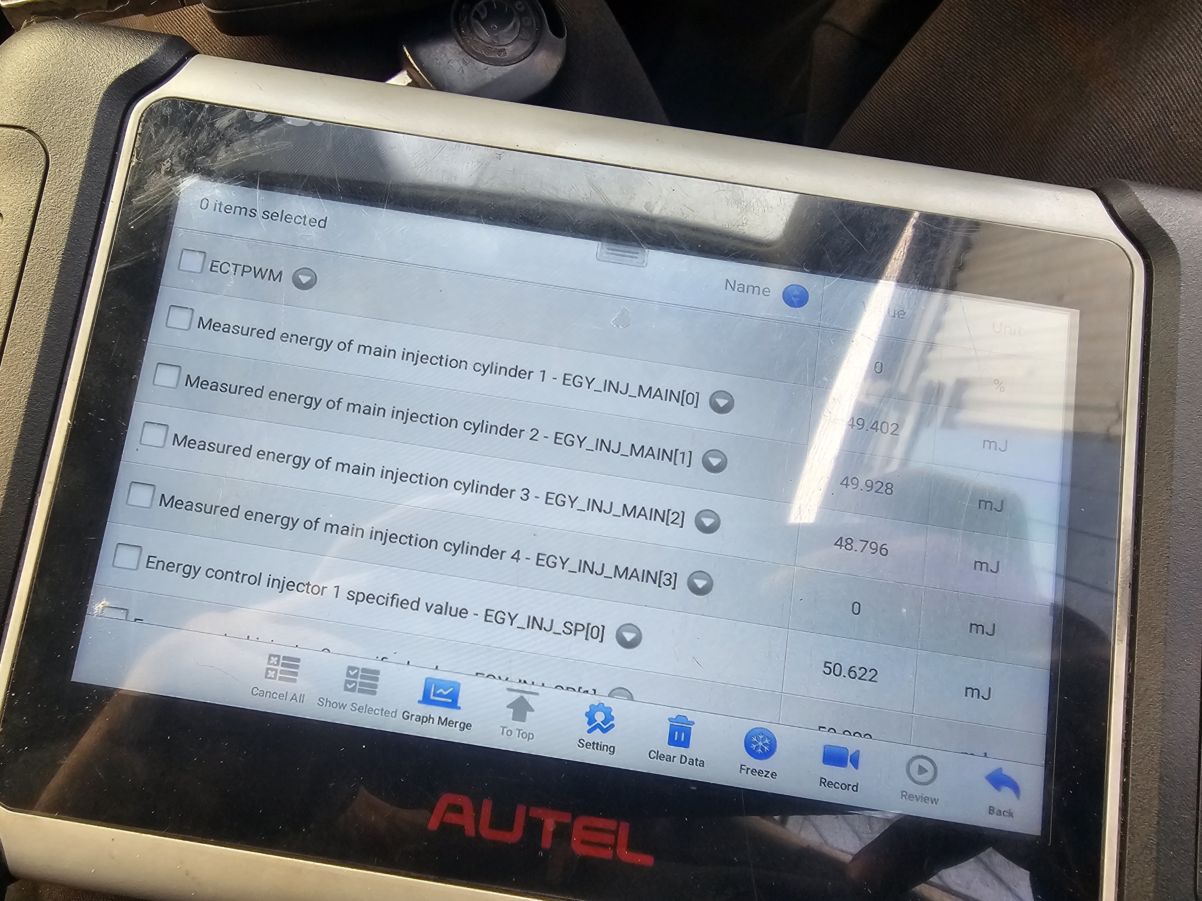

  1. Hi all I have a 2011 Skoda Octavia 1.6tdi (cayc) Car went into limp mode and had no power what so ever! Plugged in and no engine faults at all, was smoking so suspected injector. Went through live data and everything corresponding to injector 4 was on 0. Swapped the injector from 3 to 4 and it revved out and ran fine but assumed injector 4 still as the issue followed suit. Replaced the injector and was running fine for about 10 miles and back to square one... no values on injector 4. Sent the ECU off for testing to which they confirmed there was faults related to the problems I was having (bonus!) Just fitted a full ECU set and still have the same problem! Frustrating!! Had the injector plugs load tested and they said they are fine. See photos attached. Thanks in advance!
