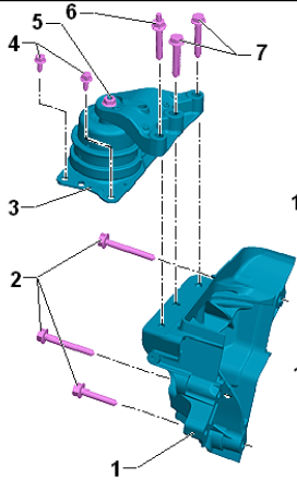

  2. Hi there, I'm planning to do timing belt on my rapid and the repair manual says the engine mount bolts needs to be replaced since they are TTY. I'm having a really hard time finding exact part numbers for those bolts. Is there anyone so kind that could check and get me part numbers for all the bolts on the attached picture that will match my car (Please send a message so I can send VIN to match 100%)? Thanks a lot for your help!!
