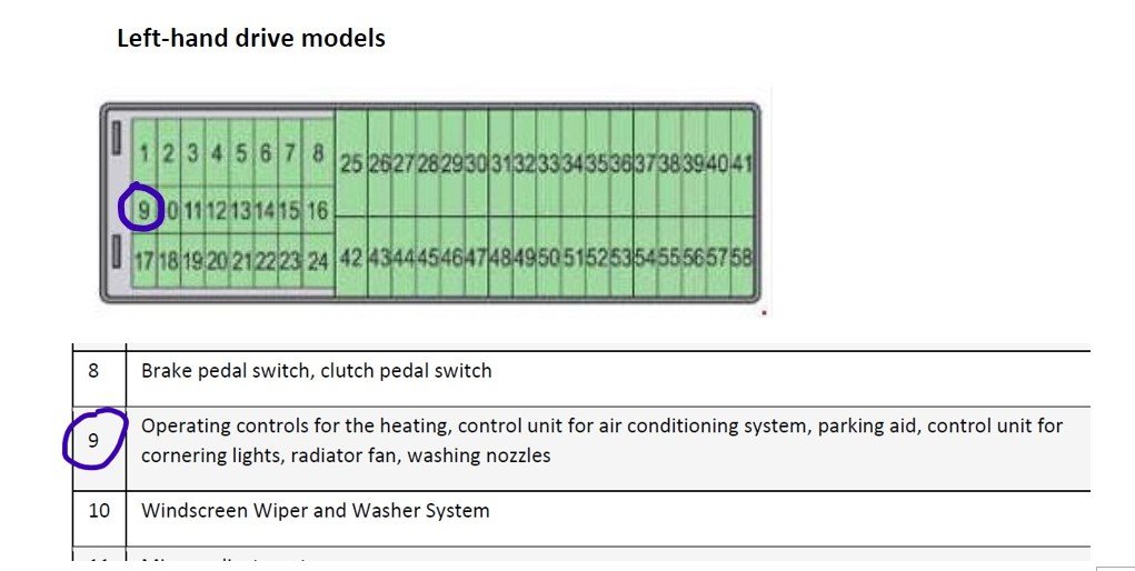

  2. Hello Pete, This was fast response, and confirms this fuse is powering steering angle sender. thank you for suggestion, i will check if it has heated washers (it is for Danish market so it is possible that it has). just wondering why in vehicle book they did not have same info, there it is written (in Danish, picture attached): 9 Operating controls for the heating, control unit for air conditioning system, parking aid, control unit for cornering lights, radiator fan, washing nozzles . Thanks again for fast reply and help, now i will work on locating connection points for affected consumers.

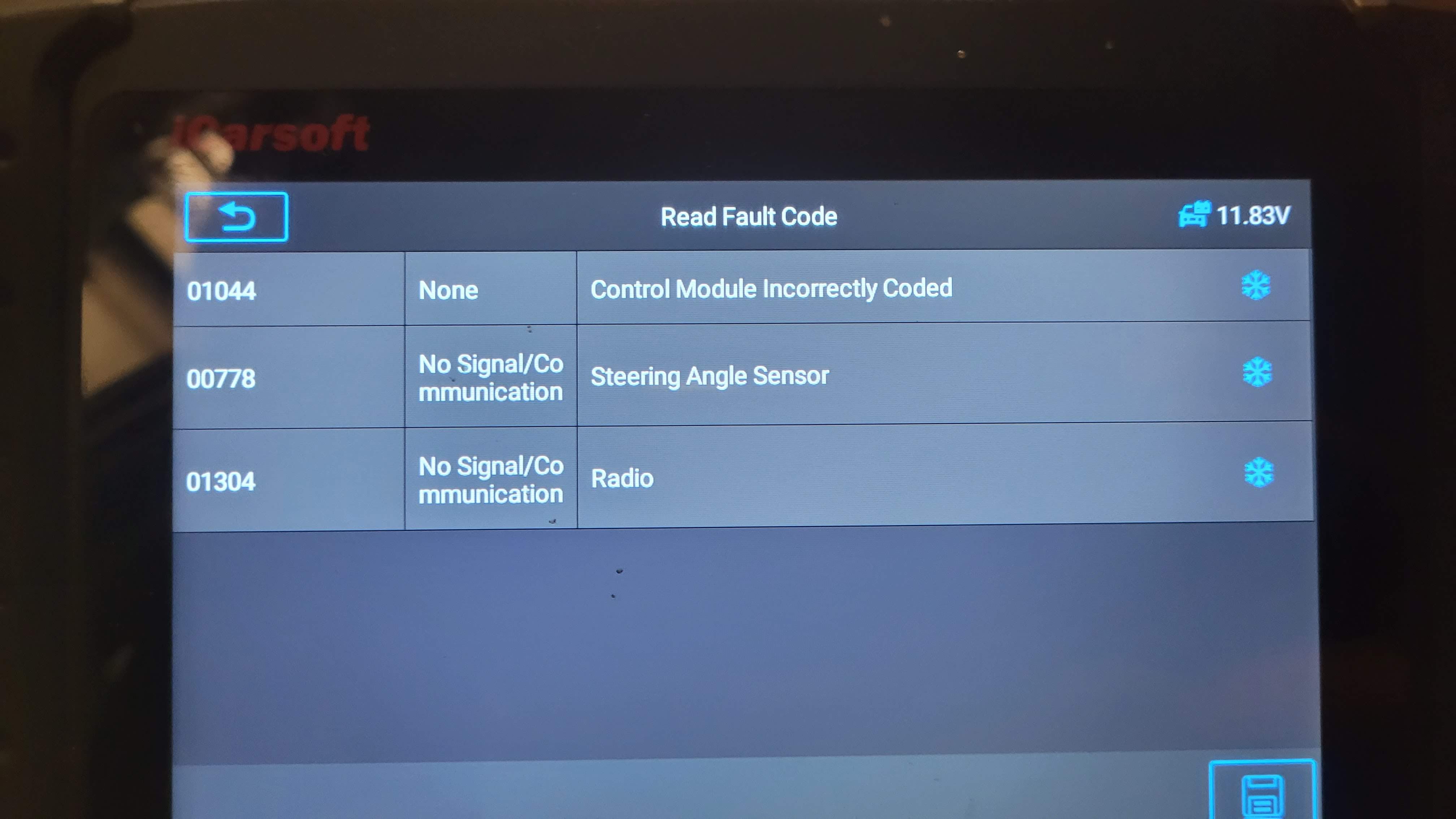

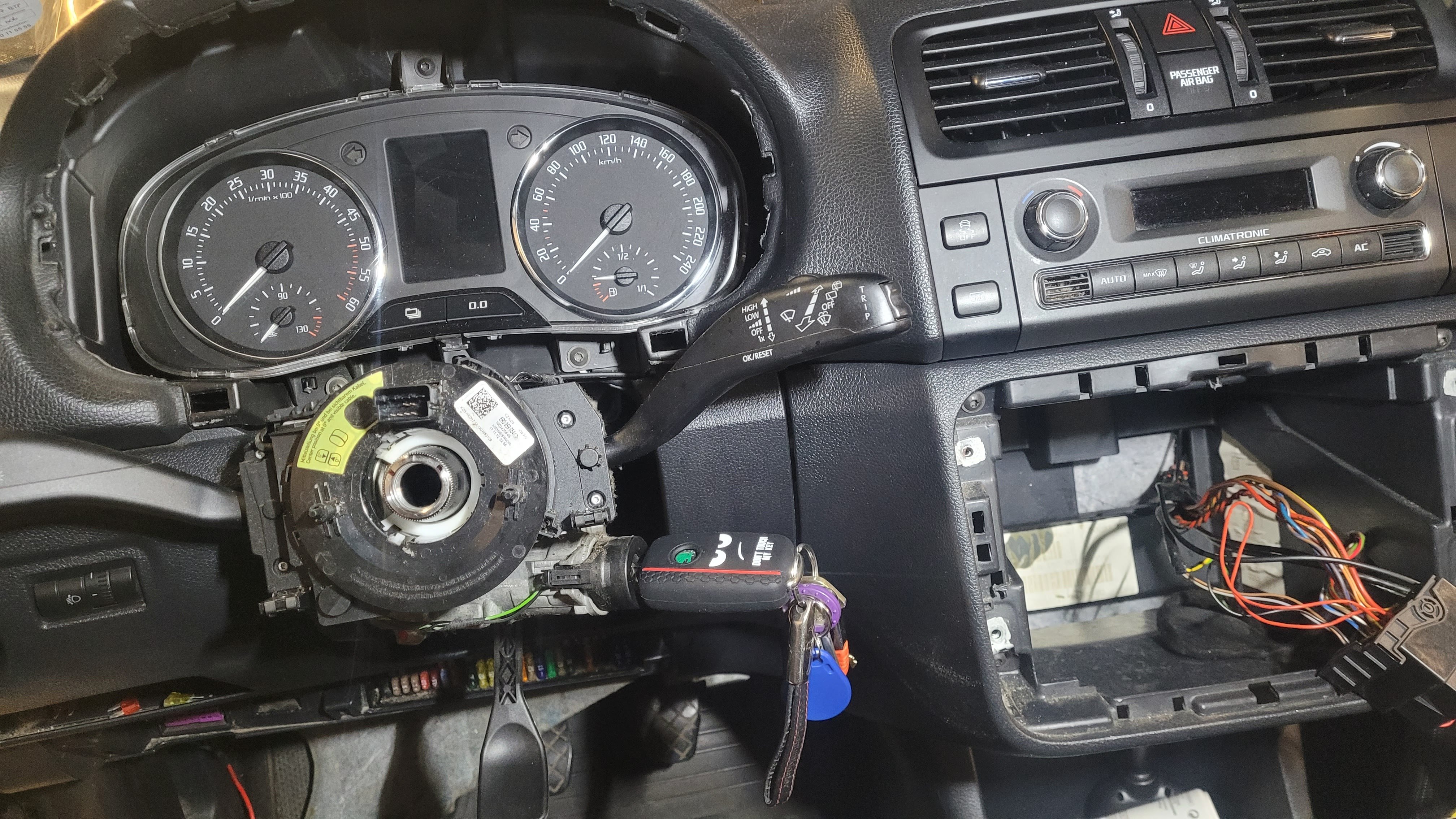

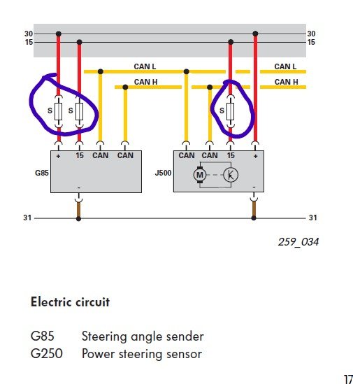

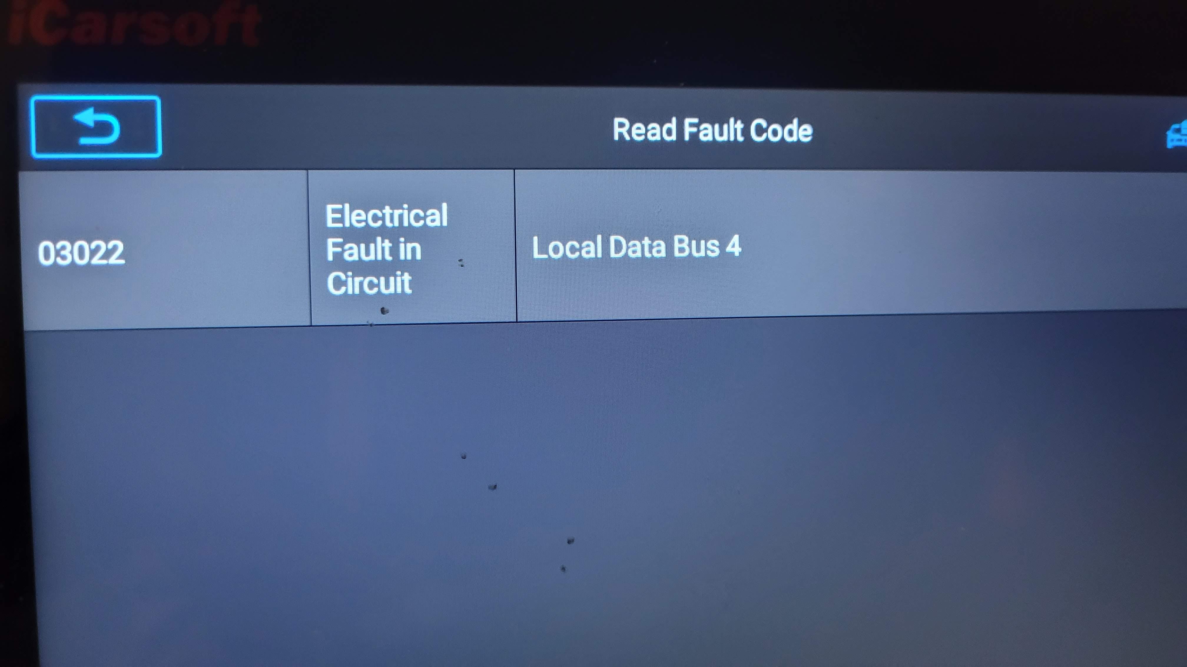

  3. Hello Everyone,I hope you can help me! I have a Skoda Fabia II 2012 1.2 TDI A few days ago, the car reported 3 errors at the same time while driving ESC Start stop servo light (plus a tire pressure light) The servo works fine, but if I turn the steering wheel a little faster, it seems to not have enough pressure (as expected in limited info mode) also ABS is working, but ASR and ESC are not. The diagnostics report errors (Icarsoft diagnostic tool) : 00778 no signal/communication - steering angle sensor 03022 Electrical fault in circuit - local data bus 4. I checked fuse number 22 and it is fine. I changed the steering wheel position sensor, exactly the same error. When I try to read anything related to the steering wheel angle, the diagnostics report a communication error. Is SSP i have found short schematic but i am not sure what are fuses marked by blue in the picture aslo found only one fuse number 9 blowing up as soon i put it it, but i think it is onot related to this issue (correct me if i am wrong, also marked in the picture) Does anyone have any ideas or advice? just note that i have put new Varta AGM 70Ah battery so battery is not the issue. Thanks in advance and sorry for longer post!
