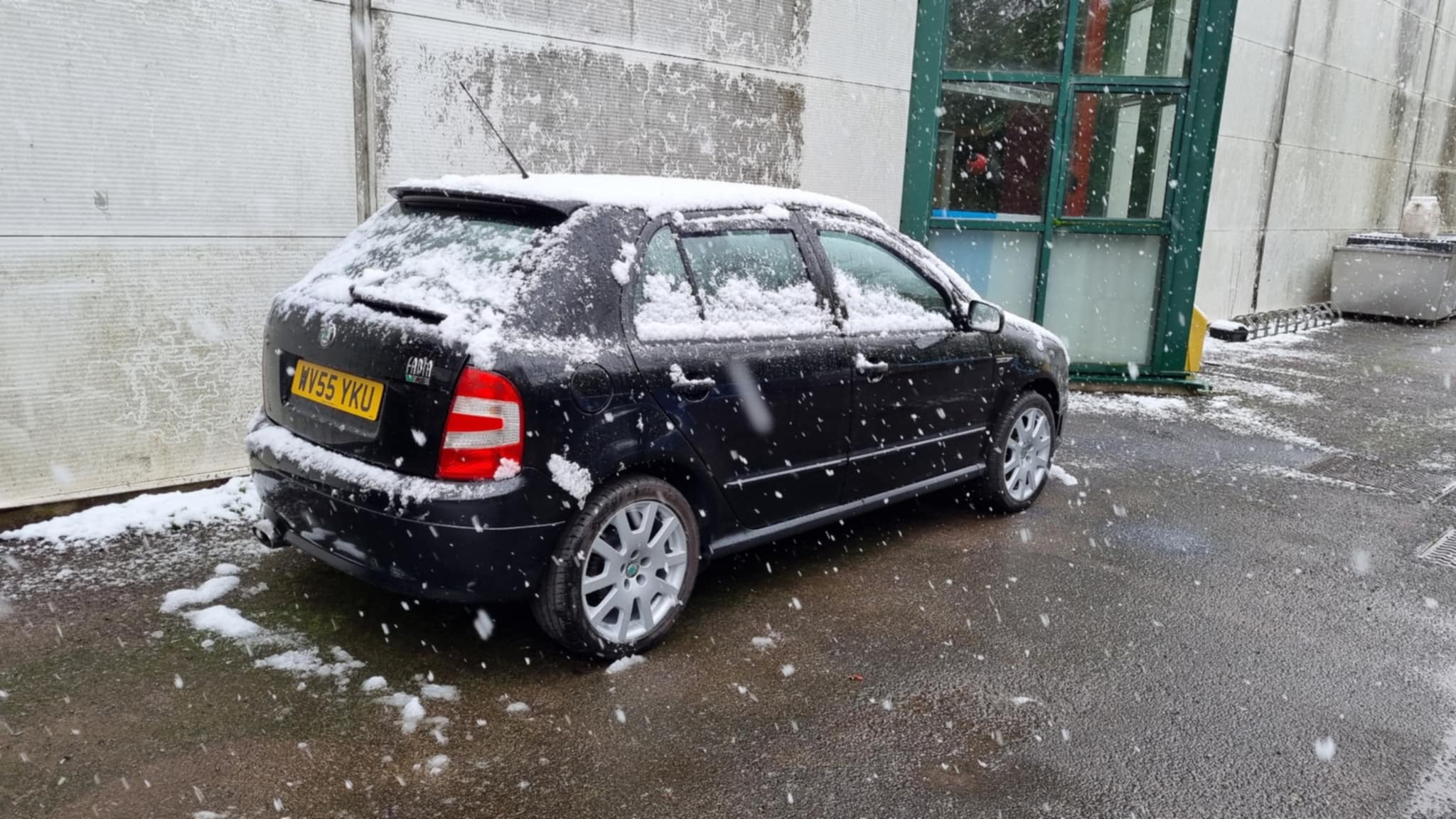

  2. Alright, I appreciate your advice my friend, and I will take that into account. Say “if” I do want to push it, what mods will I be looking at for numbers like that and reliability too? I get it’s gonna be spenny £££ but just so I know where I’m at. cheers
