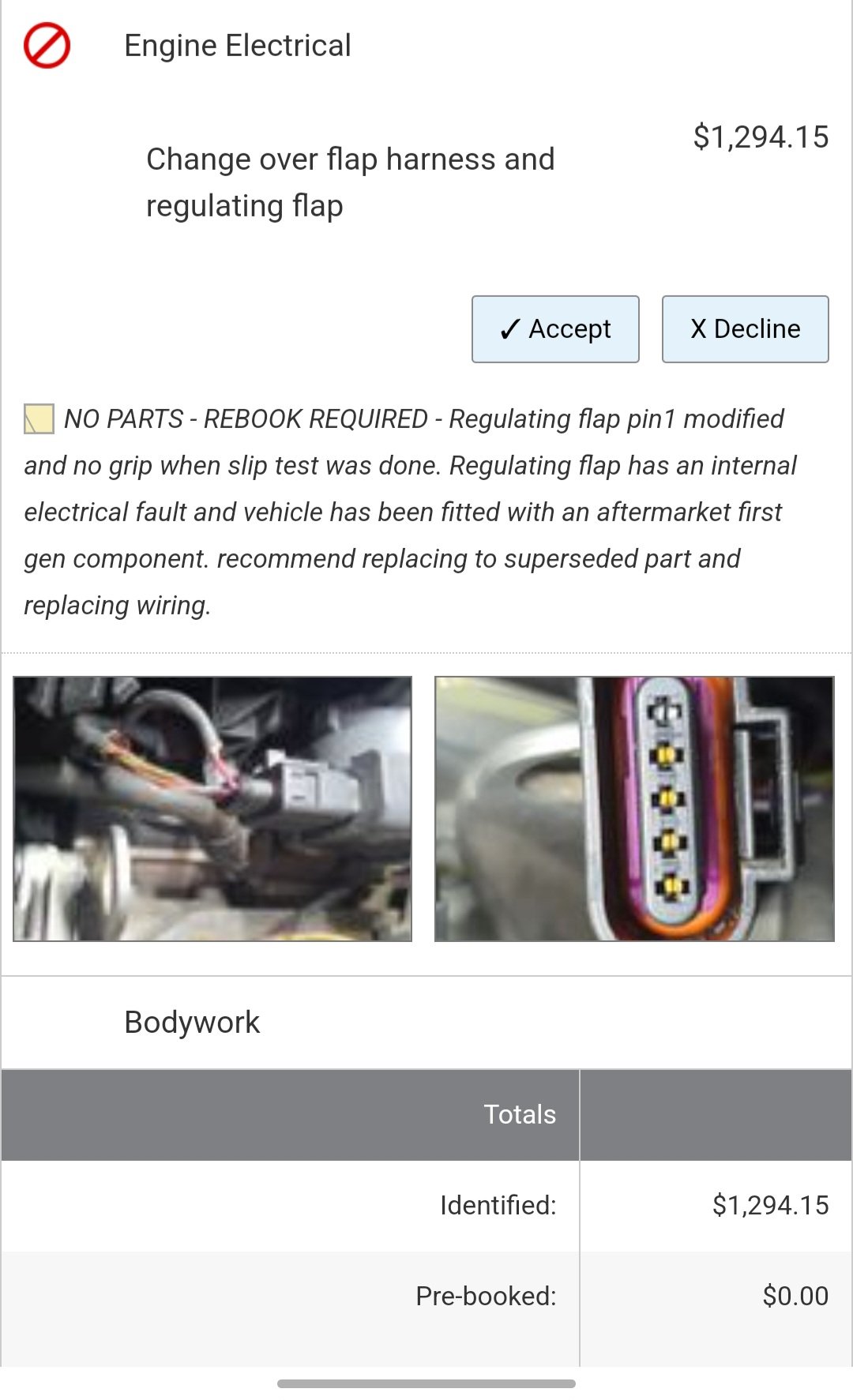

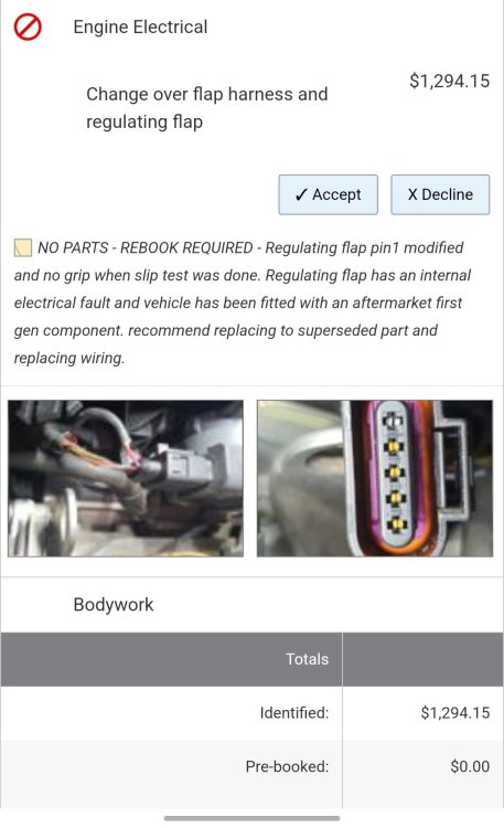

  1. So apparently there is some electrical issue. I'm attaching the suggested works... I'm a bit lost to be honest!
  2. I was just checking the report: https://triage-apac.superservice.com/home/en-au/customer-authorisation/#/qHroXz&Tr19Yv;QVU%3D&email Not sure if you can see it. It does not mention road testing or anything beyond a transmission check.
  3. It had not been recalled, so perhaps my model sits in the gap between both recalls. Nothing appeared on the console when the issue occurred. I'm taking it back tomorrow to Skoda but I'm sure they are going to send me home and pre book.
  4. FFS I've owned the car just over a month. The transmission was checked yesterday with no issues :(. I can select all the gears using the shifts or the gear stick. So upset about this.
