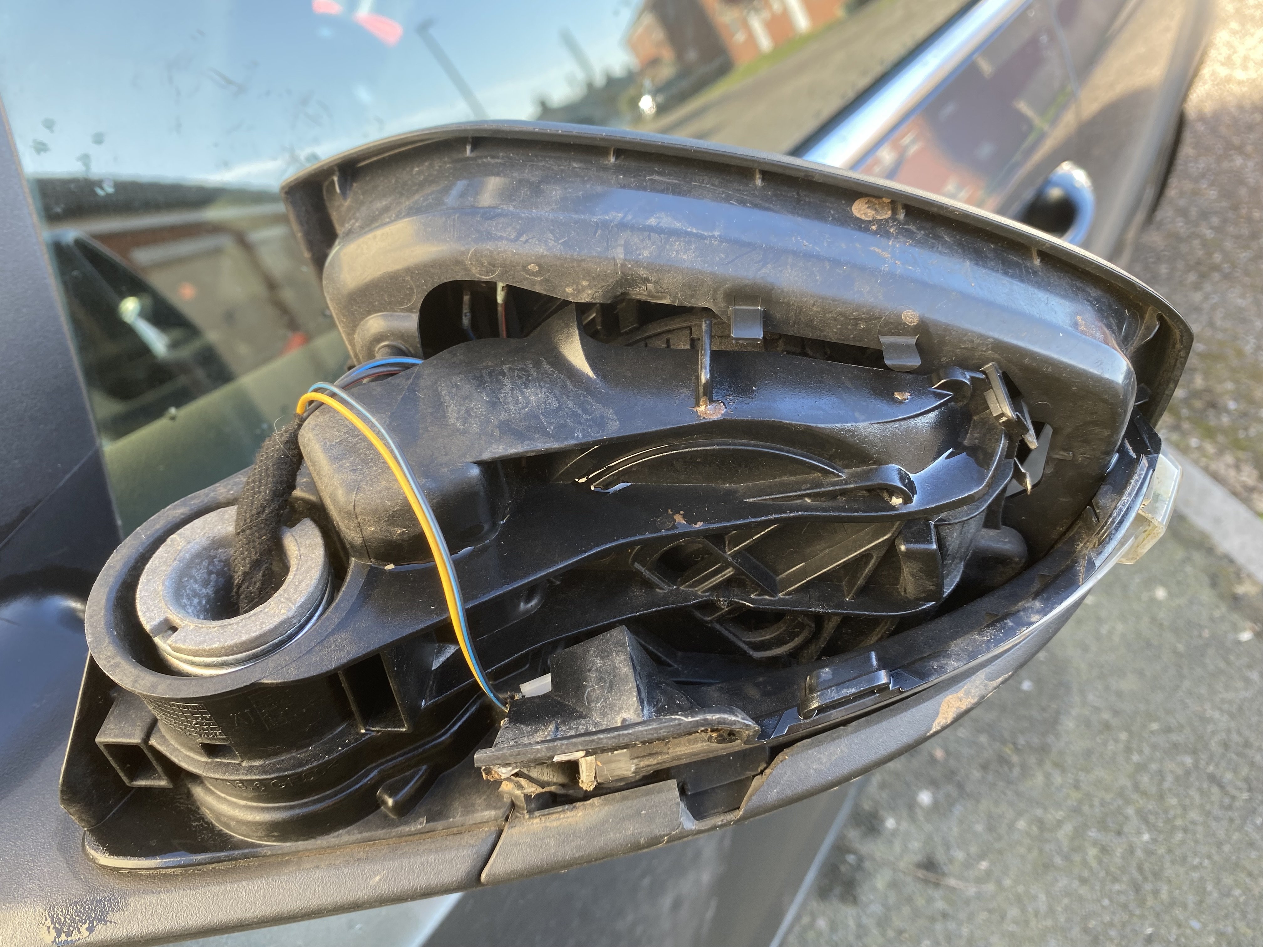

Just to complete the story, I ended up purchasing a replacement wing mirror from Ebay for £60 and a very kind friend helped me take off the door card and replace the broken one. Seemed like a simpler option than taking the 2 wing mirrors apart and swapping out pieces. So a happy ending. Thanks for all the advice.

Thank you. Yes I think I you are right and that would explain it. I hadn’t ordered any other parts and was hoping just to replace the cover. The light on the wing mirror and electrics to move it all work perfectly still. I may well need to use some sort of glue to keep the costs down as don’t want to have to replace the whole wing mirror. Btw apologies for delay in replying - the site was not loading for me all day

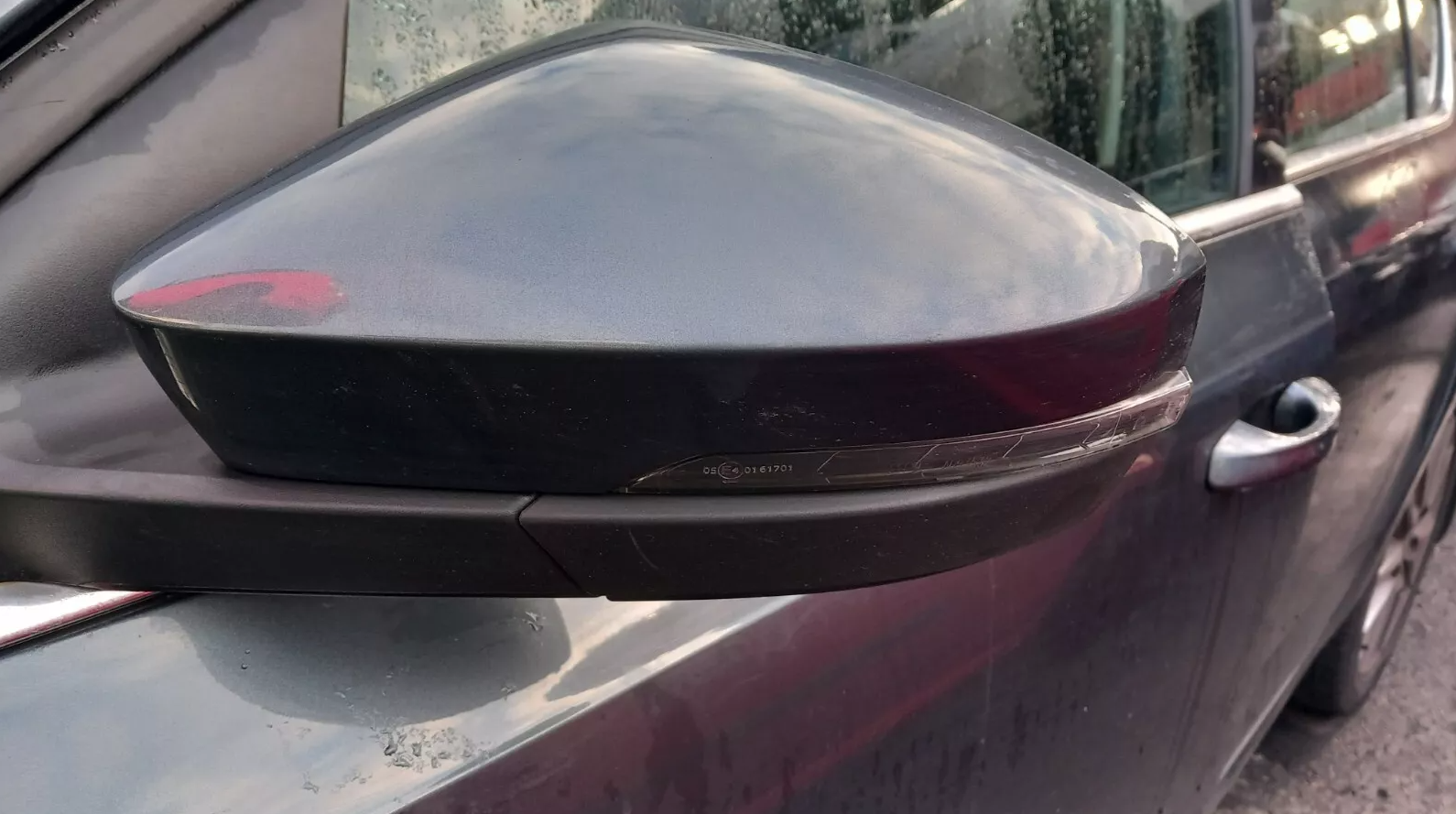

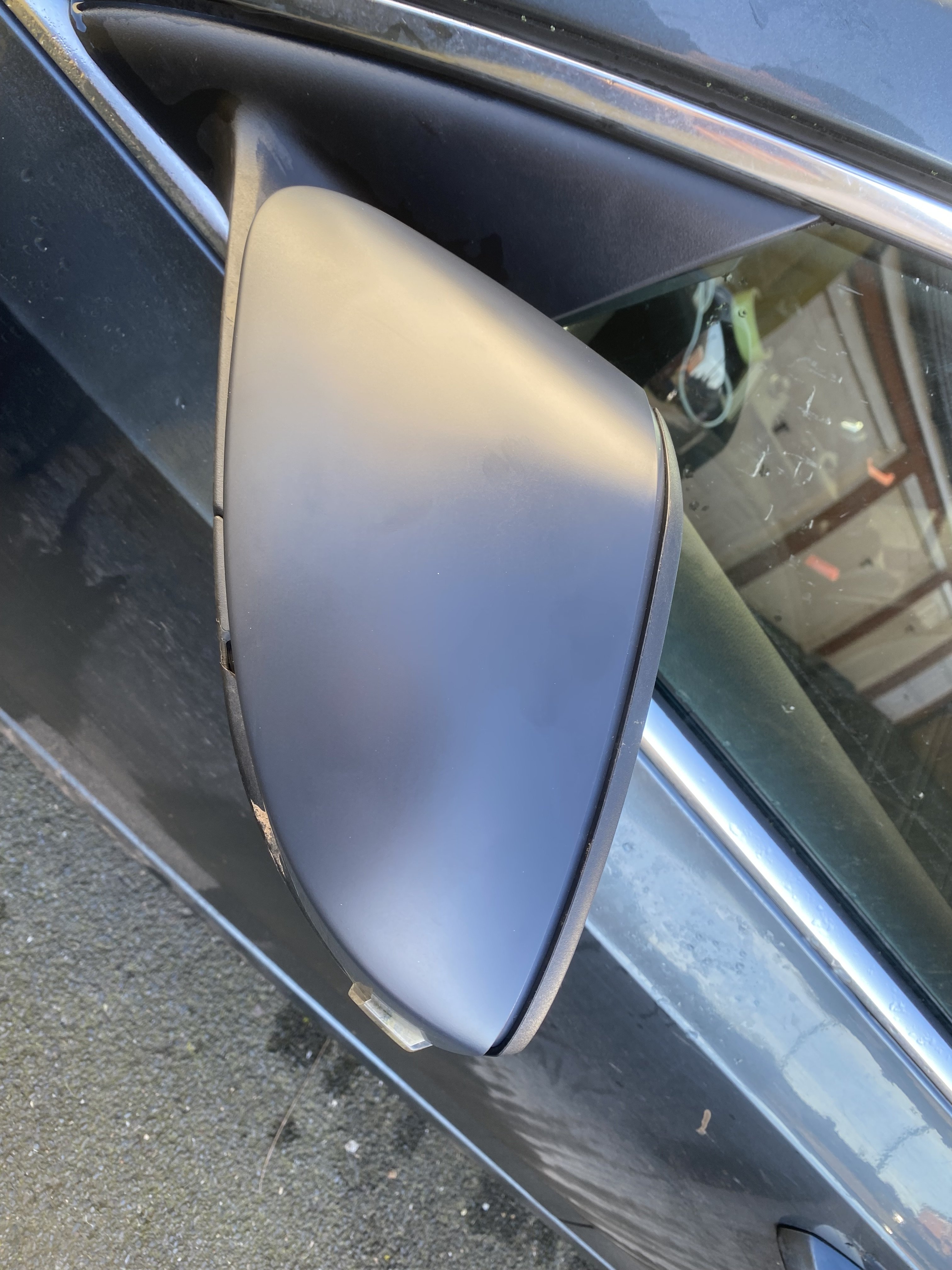

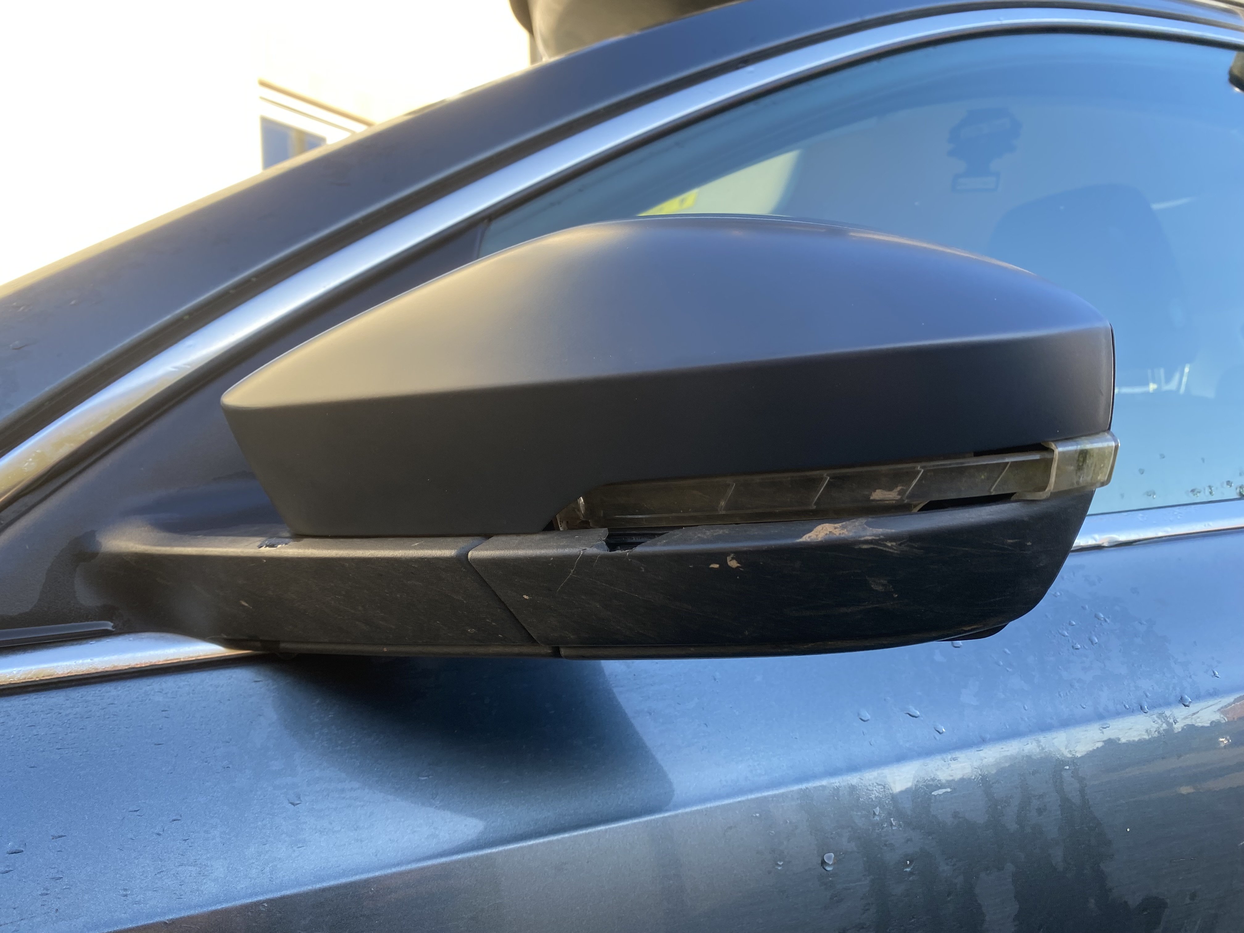

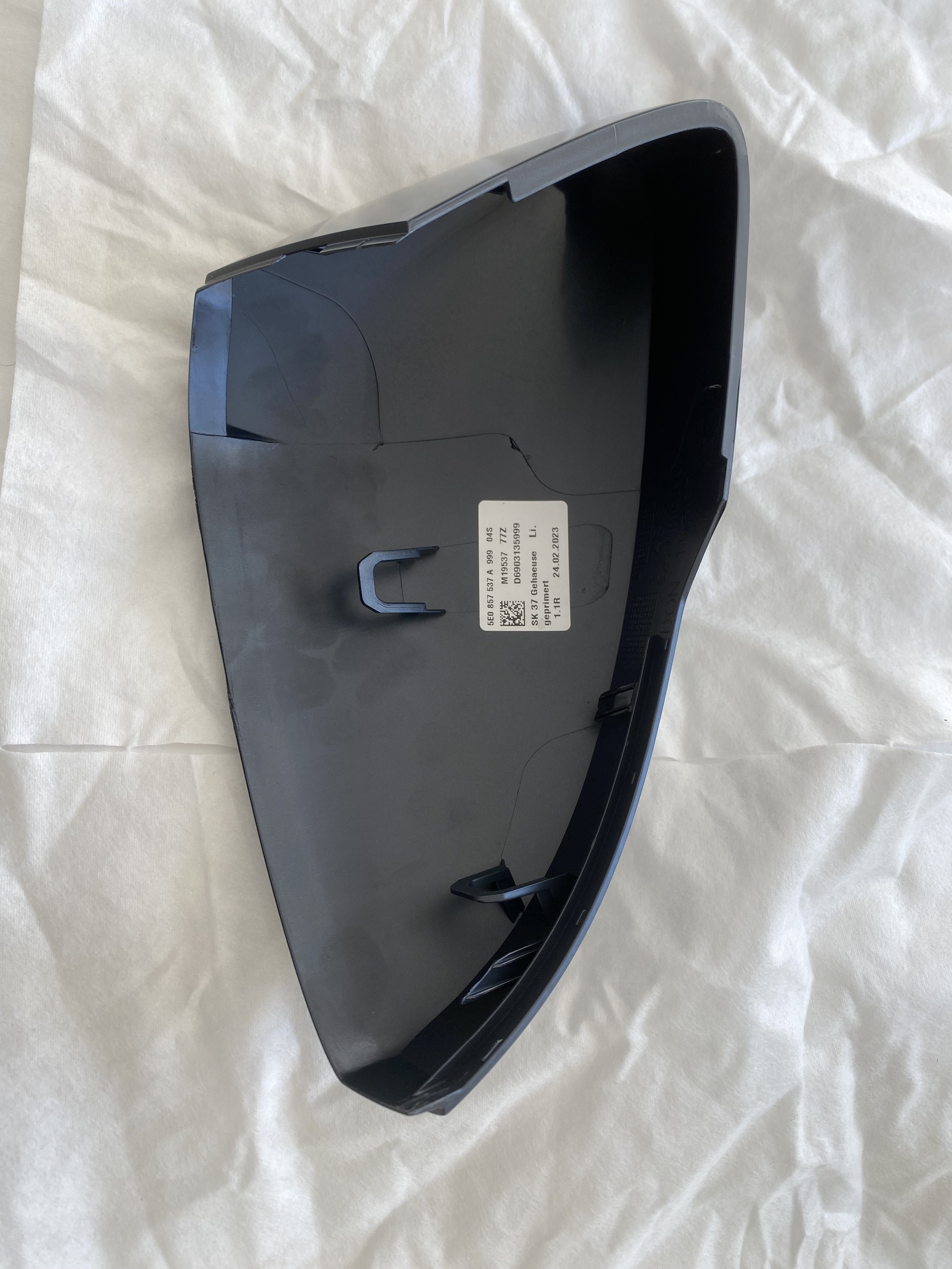

After an incident with a wheelie bin, my other half returned the car with a missing passenger side wing mirror cover. I purchased a replacement Skoda part from a part supplier who checked my car details and confirmed it was the correct part. Watched a YouTube video and it looked like it was simply a case of clipping it in. It looks like a perfect fit but when I push it into position it doesn't feel like anything clicks into place though it does apppear perfectly aligned. However I can easily pull it off again with my hands and not a lot of force. I have attached some photos. There is definitely a little bit of damage to the wing mirror itself which possibly could explain why it is not clipping into position. Any ideas? The part I purchased was Genuine Skoda Octavia 2013-21 wing mirror cover cap primed (left) 5E0857537A GRU Perhaps I can use some sort of tape or sealant to keep it in place otherwise the first pot hole I meet it may fall off. Thanks in advance Paul
