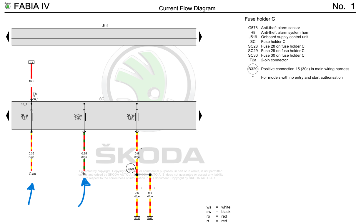

  2. Thank you all for your replies. So, to sum up, my version doesn't have the anti-theft system (I also verified it by doing some tests as you suggested). It's not a big problem, but I'm just puzzled because the diagrams showed the system as non-optional.

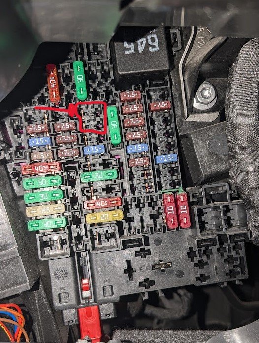

  4. Sold in Italy, left-hand drive.
  5. Good point. I didn't notice it from the picture. Thanks for you offer! I am sending you a private massage.
