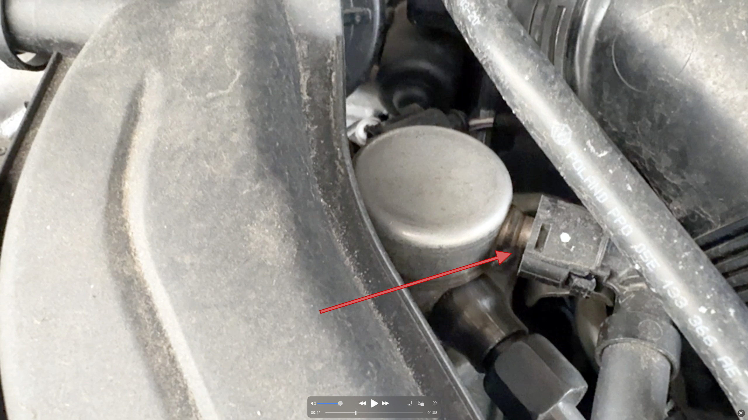

  4. After a couple of warm days in the UK I noticed my air con makes no difference, not great for the German Shepherd. I'd like to top it up with R-1234yf but after researching I'm getting mixed opinions. It looks pretty straight forwards and there's a decent saving doing it ones self. Has anyone got any advice? I've got a - KAROQ SE L TSI DSG / Year of manufacture 2020 / Gearbox 7 speed SEMI AUTO Cheers Will

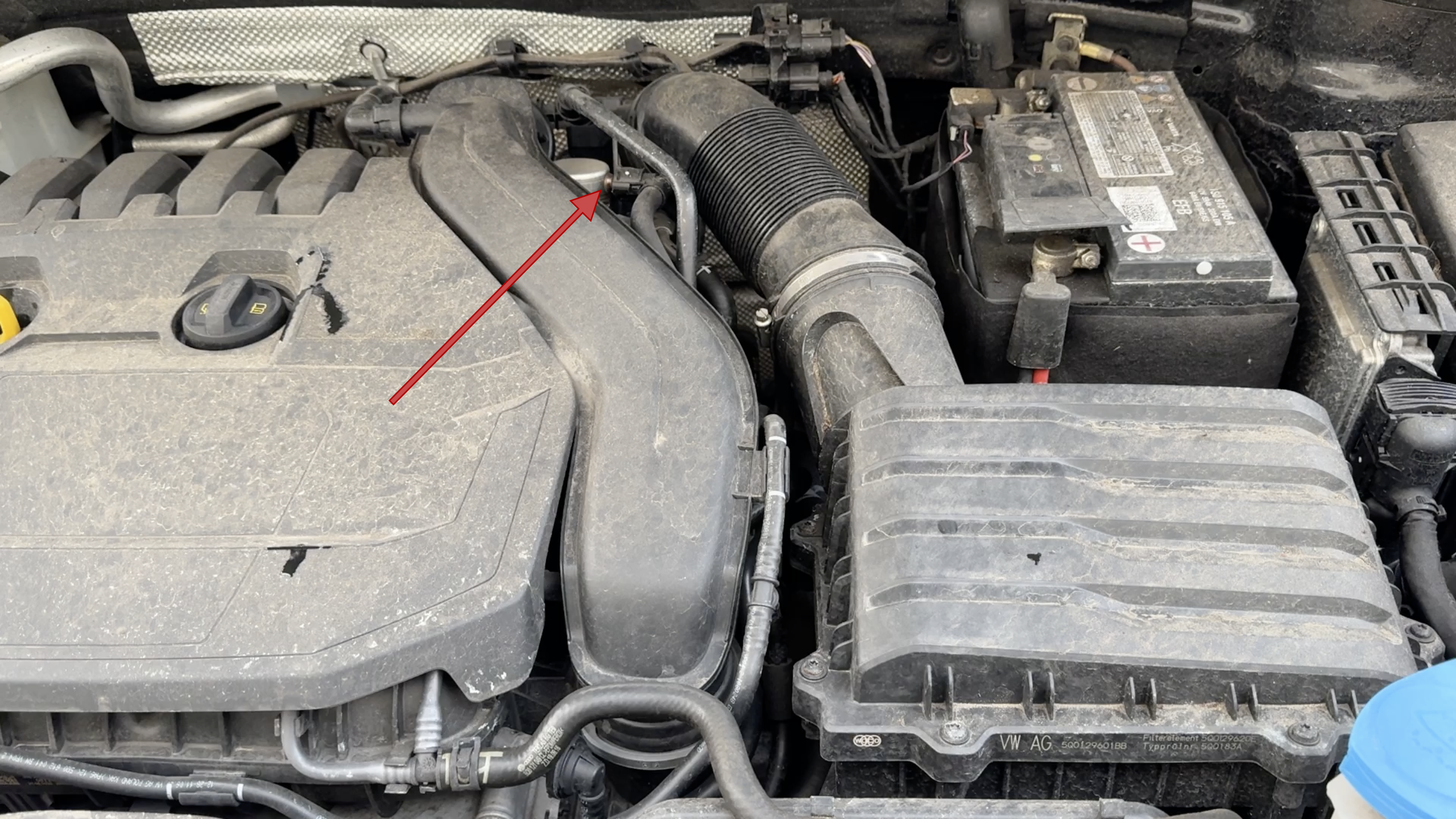

  6. Bingo! Thanks MrAdamwood, you are a star!!! I inspected the tube and while the ribbed tube looks ok the join has a hairline split. I'm uploading a few pics to identify the part and also help anyone with similar issues. I won't know if this was the issue but will definitely report back when I've fixed this. Any ideas on what the part is called? I'm not sure if I should replace the whole tube (marked with a red line) or if I should just replace the plastic join tube. I feel like replacing the whole tube would be best.
  7. Apparently the tube is fine. I've found several videos where it looks exactly the same, it feels secure but looks sus... Thanks for the link @Tetley, the dip stics and oil cap are clean and fitting securely. Any other ideas welcome..!

  9. Hi good people of BRISkoda. I've got an EPC error with my Karoq. It's a 6 week wait to get a booking at the local garage so I thought I'd have a crack at fixing it myself. Unfortunately it turns out I'm a total novice and need to ask for help. I used a basic diagnostic tool which shows it as a P2279 error, when it's cleared it returns fairly quickly. I've done a rubber glove test and it's got a strong vacuum. The oil levels seem fine with no noticeable increased consumption. Here are the model detail. Model KAROQ SE L TSI DSG / Year of manufacture 2020 / Gearbox 7 speed SEMI AUTO I've inspected the engine and couldn't seen anything that looked out of place or producing a noticeable hissy sound. Attached are a couple of images showing a tube that looked a little loose but I wan't sure if it was supposed to be like that. What do you think? Any advice on diagnosing this would be massively appreciated. Thanks loads! Will
