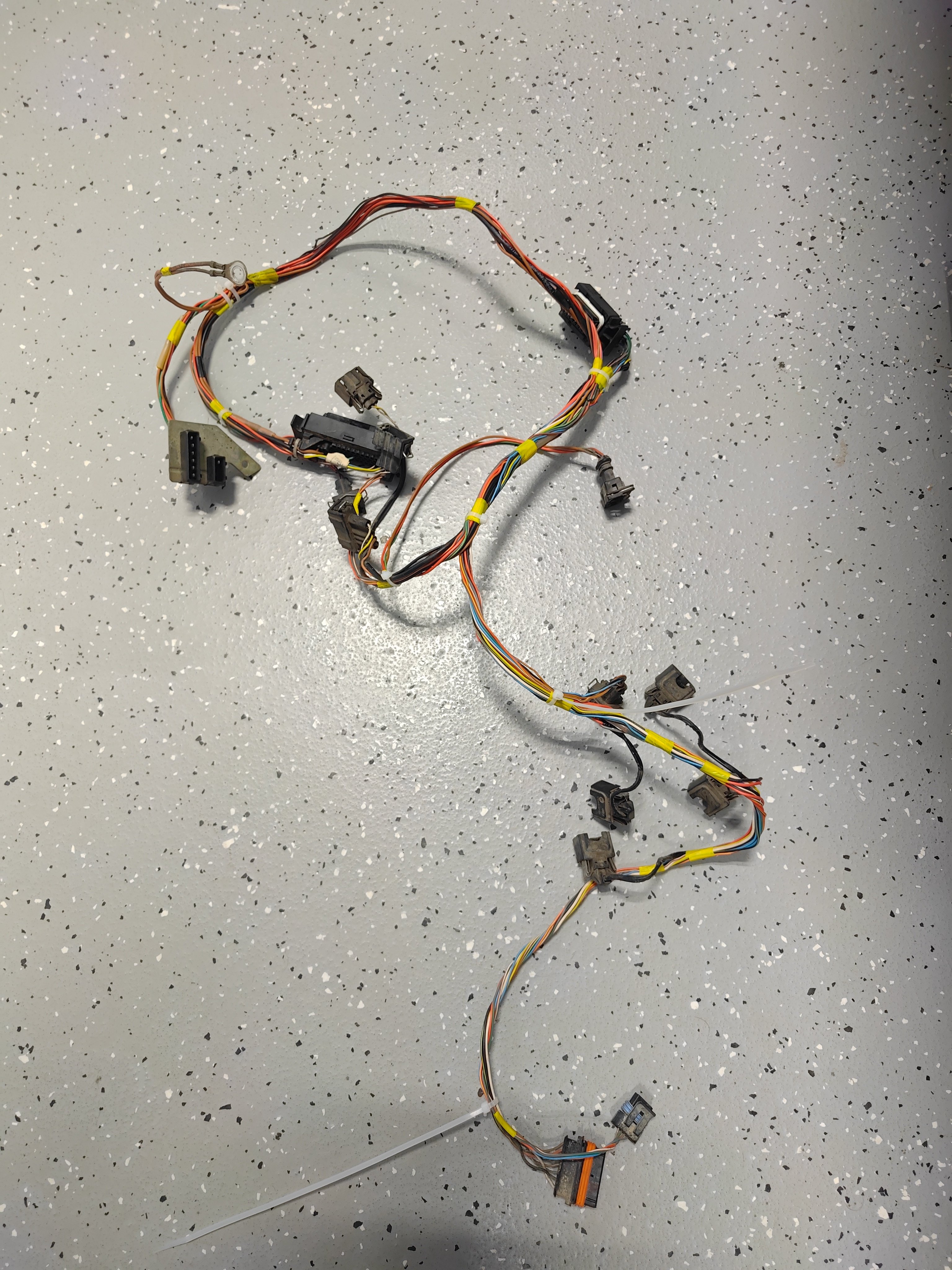

  1. Yes, the wiring insulation is hard and cracked on few spots, that's why I want to change the wires. After a good scrub I found out that the connectors are in pretty good shape, but the wires are not. Already found the pins for wiring harness, but can't find the MAP and TPS pins, they are different from other one. As you can see in the picture, they are like a square. My electric friend says it's a Bosch bdk pin, but they don't look the same, a little bit different. Will order few and try if it fits MAP and TPS sensor. Will post the update.

  5. Hi guys, I am looking for a full set of connectors for Felicia 1.3MPI Simos 2P. Where can I source all the connectors, but they need to be new, not the used ones and pins for connectors. Here is the picture of what am I dealing with. Greetings

  7. Update: I took the electric wiring out from the car, found few aftermarket connections. One of them is the supposed K line, but didn't have time to check the conductivity for that wire. Will do it by the end of the week and try again. I don't need any fancy gauges from the diagnostic, I just want to read/delete the faulty codes. Because I had a problem with engine power cutting, but found the wiring from hall sensor was burned (probably had contact with the exhaust manifold) because the engine is not in the Felicia, but in Škoda 105L. Will try to connect the wiring to the engine by the end of the week and will give you update. Thank you very much everyone
  8. Yes, that's correct. I took the wiring out from the car to check for wire conductivity and if it's everything plugged like it's supposed to
  9. Tried it several times, every time it says failed to connect. I took the installation/wires out to check it for the right wiring or any breaks.
