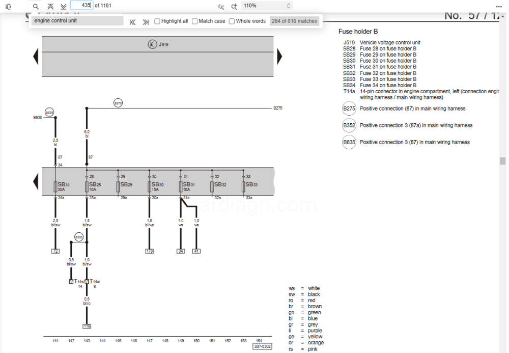

  4. I think you're right. I've just gone out, put the fuse #30 back in and it's fired up and runs fine. Testing like I did with just the ignition on, therefore no crank signal, meant the ecu opened the relay to stop the fuel pump after a second. That makes sense. The fault must be intermittent then (the worst!). I guess it could still be an issue with the crank sensor if it loses its signal for whatever reason, thus opening the relay.

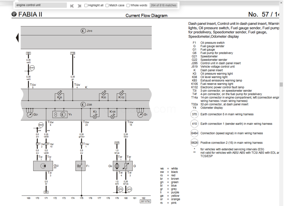

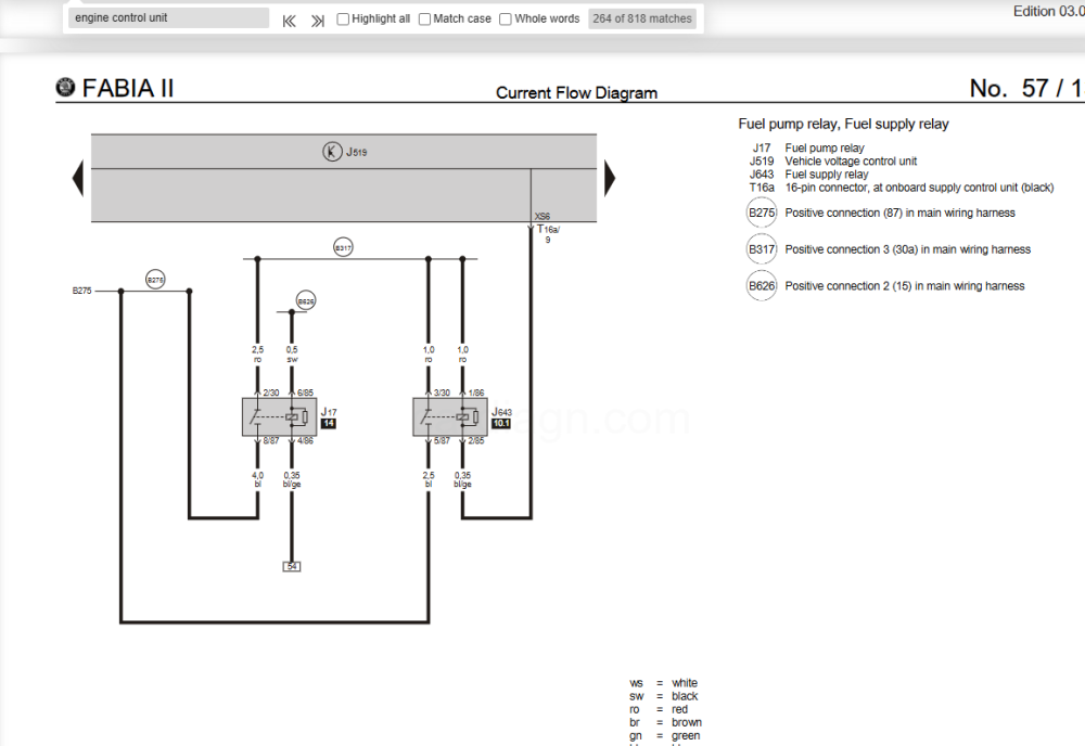

  6. Hello all! I'm really hoping you will be able to help me with a puzzling issue I've got with the car above. She will crank over, fire up and then immediately the engine stops. When this first happened, I noticed I couldn't hear the usual buzzing from the fuel pump so I checked the fuses below the steering wheel and found that fuse #7 (Engine Control Unit 1.2ltr 15A) was out a little and felt loose. I pushed it back in, now nice and snug and the fuel pump buzz could be heard again and the engine started and ran fine for a couple 10mins so that was that. The next day it started fine, drove for 5 miles and all was good. I came back to the car to start it and again it cranked over, fired and stopped immediately. No noise from the pump so I checked the same fuse and it was snug. Pulled it out and pushed it back in and no change. I then checked fuse #30 (Fuel Pump - Petrol Engine) and noticed there was no power there. I've done the steps below: 1/ I have 12V constant from the battery (B317) to pin 30 on J17 FPR 2/ I have 12V from the ignition switch (B626) to pin 85 on J17 fuel pump relay 3/ I have continuity from pin 87 of J17 FPR to Fuse #30 (B275) 4/ If I join pins 30 & 87 of J17 FPR the fuel pump runs fine and the car starts & runs 5/ When I put the J17 FPR back in, turn the ignition on, while checking the output of pin 87, I get 12V for about 1 second and then the relay clicks and it opens and back to 0V. I've tried two other known working relays and I get exactly the same result. If I'm reading everything right (please tell me I'm missing sometime), it's looking like the ECU (pin 26) is grounding out pin 87 of the FPR for about a second and then this stops and the FPR opens again. If the above is correct, does anyone know why the ECU would stop grounding this wire to pin 87? Thank you in advance!
