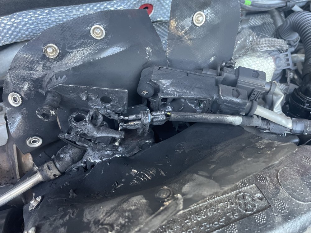

  1. Ok thank you again for you help. I will search once I receive the sensors and plugs I have ordered.
  2. Ok Great Thank you J.R. I will search the help in VCDS for that.
  3. Wow thank you again Gabbo! I'll see if I can find locally. Do you know if the sensors need coding with VCDS when fitting?
  4. Thanks again Gabbo! that has pointed me in the right direction cheers. Seems like this is a common occurance when a timing belt has been replaced. I have found the sensors locally @ AUD26.00 each so I have ordered 2, just need to find the plug kit or may go to wreckers and see if they would cut off a loom.
  5. Yes just as good as before! don you have the part numbers for these sensors? Can you buy repair plug fittings? thank you
  6. Thank you for that, the only thing I can think of is when I did the timing belt I undid the pipes that run across the belt cover and just moved them out of the way. So it’s possible one of the rubber hoses either came off or cracked in the process and I didn’t notice it!

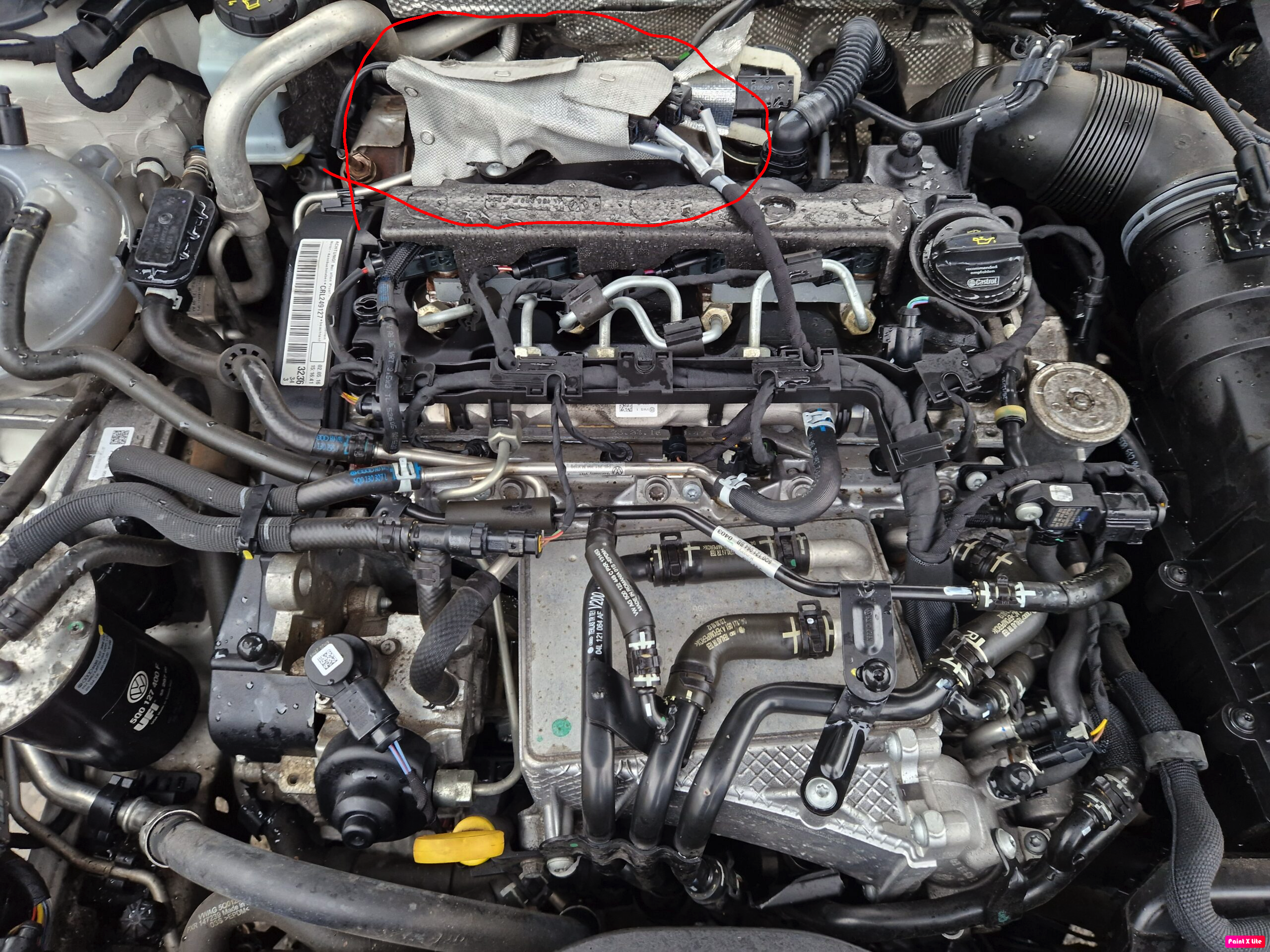

  7. Thanks for your reply Gabbo. See new picture they sit at the top rear of cam cover.

  9. Thanks for your reply Tilt. See new picture they sit at the top rear of cam cover.
  10. Hi all, I hope you are all well! Like most have been trolling here for awhile and getting info about any issues I've had with my Skoda and with all the helpful people here I have been able to repair things that have been discussed here. I recently did a timing belt replacement bearings and water pump all went well since was my first go at this type of car, youtube was my friend about 3 days later the engine check light came on which was strange I thought? anyway I check everything seemed ok plugged in my VCDS and it came up with P2452 fault did some googling and checked on here to find most likely DPF sensor issue, thought I would just check over the car again removing the engine cover and found these sensors burnt out on top of the engine. To be honest I don't know what they are and why they have completely burnt like they are. One is completely melted and the other is just about the same so therefore I need help identifying this senors and the parts numbers so I can order them and the plugs if possible. Much appreciate any help in advance. Cheers Bryan
