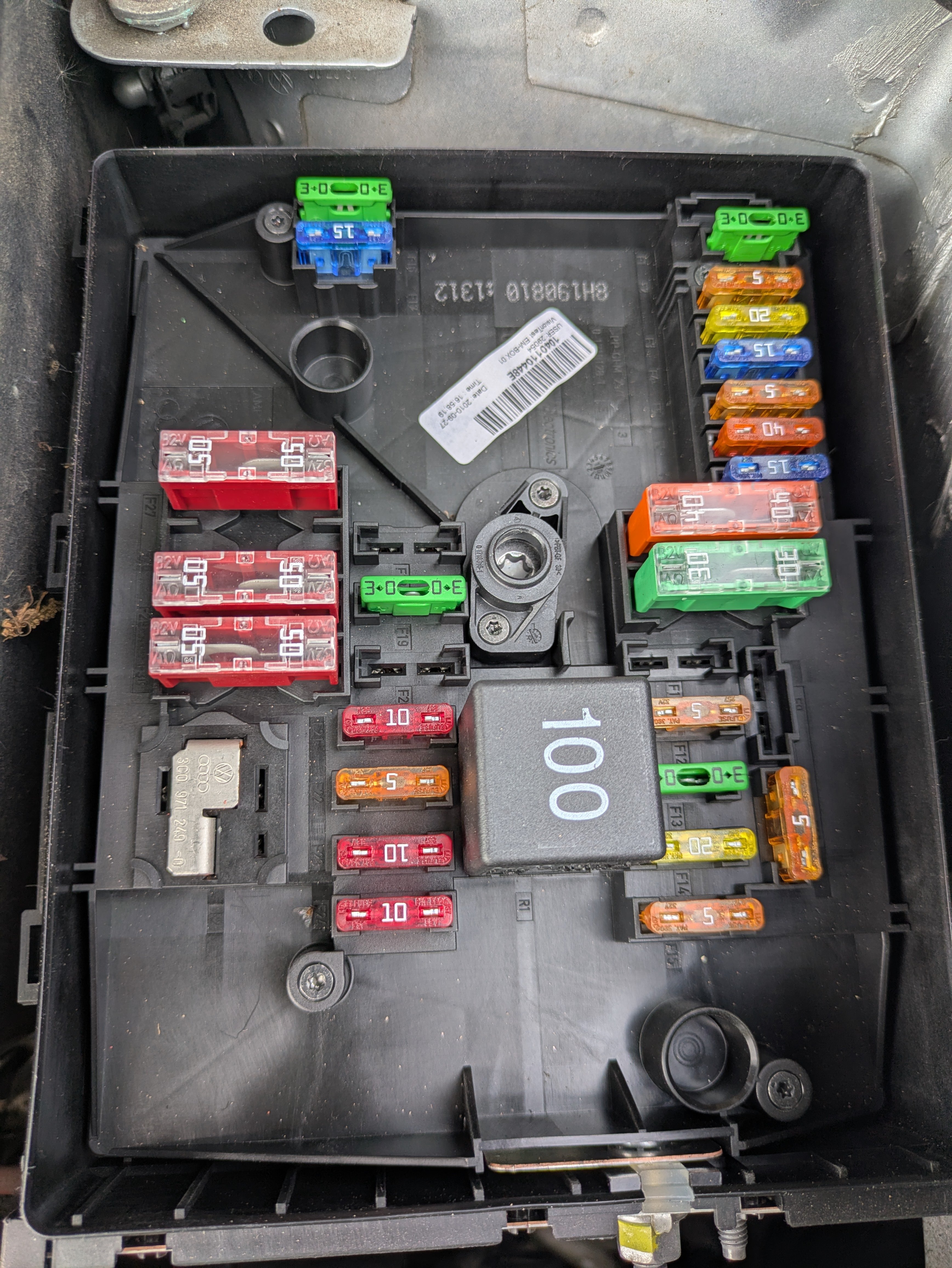

  2. Hi there, I have a 2010 MK2 Octavia and I I wanted to check the Aircon fuse in the engine bay. Do you know which one it would be if there is one? I've checked the dash ones already. Many thanks πŸ‘
  3. Great, thanks I'll take a look there too πŸ‘πŸ‘
  4. Thanks, I've checked both fuses in the dash....none in the engine bay is there? Appreciate your feedback ☺️

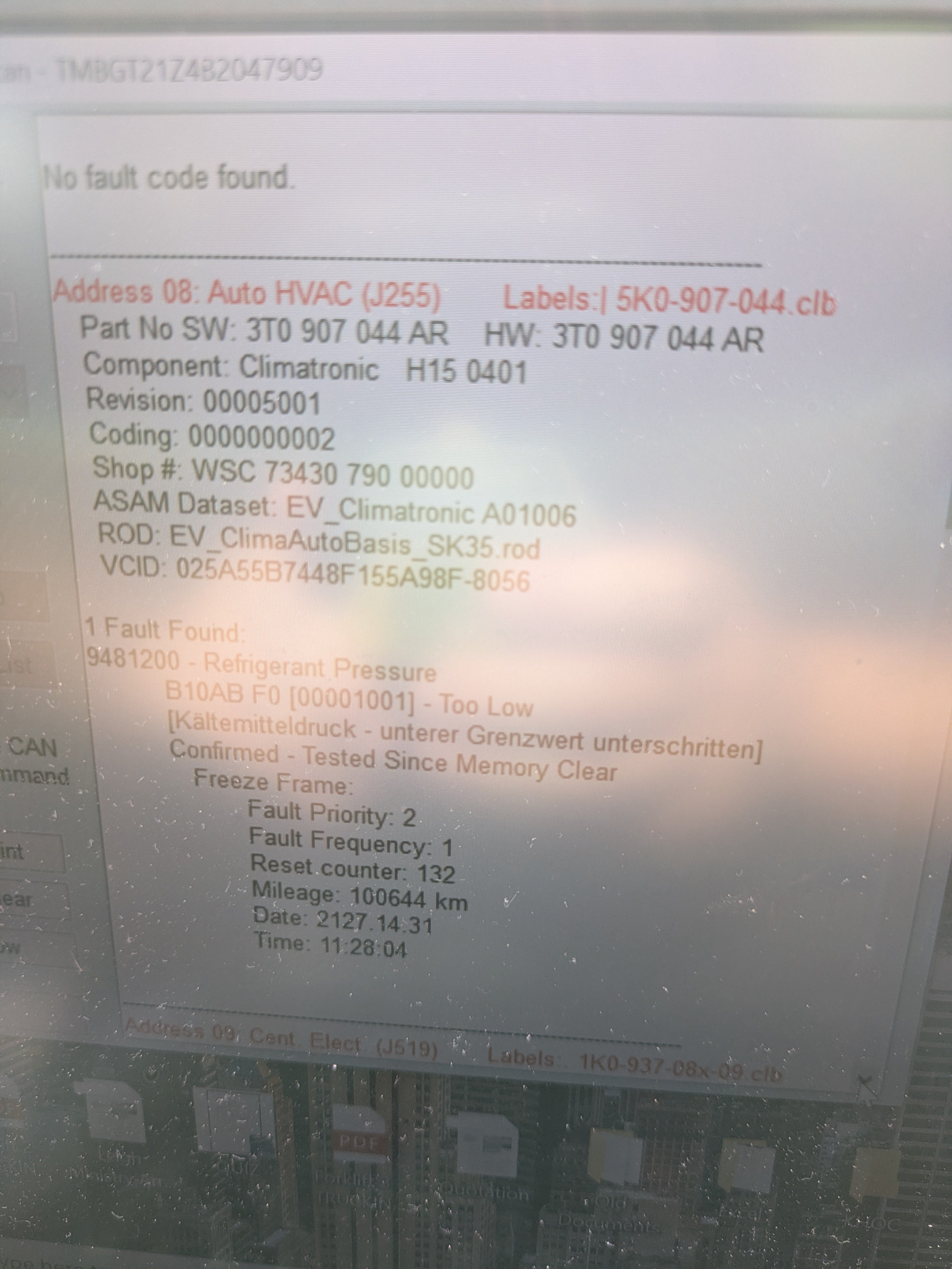

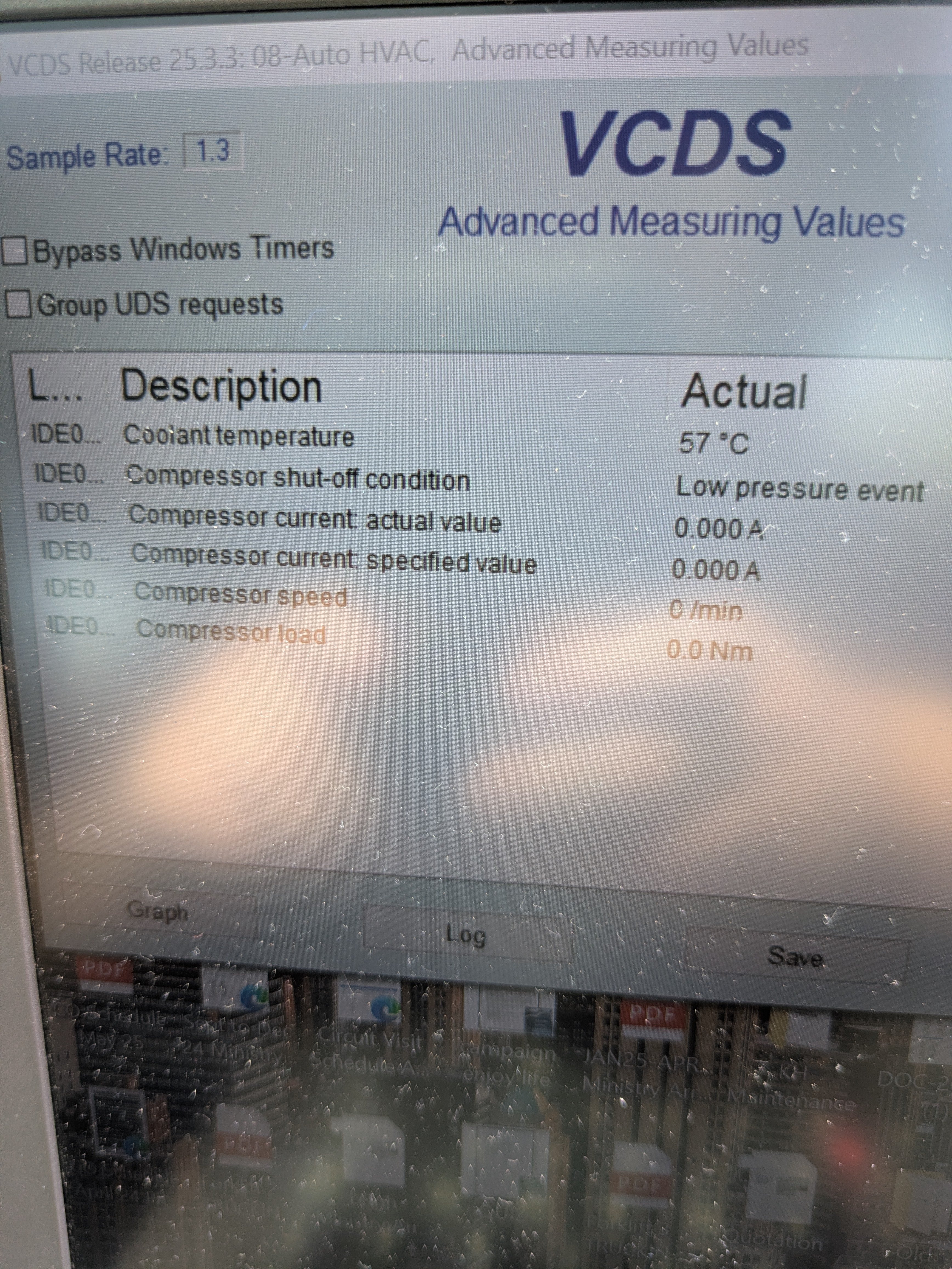

  6. Hi everyone, man it's hot and my Aircon isn't working πŸ˜… I've just plugged it in to vcds and I have the following pictures of the readouts. Clutch seems to be engaging and spinning, would it be a simple regas or do these codes suggest something else to you? Appreciate your thoughts!
