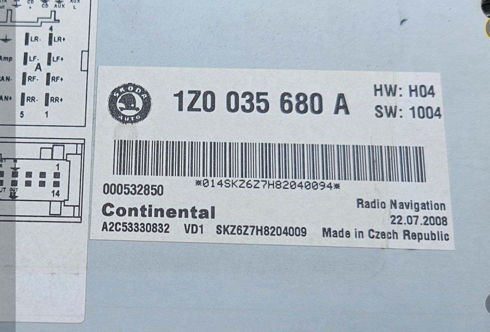

  3. 2008 skoda octavia mk2, 1.9BLS engine Hi there, I have faced these errors for a couple of months now: When it's hot, the car gets an engine light, with the glow plug light blinking and ESP/TCR light on. The car does not go past 3k rpm and also shakes a lot at starts and stops. i have 2 vcds auto scans that show errors related to the engine and ABS module, I can't seem to find any help.. scan 1: Address 01: Engine Labels: 03G-906-021-BLS.clb Part No SW: 03G 906 021 TG HW: 03G 906 021 AB Component: R4 1,9l EDC G000SG 2051 Revision: --H08--- Serial number: SKX7Z0H632F0IL Coding: 0000071 Shop #: WSC 06325 000 00000 VCID: 77FD5EDB06CD4D23F1-8022 VINID: 91D4988C606A208082009202106D8E37D5 1 Fault Found: 001602 - Sensor Reference Voltage A P0642 - 000 - Voltage too Low - MIL ON Freeze Frame: Fault Status: 11100000 Fault Priority: 1 Fault Frequency: 1 Reset counter: 255 Time Indication: 0 Freeze Frame: RPM: 0 /min Speed: 0.0 km/h Bin. Bits: 00100000 Bin. Bits: 00000000 Bin. Bits: 00100000 Bin. Bits: 00100000 Bin. Bits: 00100000 Readiness: 0 0 0 0 X \------------------------------------------------------------------------------- Address 03: ABS Brakes (-----) Labels:. 1K0-907-379-60EC1F.clb Part No SW: 1K0 907 379 CD HW: 1K0 907 379 AD Component: ESP MK60EC1 H35 0120 Revision: 00H35001 Coding: 113B201C09220003881304E6901D00416800 Shop #: WSC 22150 002 1048576 VCID: 76E353DFC1C7342BEA-8022 1 Fault Found: 01314 - Engine Control Module 013 - Check DTC Memory Freeze Frame: Fault Status: 01101101 Fault Priority: 2 Fault Frequency: 1 Reset counter: 125 Mileage: 315424 km Time Indication: 0 Freeze Frame: Count: 2 Count: 2 Count: 12544 Count: 8196 Count: 44800 Count: 768 Count: 0 Count: 0 aaand scan 2: Address 01: Engine Labels: 03G-906-021-BLS.clb Part No SW: 03G 906 021 TG HW: 03G 906 021 AB Component: R4 1,9l EDC G000SG 2051 Revision: --H08--- Serial number: SKX7Z0H632F0IL Coding: 0000071 Shop #: WSC 06325 000 00000 VCID: 77FD5EDB06CD4D23F1-8022 VINID: 91D4988C606A208082009202106D8E37D5 1 Fault Found: 001602 - Sensor Reference Voltage A P0642 - 000 - Voltage too Low - Intermittent Freeze Frame: Fault Status: 00100000 Fault Priority: 1 Fault Frequency: 1 Reset counter: 255 Mileage: 315432 km Time Indication: 0 Date: 2000.00.00 Time: 16:33:25 Freeze Frame: RPM: 0 /min Speed: 0.0 km/h Bin. Bits: 00100000 Bin. Bits: 00000000 Bin. Bits: 00100000 Bin. Bits: 00100000 Bin. Bits: 00000000 Readiness: 0 0 0 0 X \------------------------------------------------------------------------------- Address 03: ABS Brakes (-----) Labels:. 1K0-907-379-60EC1F.clb Part No SW: 1K0 907 379 CD HW: 1K0 907 379 AD Component: ESP MK60EC1 H35 0120 Revision: 00H35001 Coding: 113B201C09220003881304E6901D00416800 Shop #: WSC 22150 002 1048576 VCID: 76E353DFC1C7342BEA-8022 1 Fault Found: 01314 - Engine Control Module 013 - Check DTC Memory - Intermittent Freeze Frame: Fault Status: 00101101 Fault Priority: 2 Fault Frequency: 1 Reset counter: 165 Mileage: 315432 km Time Indication: 0 Freeze Frame: Count: 3 Count: 2 Count: 12544 Count: 8196 Count: 45312 Count: 0 Count: 0 Count: 0
