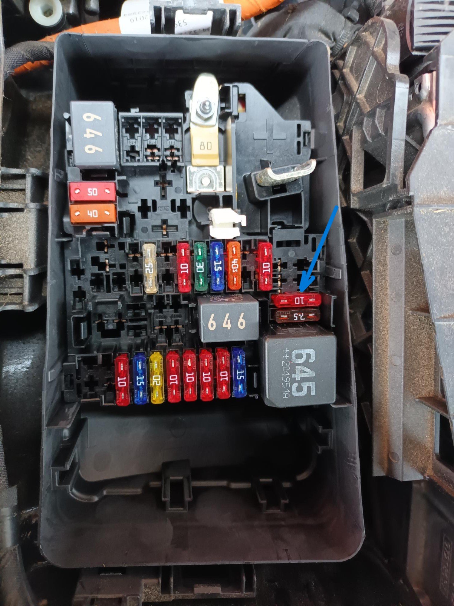

  1. As a new member I just wanted to thank people on the forum for pointing me in the right direction to sort a charging issue I had with my 2021 Octavia iv SE Tech. It stopped charging from my 13A socket at home. After a couple of calls to the main dealers in the area they stated they wanted me to bring the car in for diagnostics (which was fair enough). I thought I would just check Google for anyone that had a similar issue and I was directed to this forum. I'm glad I did as I removed the 10A fuse that controls the Charging unit, and when re-plugged in the issue went away immediately. Since then I have charged the car several times with no issue. Not sure what caused the initial problem but just wanted to thank the contributors that saved me the hassle and expense of a visit to my Skoda dealer who is 30 miles away. I've attached a photo with the fuse to assist anyone else having the same issue.
