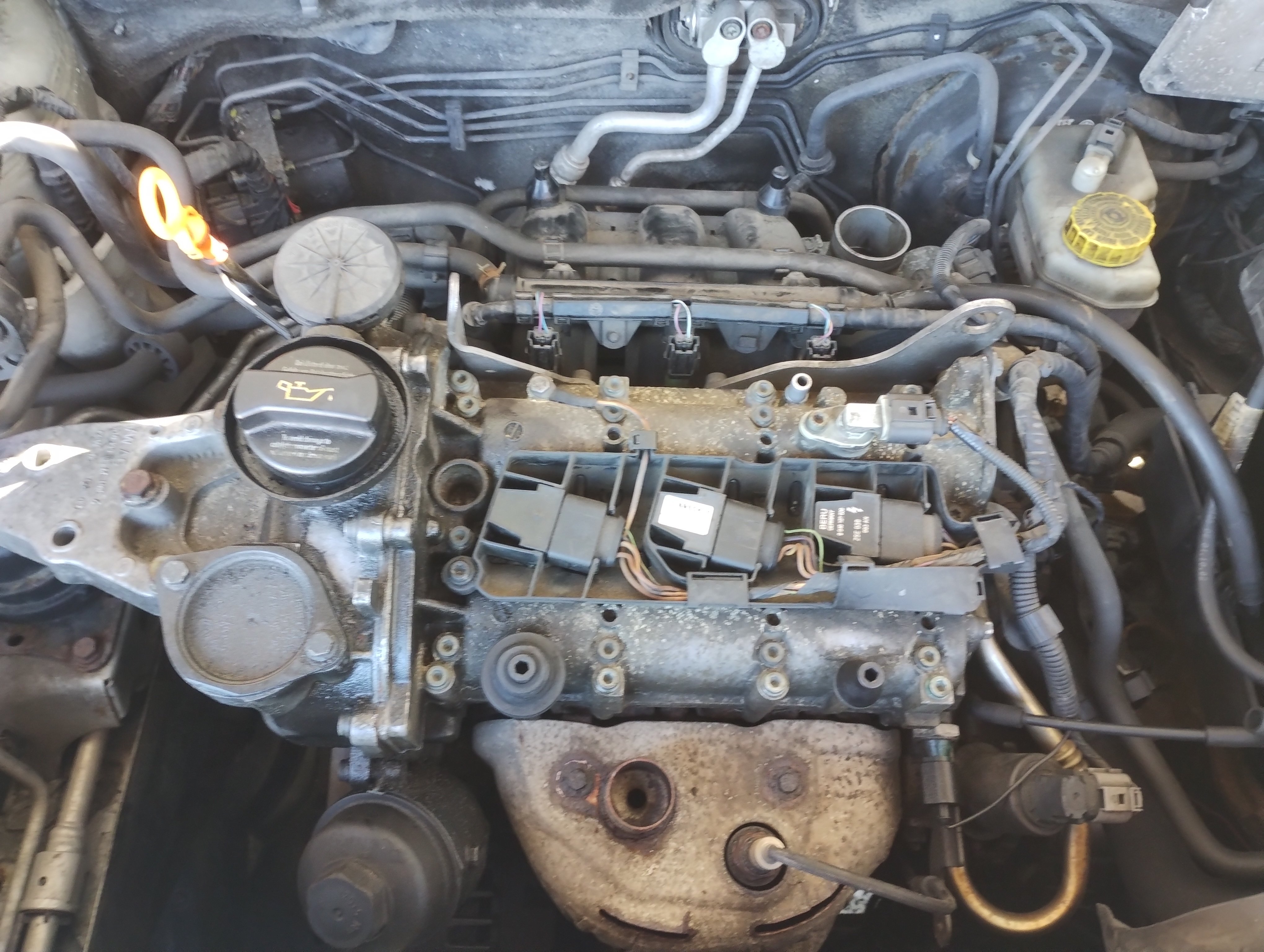

Here is what the engine bay looks like. Would that be a twin cam? My friend thinks it may be the idle controller valve that might cause the problem (not letting enough air through at idle). Otherwise will check the exhaust coupling. Apart from low lambda the CO emissions at high idle were measured to 8,7% (the limit for fail is 0,2%)
