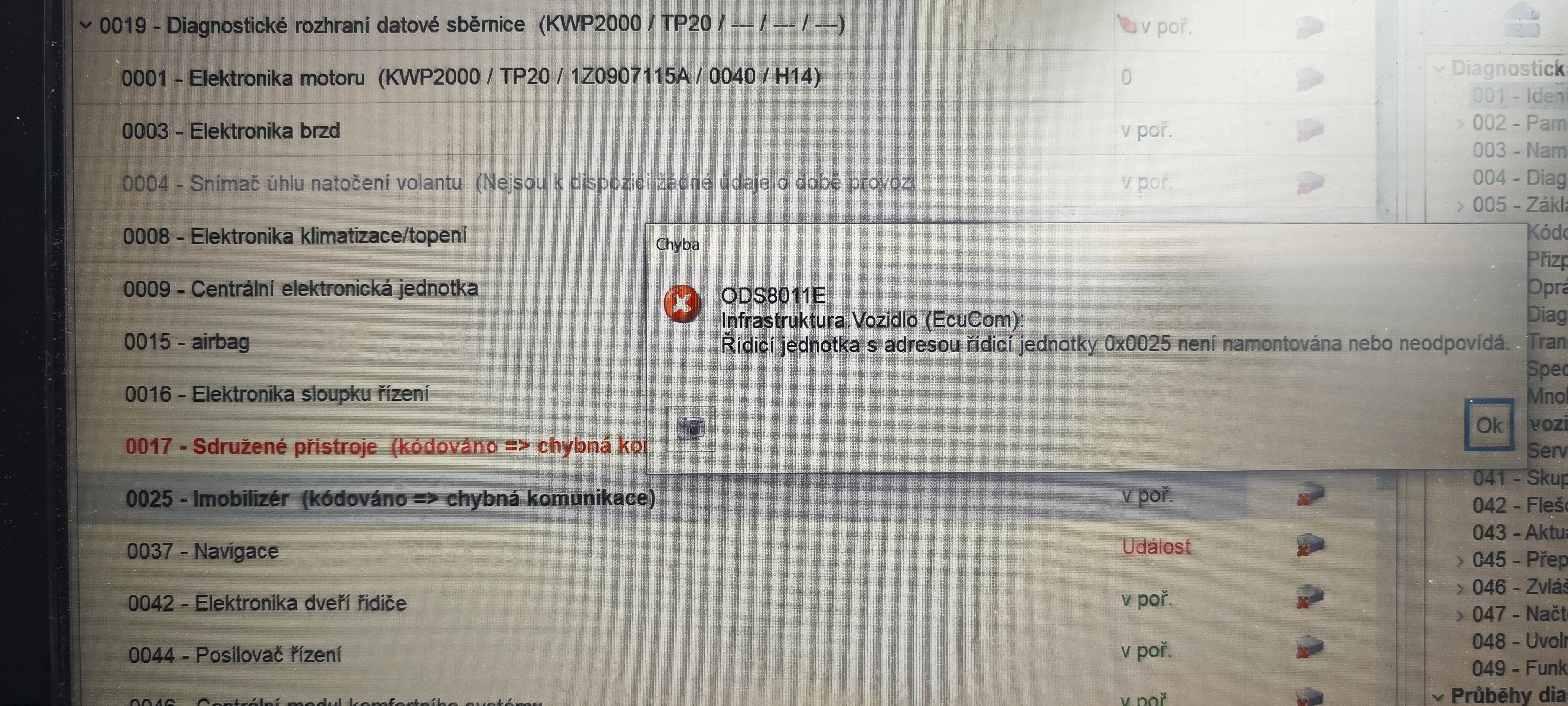

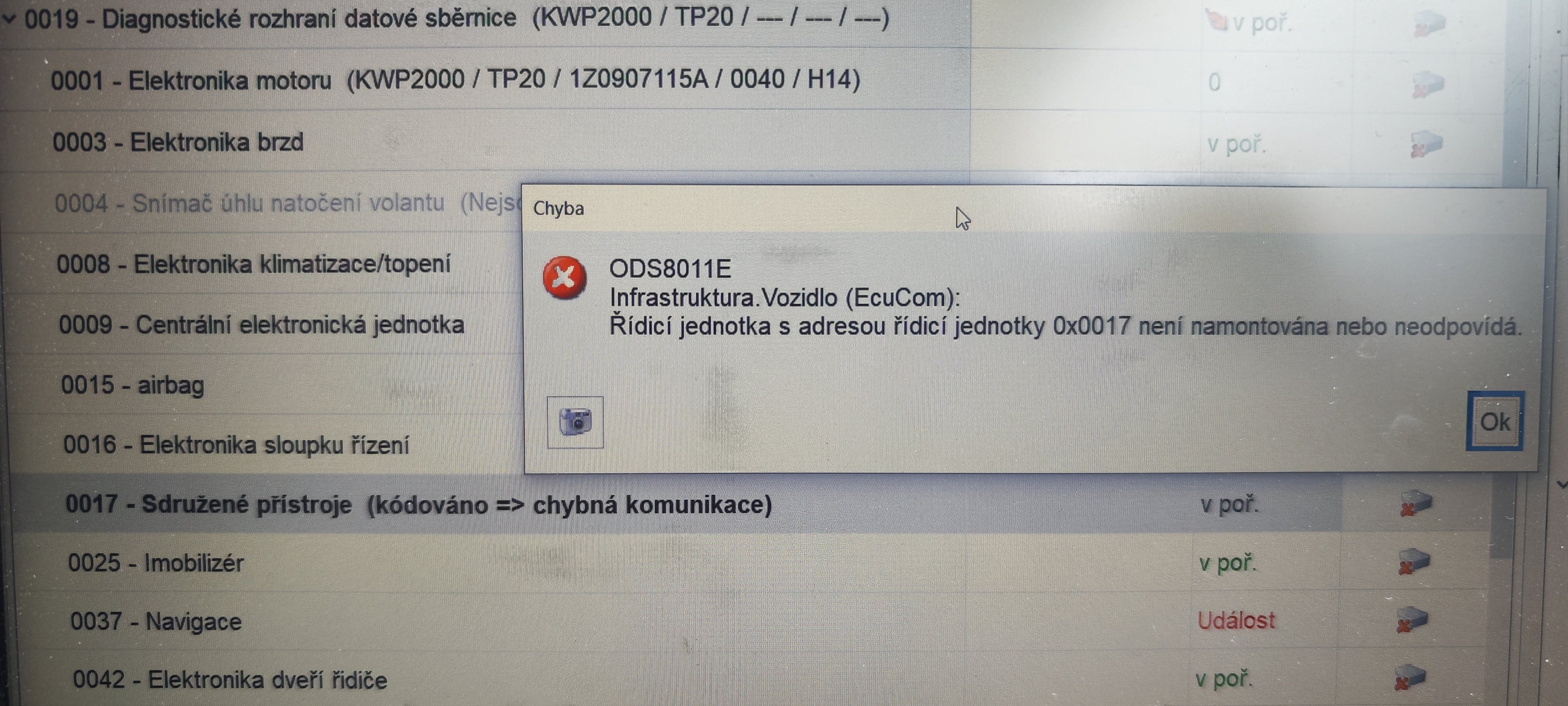

  1. It's the second option, anyway I don't understand that before the cluster replacement it was clean... Someone changed the radio before me and that left an error too. There was an Amundsen and it was replaced with an Amudsen+
