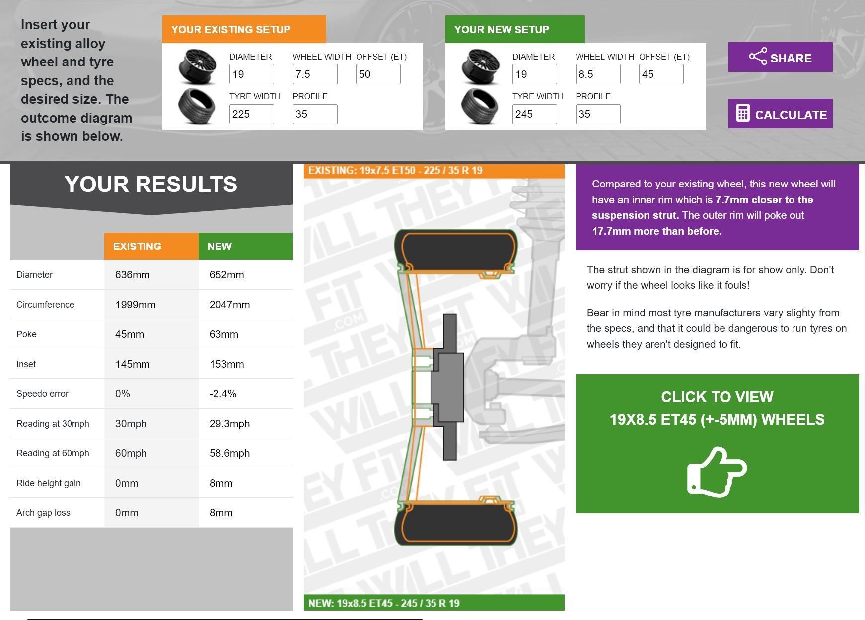

  3. Yes, I believe they are (7.5J ET51) for the Xtreme 19". For 245/35, I would need 8.5J ET45, according to the web app, which makes the spoke side protrude approximately 17mm further out and the strut side move about 7mm further in (which is certainly feasible—though I'm unsure about full compression). Based on JT2's experience, this setup fits well within his geometry. With the added height and a few millimetres of spoke-side protrusion, it seems manageable. Regards PZ
  4. I don’t think pursuing the staggered route is a viable option based on the feedback so far, and to be honest, I’m fine with that—it was just an idea. However, I’d like to explore the 245 options further. Looking at JonnyType2’s setup (that is seriously slammed—fair play!), along with his comment about using a 20mm spacer on top, it seems promising. Given that I’m not planning to lower mine any time soon, I don’t see why, with the increased track and correct offset, this wouldn’t be feasible. I will do some actual measurements and CAD it up to be sure of course. Currently run 235/35 R19's for the last few years and completely fine. A better choice imo. Many thanks to all who have commented, by the way, it is very much appreciated and informative. Regards PZ

  6. Hi all, New to forum so I hope this finds you all well. Currently I have 235/35 R19' on standard xtreme alloys which I think suit the wheel size better. They certainly give a better feel/confidence on braking and spirited driving from my perspective. I have had a good search on previous posts but can't find much on going wider on the tyre profile. A fair few going smaller from 19's to 18's due to our lovely roads and potholes in the uk but little on wider tyres for 19's. What I would ultimately like rightly or wrongly hence my question is 245/35 R19 on 8.5J up front with E45 offset (I can live with a few -% which would correct my current speedo to GPS speed). On the rear 255/30-35 R19 on 9J with E50 offset. This would give me approx 20mm positive spoke side 7mm front / 20mm rear suspension side. I was just wondering if anyone knew or had any experience with wheel/tyre of this size? Many thanks in advance for any thoughts or knowledge. Kind Regards PZ
