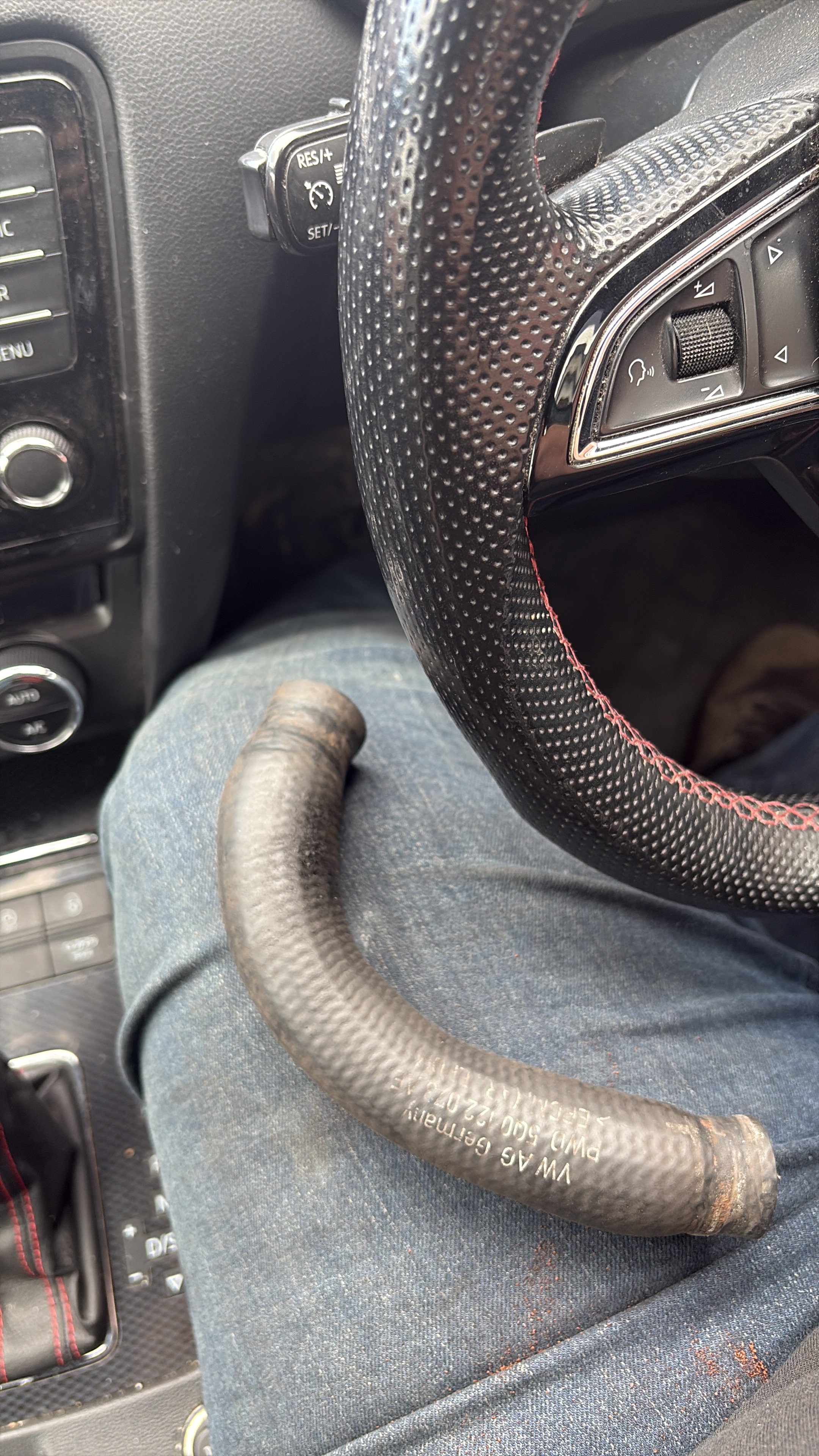

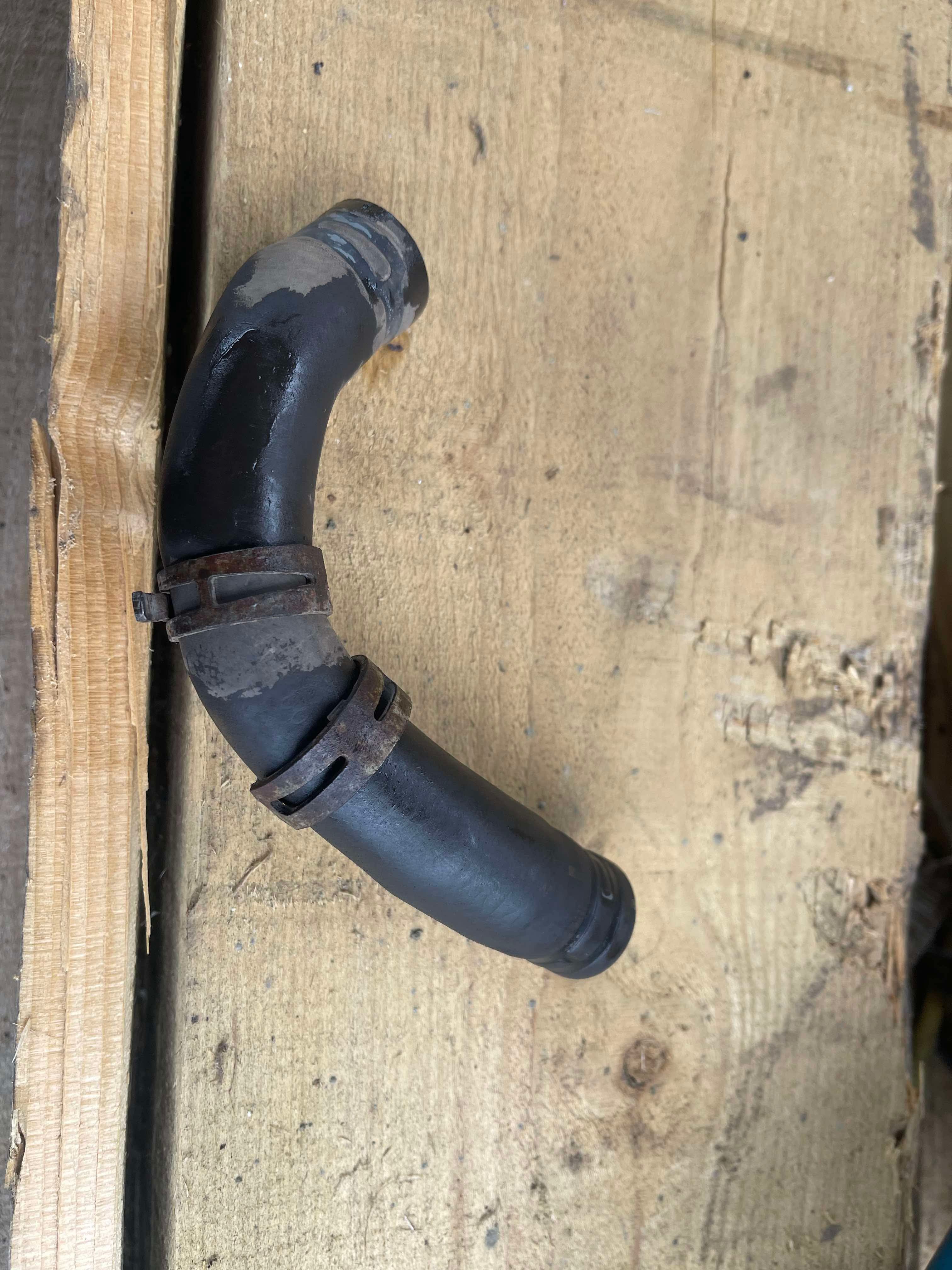

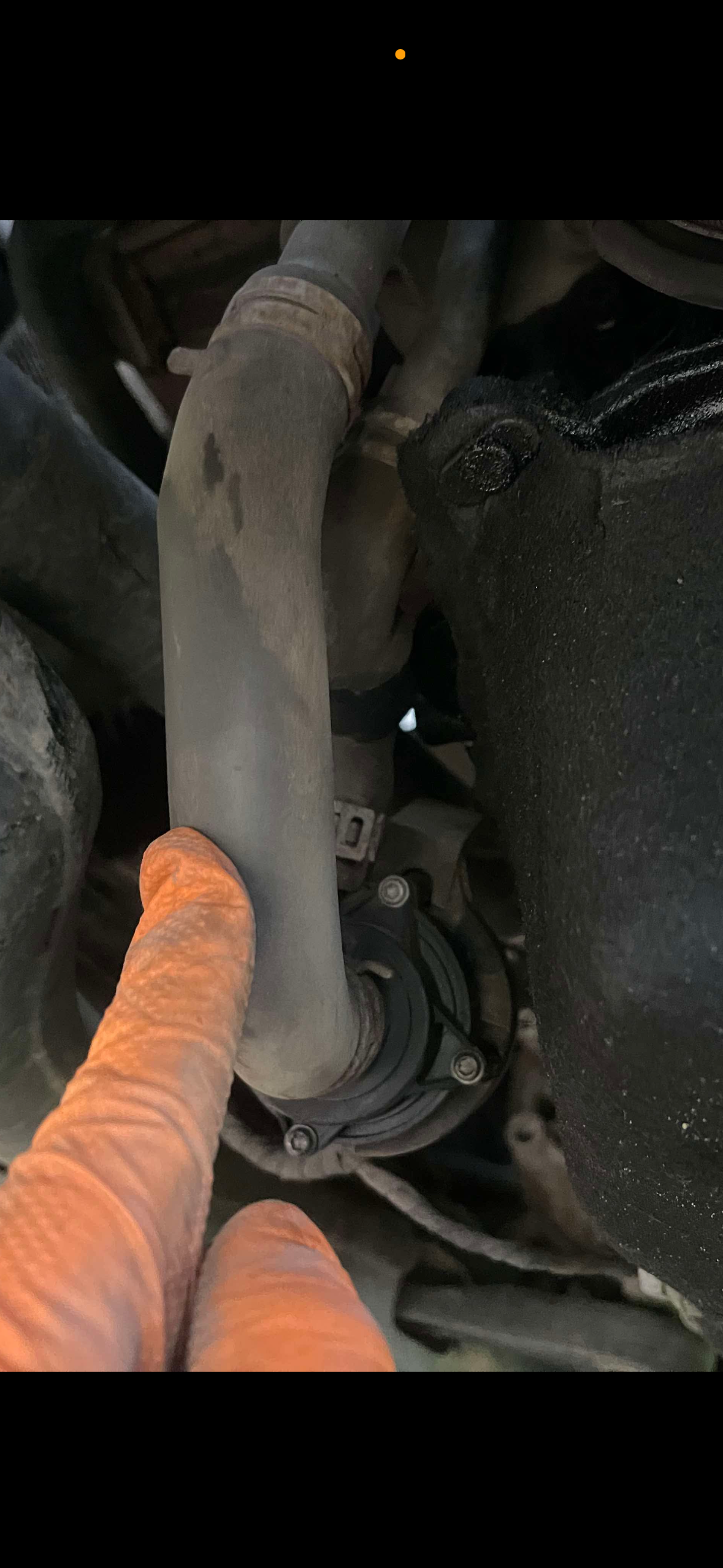

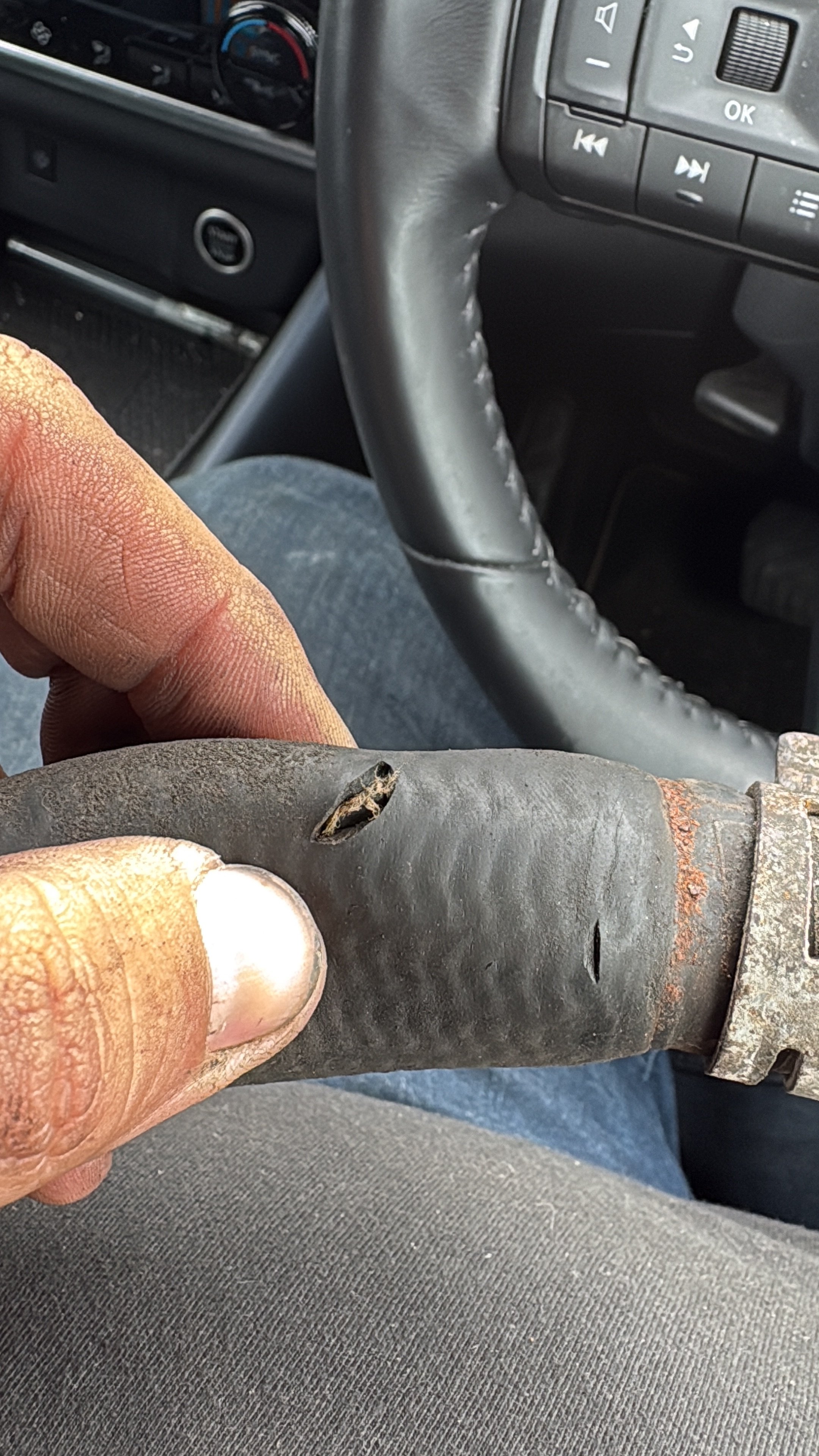

  8. Hi there ofcorse. There is a small right elbow pipe with a one way valve in and it’s a Uk spec right hand drive
