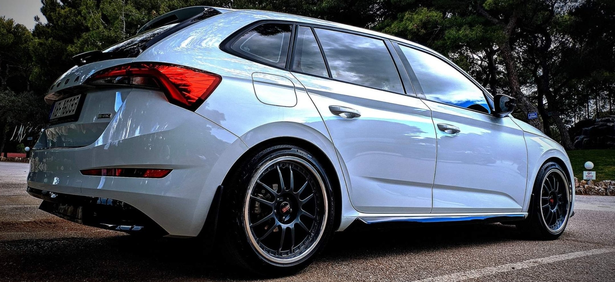

  1. Finally upgraded to the front brakes from the Polo GTI AW - Audi A1 Gba 🤘 This was something I should have done a long time ago. However, after going through three sets of brake discs, the same number of sets of pads, and putting the stock setup through some serious punishment on track, I think I finally made the right decision. The car in question is a Skoda Scala 1.0 G-TEC, which comes from the factory with 256 mm front brakes. 🔧 What was needed for the conversion as mentioned by carlston and the other guys here: • Steering knuckles from a Polo GTI AW or Audi A1 2.0 GBA Unfortunately, I couldn't find them anywhere, so I had to order them through official dealership here in Greece. • Brand-new TRW red brake calipers, together with their matching red caliper brackets. • FAG wheel hubs with bearings from an Audi A1 These are 76 mm, instead of the 72 mm units fitted to my model. • Brembo brake discs from an Audi A1. • Ferodo Racing DS2500 brake pads. • Brake dust shields / heat shields. • TRW 23.8 mm brake master cylinder The original master cylinder was 22.2 mm. The high-pressure brake lines remained unchanged. I also replaced the brake fluid with Castrol React SRF. 🏁 And now... time to test it! The installation was completed today, so I will obviously need some time to properly bed in the new discs and pads. I'm really looking forward to seeing how the car behaves with the new setup, especially on track. Considering how much abuse the stock braking system has taken, I'm hoping this will result in a significantly stronger and more consistent braking setup. 🤞

  6. Hello there. Im Alex and i have a Skoda Scala 1.0 G-tec 2020 model. Its the ambition version and i chose this model with natural gas for the economy of the cng. I bought the original bodykit from monte carlo and the emblem and letters in black. I also bought eibach sportline springs -45mm and with the new wheels OZ racing Superleggera iii the car really tranformed. After 60.000km and when the guarantee was over, was time for a little tune to the engine, just to wake up a little. Pipercross air filter with racingline turbo inlet elbow, full custom exhaust and remaped. Now the car is more enjoyable and fun to drive. My next mod the st xa suspension and i try to figure out how can i install bigger brake setup.
