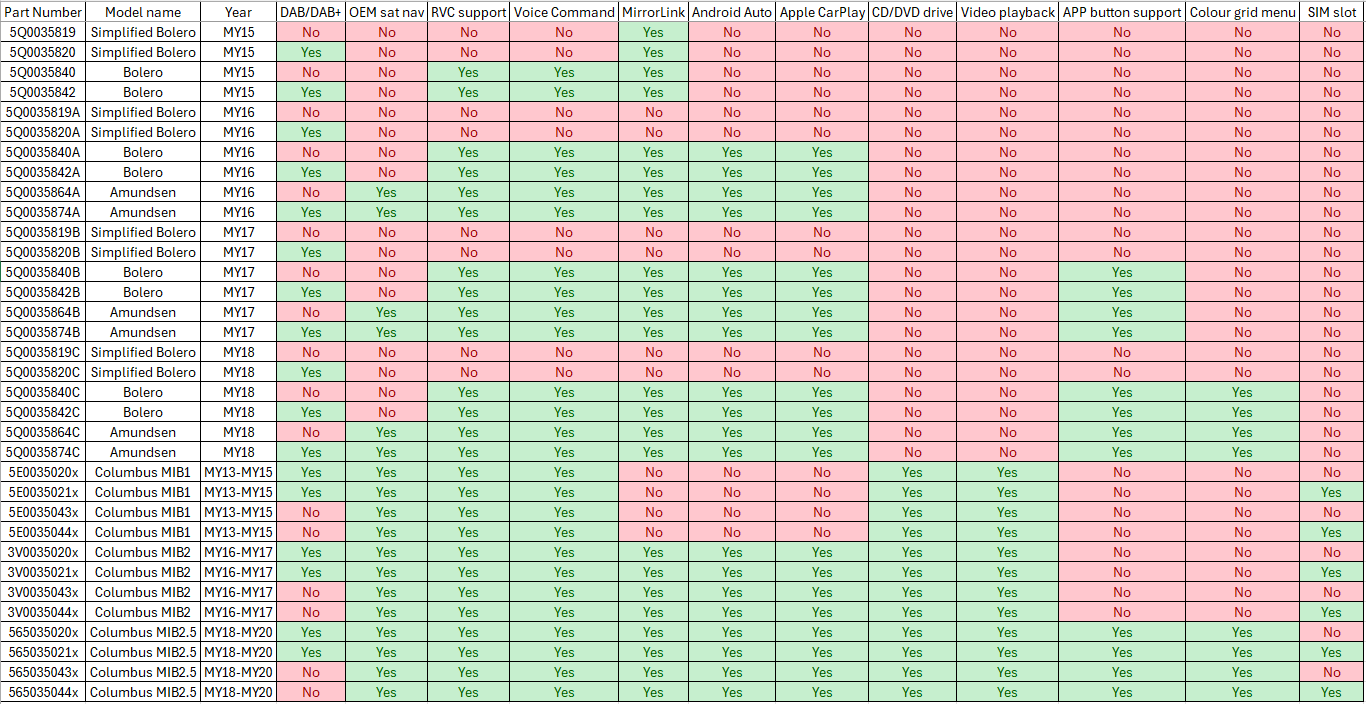

  1. Hi @SashaGrace I see you have mentioned that 'it' won't work in 5Q0035874B unit. Could you please explain what exactly doesn't work in this radio unit? Asking because I'm on a lookout to buy this exact unit. Per the image below, 74B unit is Amundsen from MY17 and should support Carplay and Android Auto. Please let me know why did you advise not buy the 74B unit. Thanks in advance.
