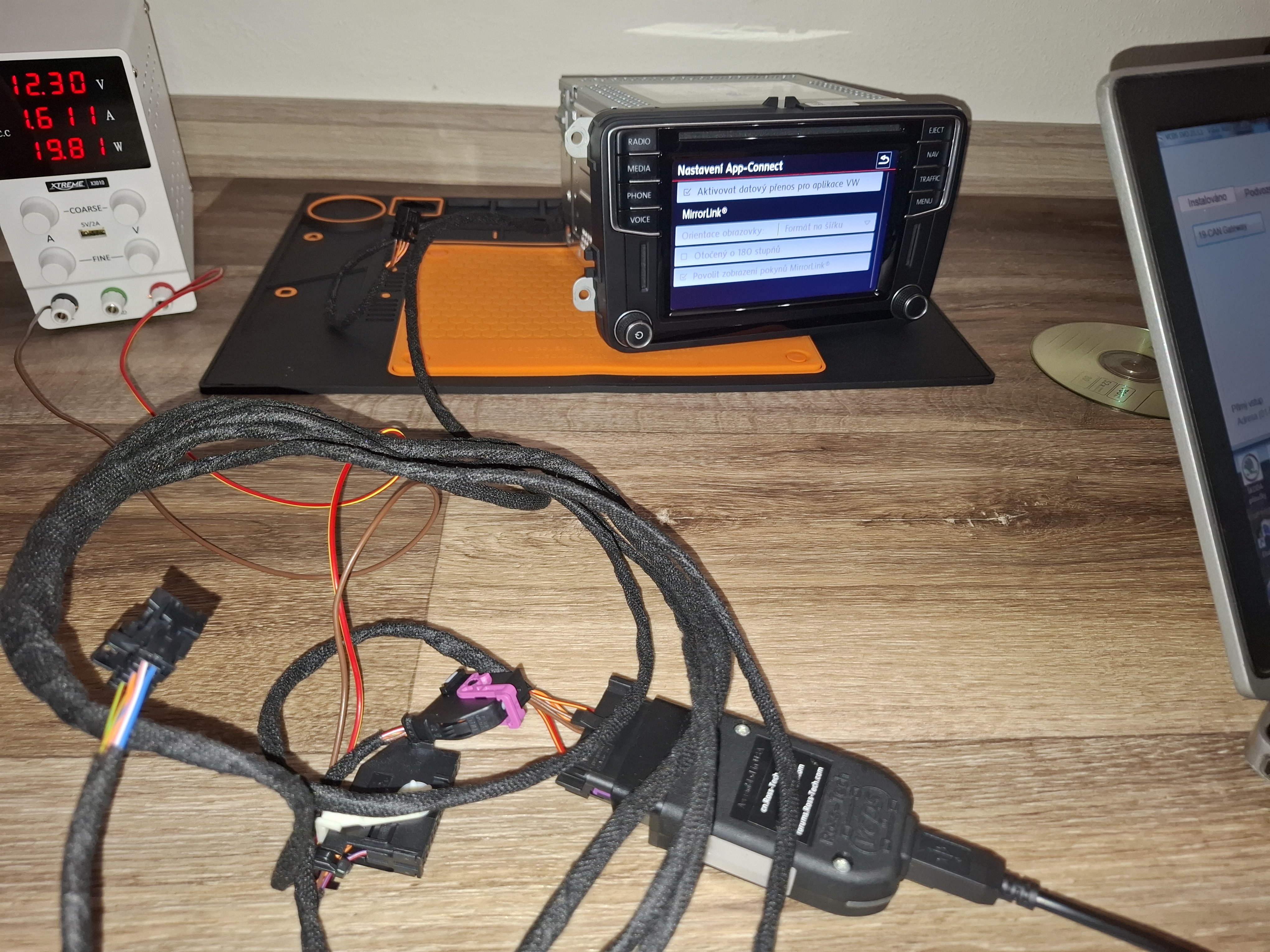

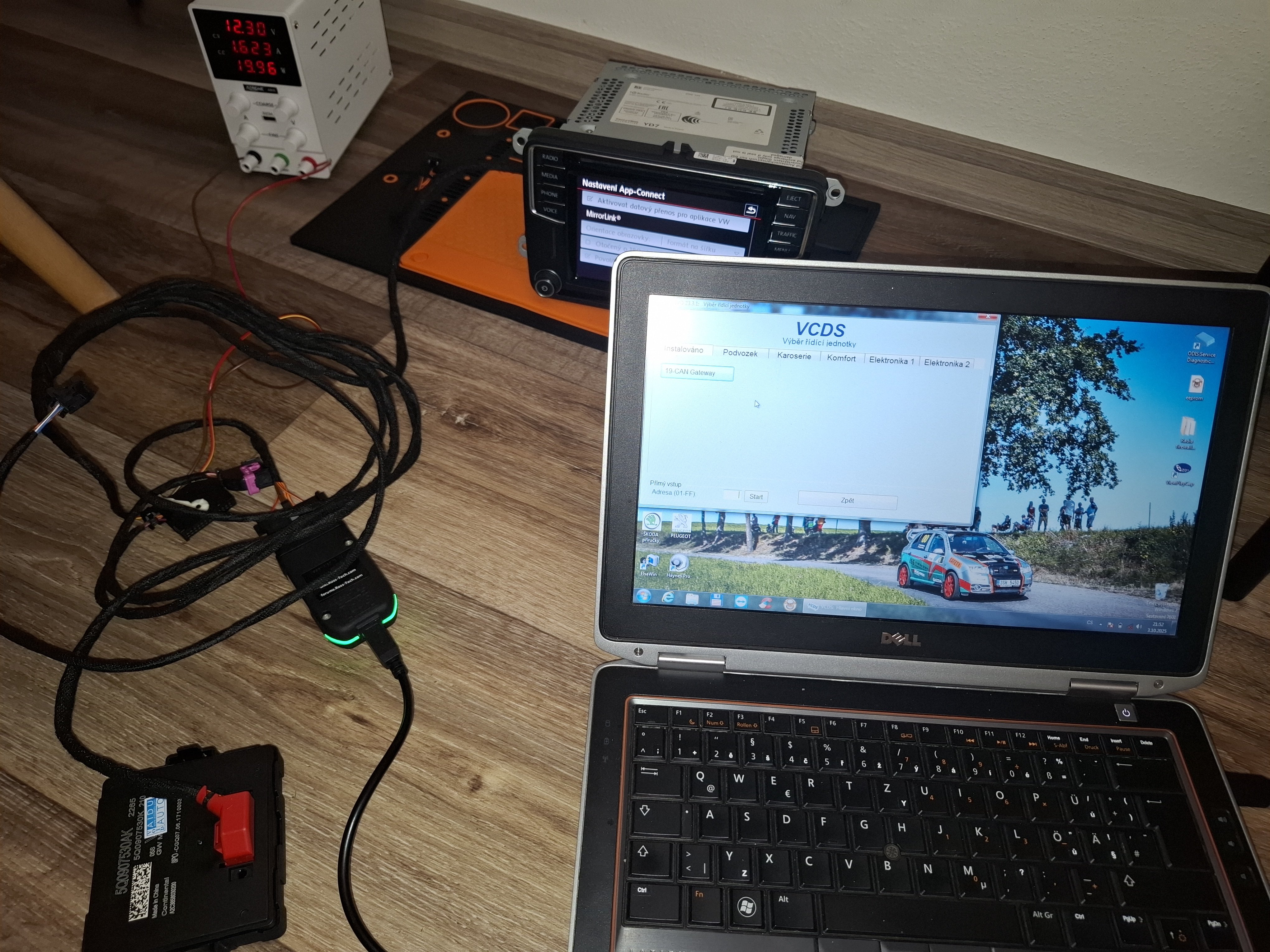

  1. Hi guys. I have a question for you. I bought a connecting cable to power the radio from an external source. The reason was to connect diagnostics on the table. For this, a gateway control unit is needed. I have everything. However, after connecting the vcds diagnostics, the diagnostics only see the gateway. It does not see the 5f infotainment unit. It does not communicate. As you can see in the photos. I was a little surprised that when turning on Bluetooth on the radio it says, "turn on the ignition", Does anyone have any ideas how to connect the diagnostics so that everything communicates. Thank you very much for the answer David

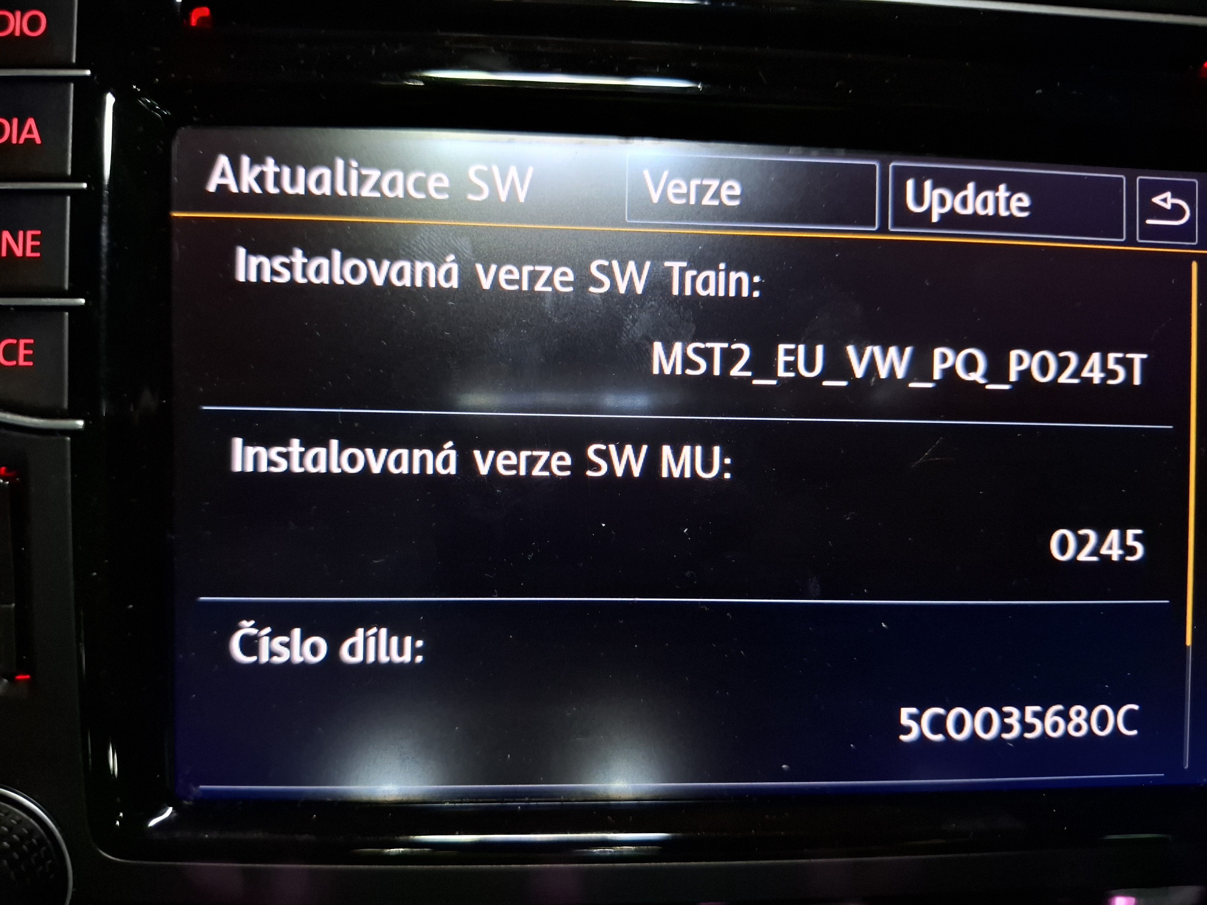

  2. Hi everyone, so I have confirmation that for the update from 245 to 480 you need Toolbox and even version 1.3.3. Unfortunately I overlooked one thing. I have version MST2_EU_VW_PQ_P0245T And the downloaded 480 software from pab567 is for version MST2_EU_SK_ZR_P0245T The problem is in the letters PQ (multivan t6) And ZR (octavia for example.) The difference is in the unit located in the radio or separately in the passenger compartment. Please can someone give me a link to download the new software for Multivan? That is for MST2_EU_VW_PQ_P0245T Thank you very much David

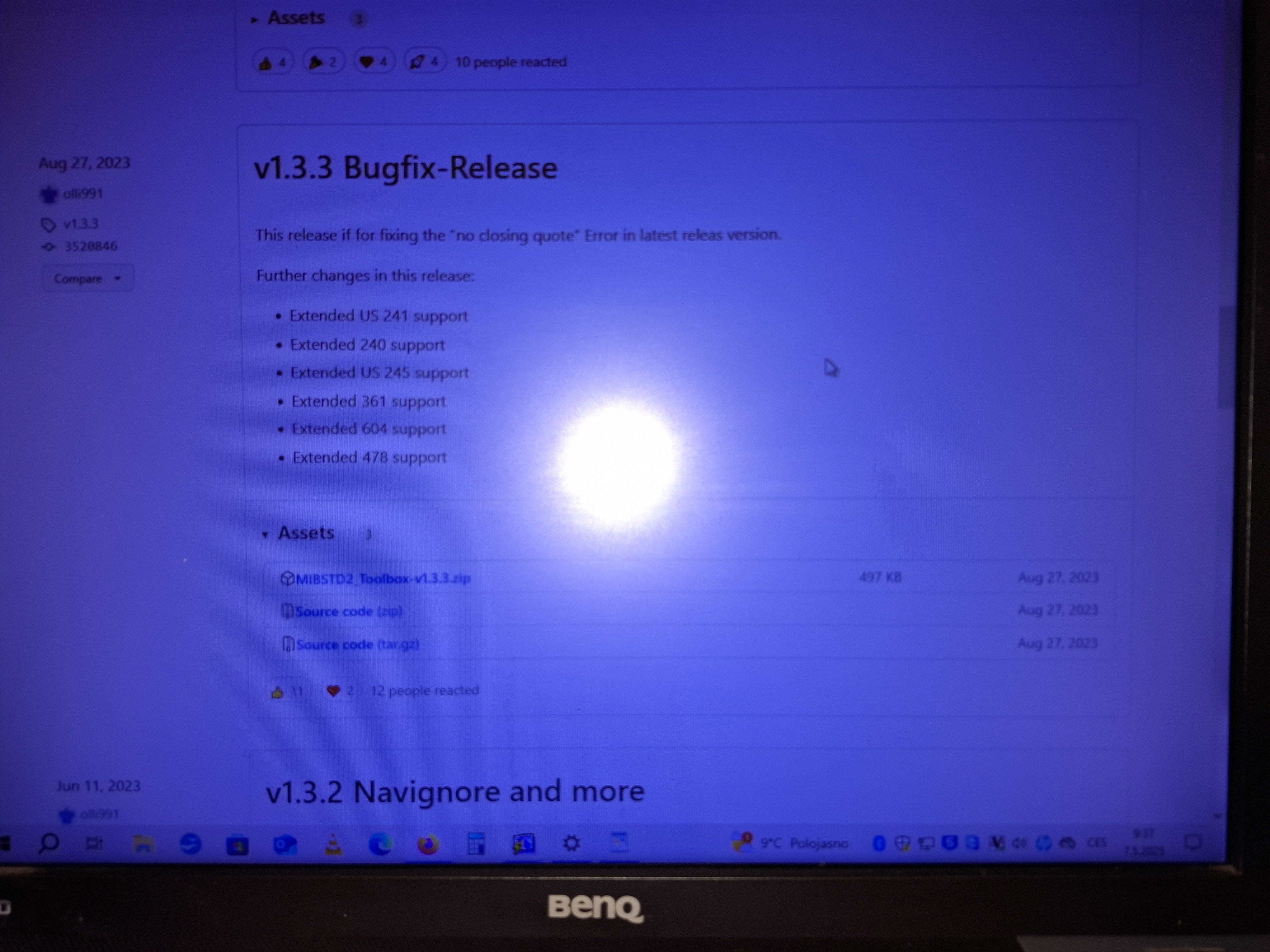

  6. Yes yes I know github. But I don't know how to download the Toolbox version. I downloaded version 1.3.3 which I read should work with my radio. But I would like to be sure. Please confirm that this version is correct. See photo

  8. This is my version. Multivan t6 Thanks
