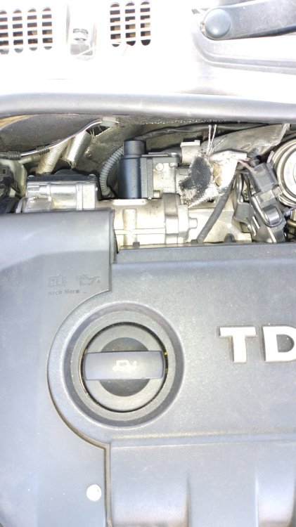

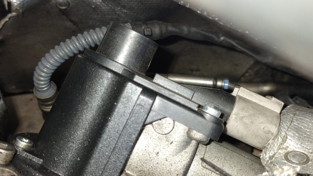

2009 mk 2 scout 2.0tdi what is O2 sensor location?

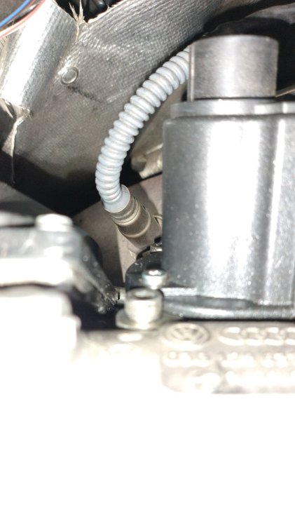

belated update: yes that is the Lambda Sensor. Need to remove the air pipes, and the throttle body (requires M10 spline/triple square socket) - No need to disconnect D type connector as enough cable length to just move TB out of the way. Then using a crows-foot type o2 socket, it came out easily.
ok thanks Alasdair, my o2 sensor is 0v 0data. I don't know if it's the turbo vanes full of carbon or the o2 sensor causing problems, car drives well first drive in the morning once warmed up, then later drives it performs poorly. I read somewhere that when the engine is cold the ecu uses stored/cold values and then later changes to values provided by sensors, not sure if this is true, if it is then that could account for the o2 sensor being the culprit. But there have been times when I massaged and lubed the wastegate shaft that it also drove well later in the day.... hmmmm
Greetings Again, Can someone please let me know the location of the O2 sensor? 2009 MK2 Scout 2.0tdi BMM I have spent hours on YouTube and no one has the same motor. In pics is it the the one with the crinkly GREY coloured wire cover? Also what is the easiest way to remove? Thanks

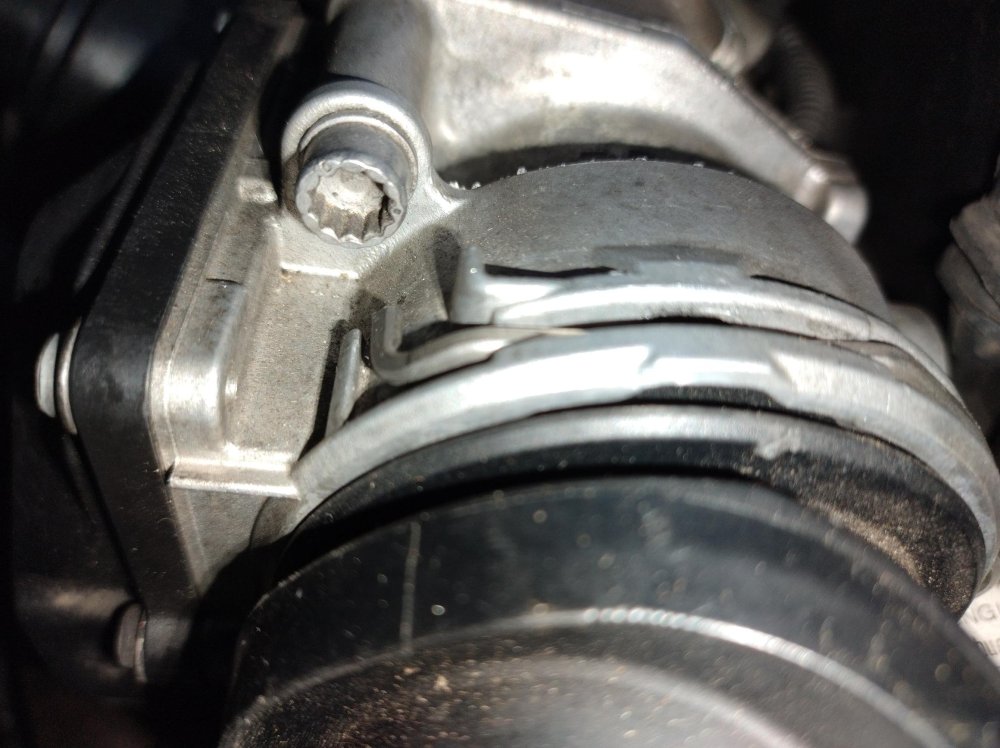

2009 Scout mk2 2.0tdi, running rich, worse fuel economy, sluggish, blows some black smoke
lmfao thanks for the help

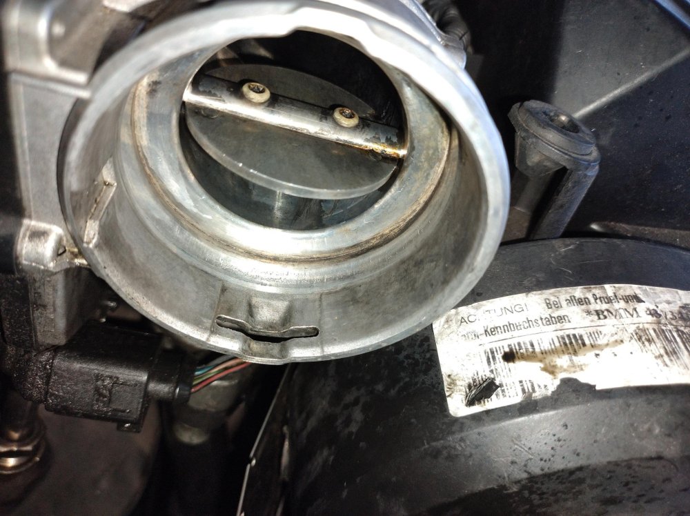

NOPE NOPE NOPE, throttle body flap or TPS was not the problem. The wastegate actuator was stuck, used penetrating oil and got it moving again, seems to have fixed these issues.
Thanks, need to buy more tools to get TB off, also another nightmare D connector will not come off
Thanks guys, Would bad injectors cause misfires also? I really don't want it to be injectors because $$$ I am assuming that the throttle flap always being open at 94.9% would cause air fuel ratio problems?
Hi, thanks for that. Can you recommend a good free scan tool ap for android, I am using Car Scanner and it's not the best, and I am not that good at reading data. Anyway, thanks for your comment, yesterday I started looking at stuff/data/sensors in Car Scanner and noticed that the throttle position sensor was at 94.9% at idle, as I revved the car the other sensors showed normal movement but the TPS stayed at 94.9%. So today I took some parts off the engine to get to the throttle body, yes the throttle flap is in the open position (obviously with the car turned off). My understanding is that this flap should be closed at engine off and only slightly open at idle? I could not take the TB off because it's got some god forsaken triple square spline 12 point bolt on it x3. I think the bolt is M6 not certain if its spline or triple square? TB was fairly clean but I sprayed it heavily with carby TB cleaner and let sit for 15 minutes whilst I swore at the bolt. I also gently moved the flap close open a couple of times, and it moved smoothly, it wasn't sticking on anything and the servo/motor didn't feel stuck either. I am wondering if the sensor is dirty/shot? I think I need to remove TB to get sensor out as it's all pushed up against the back of engine bay. I have massive problems removing D type connections for sensors, do you know how to remove this one, bottom of open flap pic? Where is the magic button you have to push/pull/twist? I haven't had any engine faults red or orange regarding this problem, its been running rich for a month+ but no codes. My new engine air filter had arrive so I installed that, Drove car and it had typical problems and after 10 minutes of driving I got my first orange warning light on dash (Coils/glowplugs - which can mean 1000 different things), I tried to code read but nothing was showing, and it cleared from dash when I turned off and restarted. Car drove well without problem (but sensor still showed TPS open at 94.9%). Later today I will do another ecu reset by removing neg battery terminal. (also this car has the goes into limp mode when driving on highway at speeds greater than 90kmph - but that's another problem).

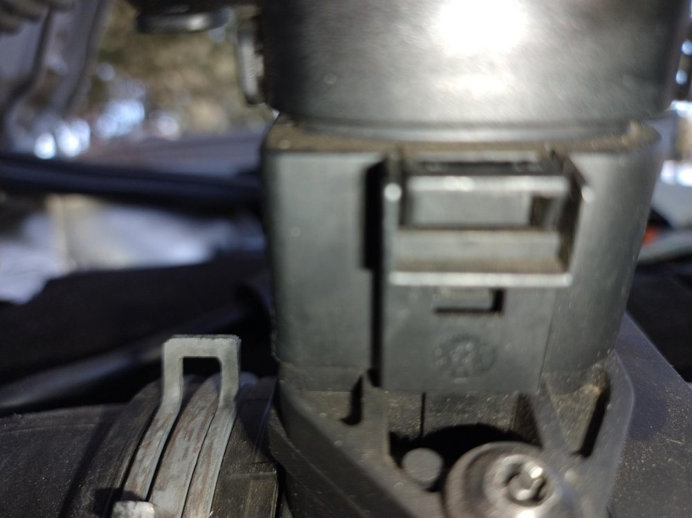

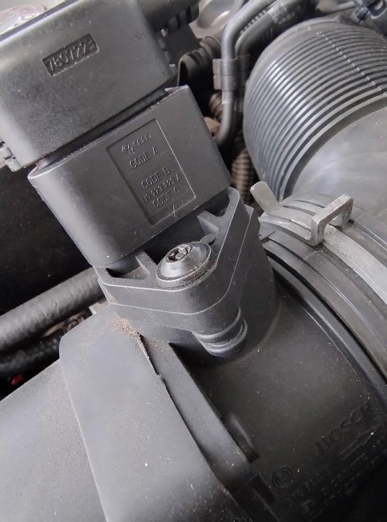

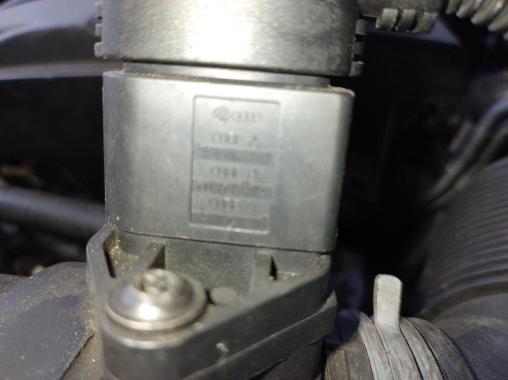

how to disconnect MAF Sensor electrical Connector, MY10 SCOUT 2.0tdi Diesel

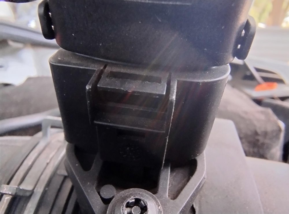

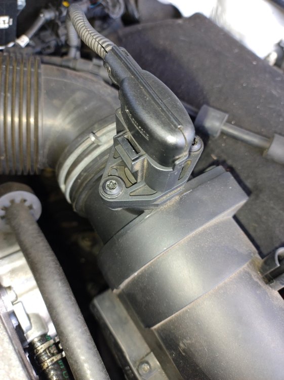

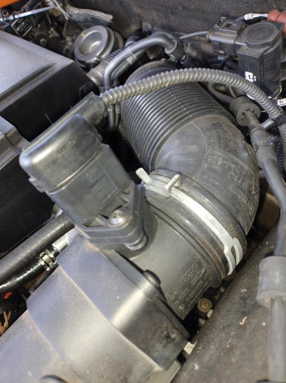

Hi thanks but no luck. I can push the connector to the sensor slightly. But pushing that tab does not move it, either into connector or down or up, it just doesn't move. I have used a lot of force but that tab is bending. Edit, finally, pull top tap directly up, I did not feel it move or click or anything but then also pulling connector up it came off.
Also, I have tried pushing a flat screw bit into the rectangular hole underneath the tab, as this is where I believe the locking thingee is, but no amount of fiddling worked. There is not enough room to use the full length screwdriver here as it is too close to the engine.
Hello, 2009 MY10 Skoda Octavia SCOUT wagon Diesel 2.0tdi, BMM, manual. Australia. Trying to clean MAF sensor. I cannot work out how to undo the sensor electrical connector. (I am not talking about removing the security torx screws to remove the sensor unit itself, just the connector.) I have looked at 50 youtubes and lots of google searches, no other maf sensor looks like mine, link me to a vid etc. Can someone please explain in the most simple baby steps how to undo this maf sensor connector. I have tried pushing in sensor and playing with the rectangular tab with a hole in it, nothings works. Thanks.
