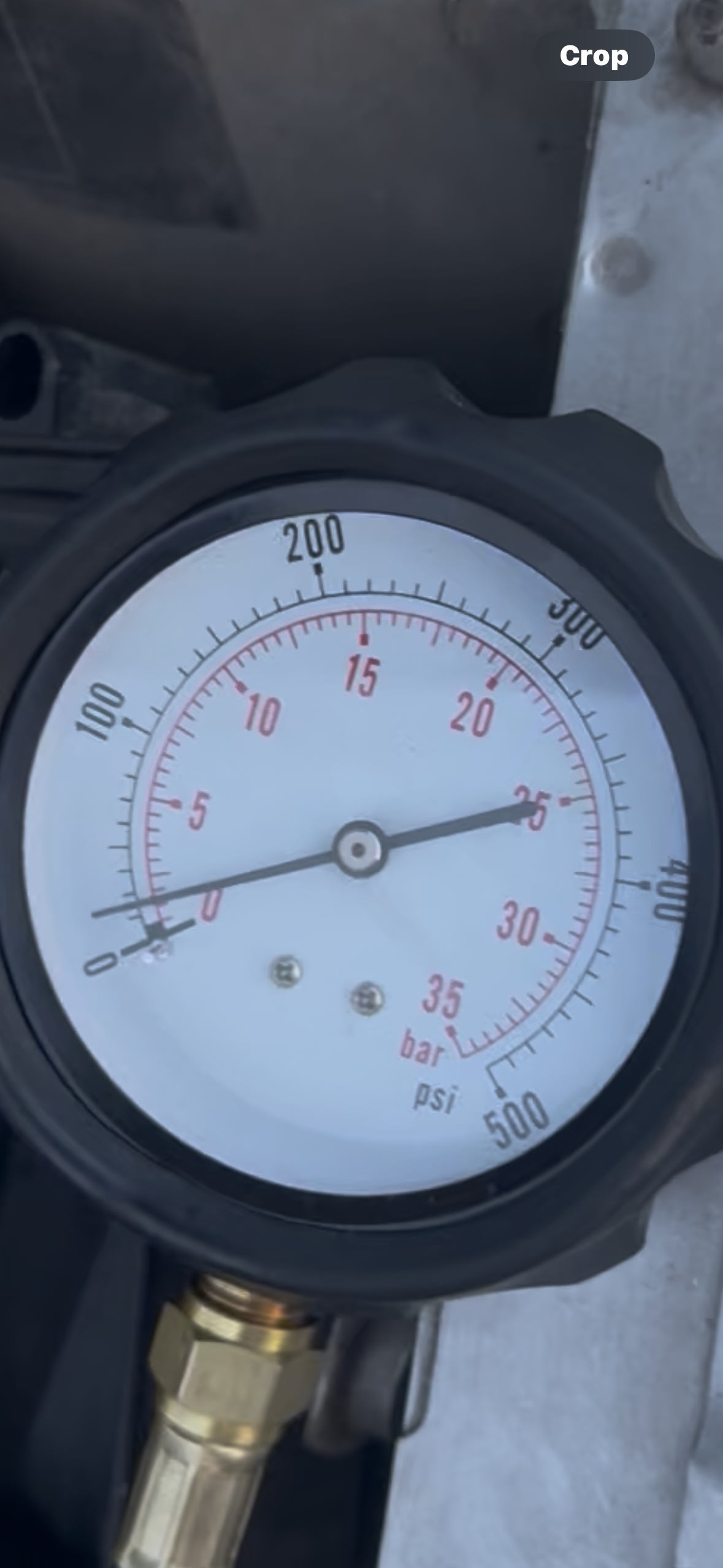

  10. Can’t add the other photo but at 3k revs it’s just under the 5bar
  11. I appreciate all your guys help this is idle

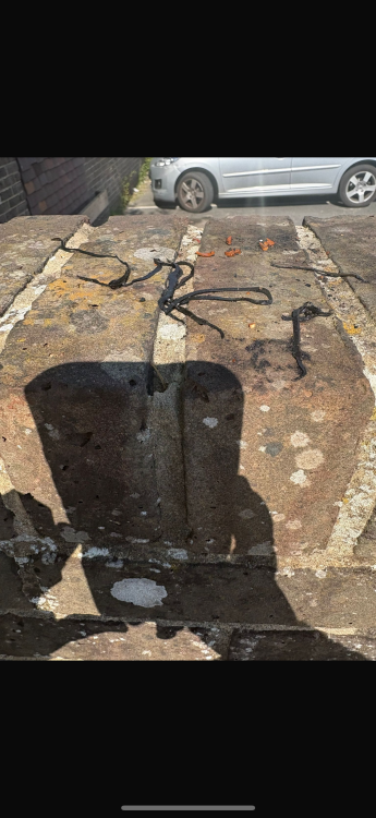

  12. Ahhh sorry I threw them. I’m pretty sure like paws has said someone has changed it and snapped some down the hole easily done. I suppose the oil pressure runs at 10-15 psi when idle and 50psi when at 3k revs
  13. Of course why didn’t I think of that! It looks brand new aswell. 😅 it’s all clean now and fresh everything!
  14. Surprisingly they are hard to come by where I live so I’m going to have to travel if i want to get a new engine/turbo it’s runs now without a turbo so I’m not to sure. Would a blocked oil strainer cause it to have a red oil flashing light I’ve attached a picture of the orange bits
