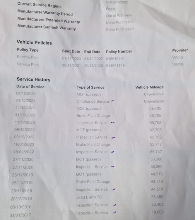

  1. @Danoid @travs - thanks very much for your replies. "Wait for confirmation on the belt (and whether I’ve got anything wrong!)"....will do....
  2. Thanks @univer Holding for second opinion.....👍
  3. Hello. I'm interested in buying a 2015 (65) Skoda Superb Estate DSG 2.0TDI 150ps. Mileage is 77,665. It's at a car supermarket and the dealer has given me a copy of the service record. A snippet is below. The thing is, there's no record of the DSG fluid being changed, or the timing belt being changed. The dealer has said they have tried to get that info. without luck. Is it foolish to buy the car without proof of those two things? Even if the dealer did those jobs now, is it likely the gearbox is damaged if the fluid had not been changed? Thanks for your help Howard
