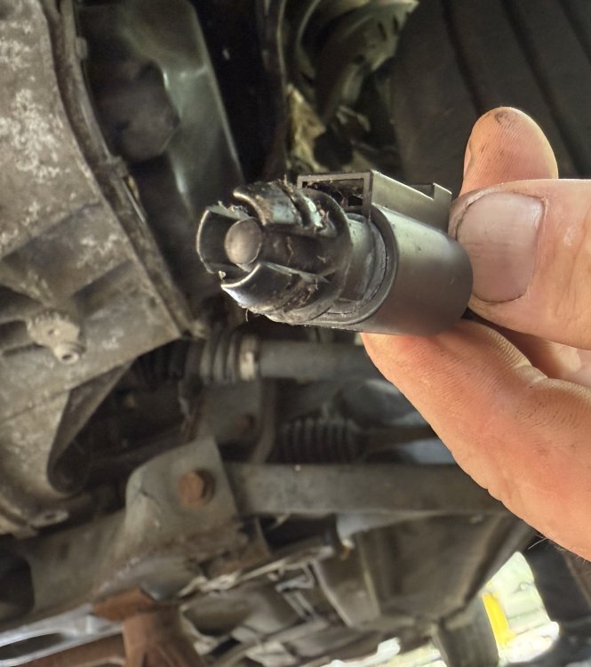

  8. Hi, would anyone know what this electrical thing is dangling from the front of my car, and where it should go?? Thanks in Advance
