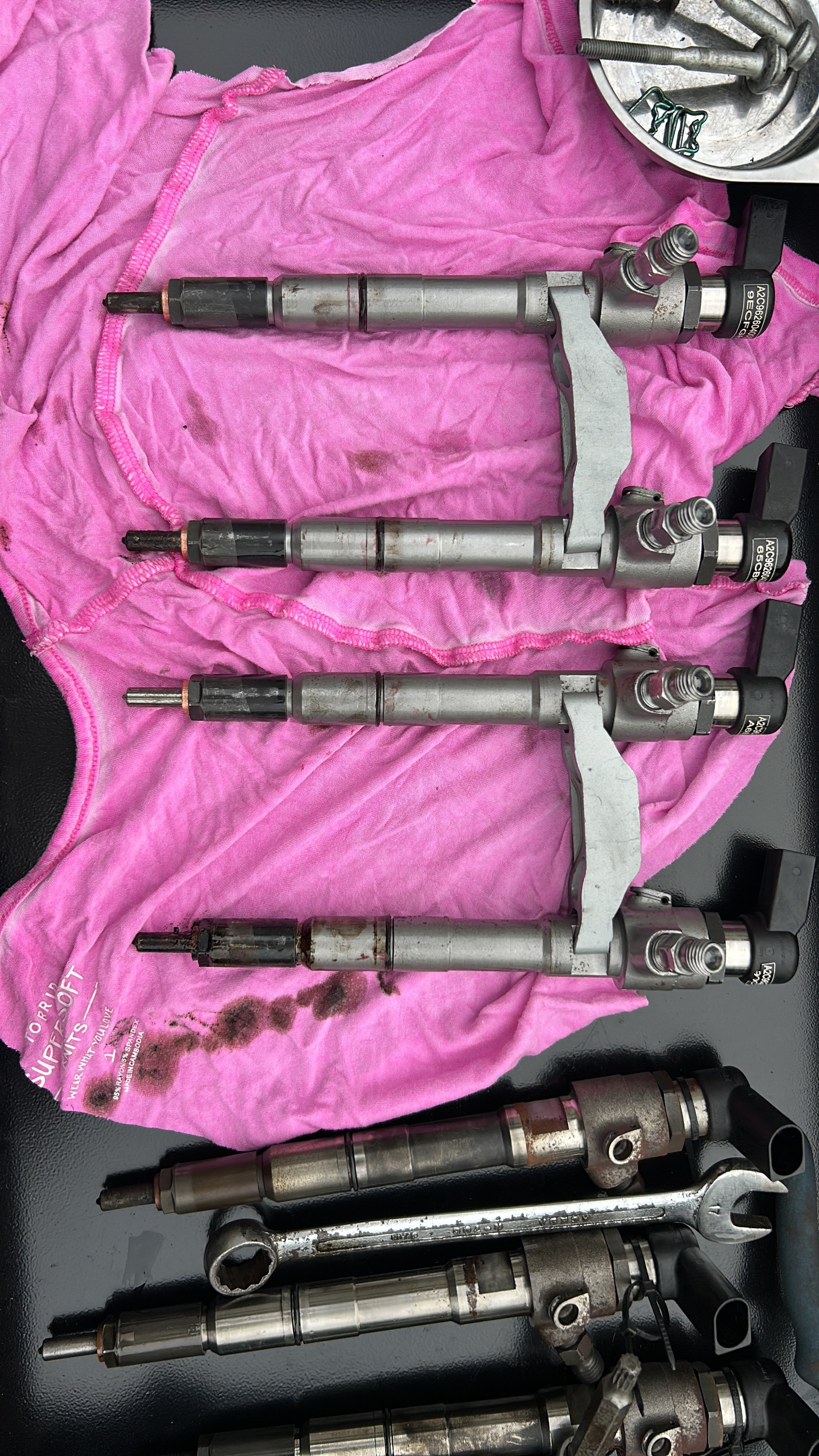

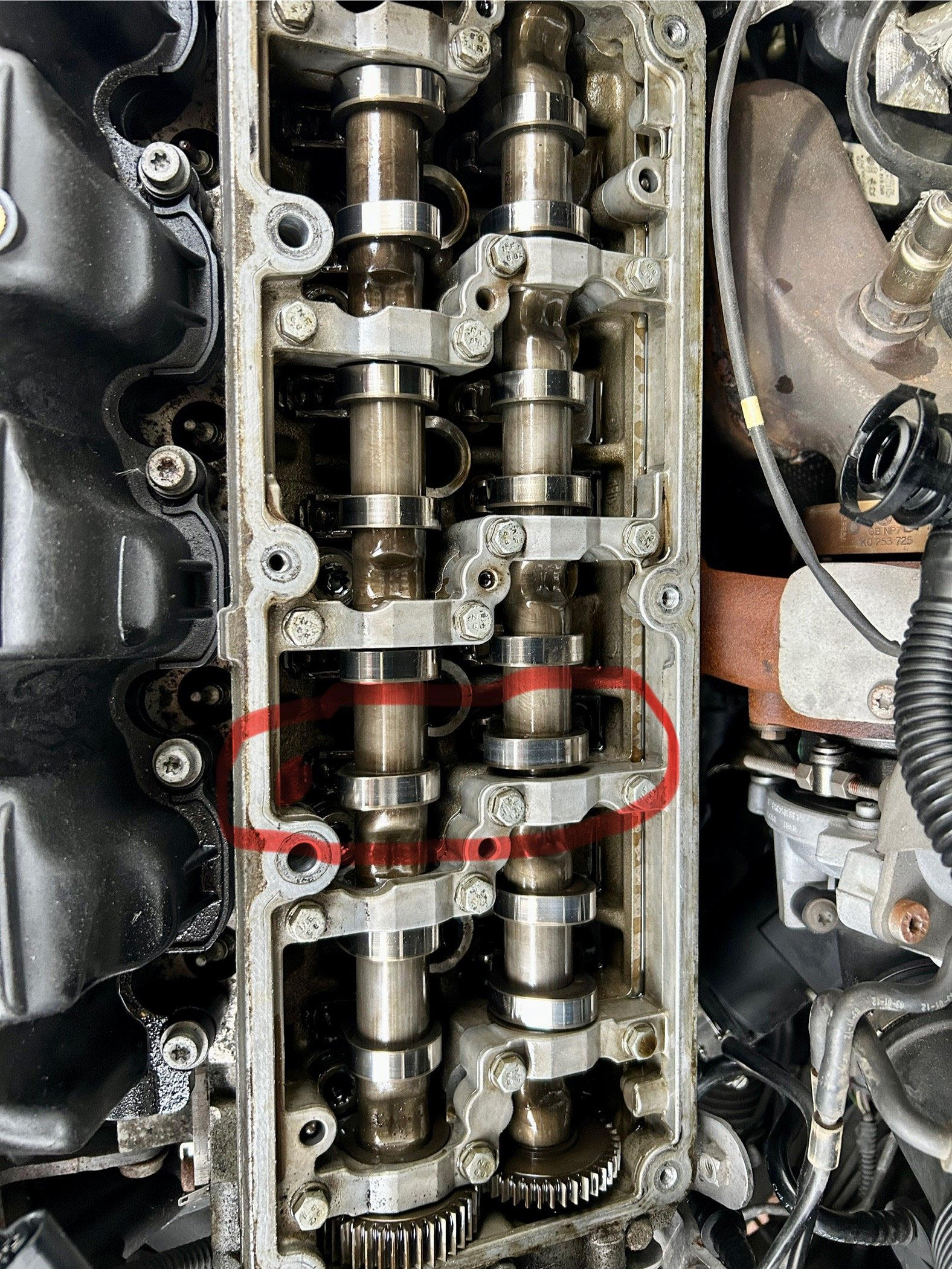

  1. Little update I Have the car back with ECU rebuit as it had intermittent fault car still has knock rattle at cylinder 3. Wiring loom has been check and I have no broken wires in loom from ecu to injectors. I did remove injector 3 and noticed it was still like new as if no fuel had been burnt and put a 2nd hand one in known to be good as it had been tested still same. But still same knock/rattle. I used a stethoscope and listened to each injector all sound the same. I have now removed all injectors and 1,2,4 are used looking and 3 is clean this can see in picture attached. Removed rocker cover and nothing jumping out as no filings etc and I have read that this engine is prone to top end wear although I have circled and inlet and exhaust lobes on cylinder 3 as these 2 lobes are slightly different colour. there is no smoke from car as it’s really only ticking over oil still clean etc and no sign of fuel mixing into oil as I would expect that if there was a ring problem. Just don’t know how much further to go here.
