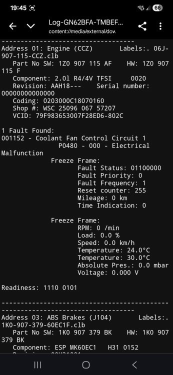

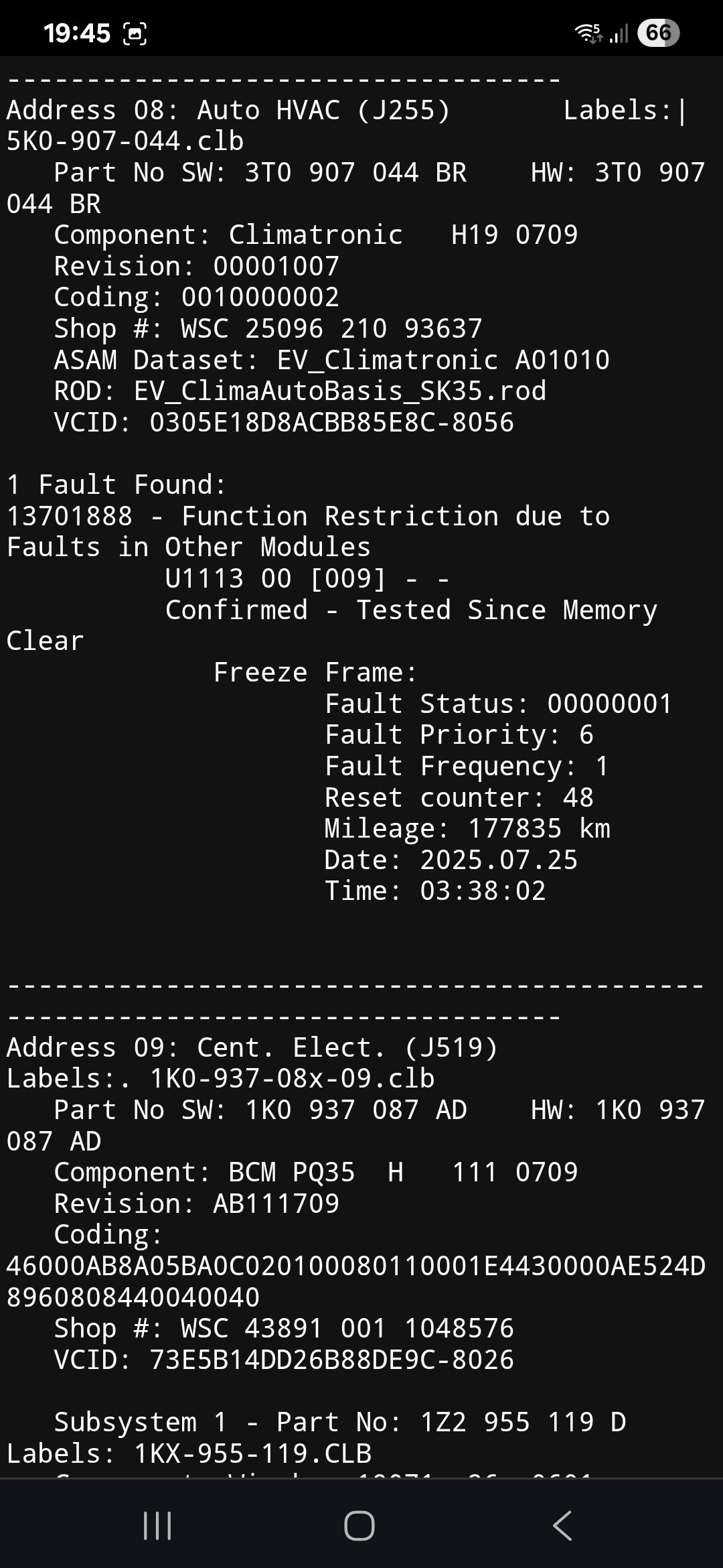

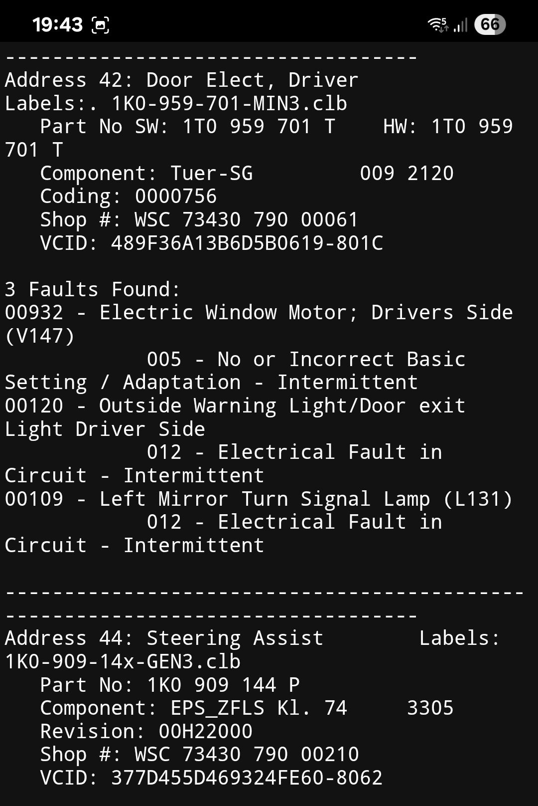

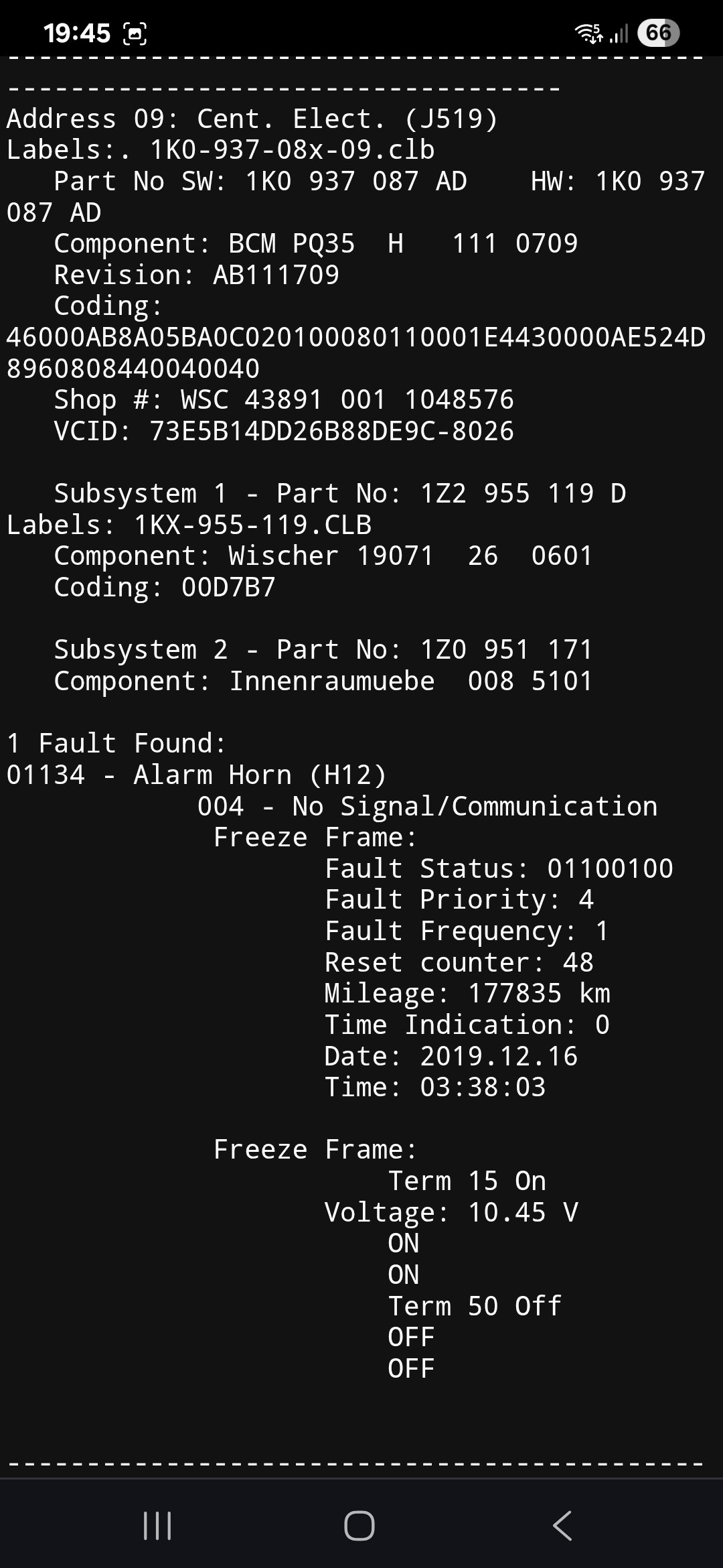

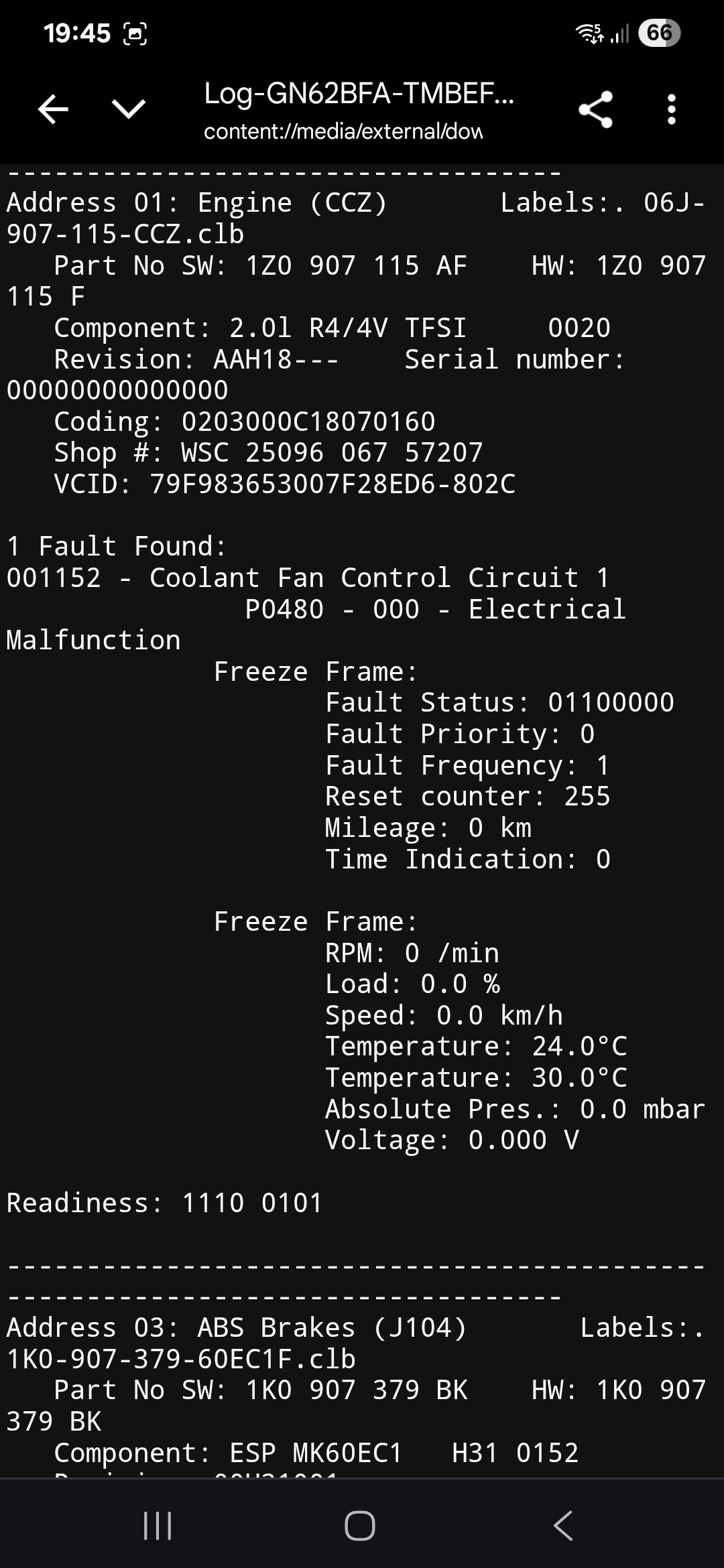

Current fault codes - rad fan, new one on its way. Hvac fault due to rad fan issue. Siren dead, have taken fuse 35 out and might replace in the future. New drivers door as the garage I bought it from tore it apart to get into the car after the broke the door lock and let the battery go flat. Will look to recode it at some point, but shouldn't cause the hazard issue? Cheers, Colin
