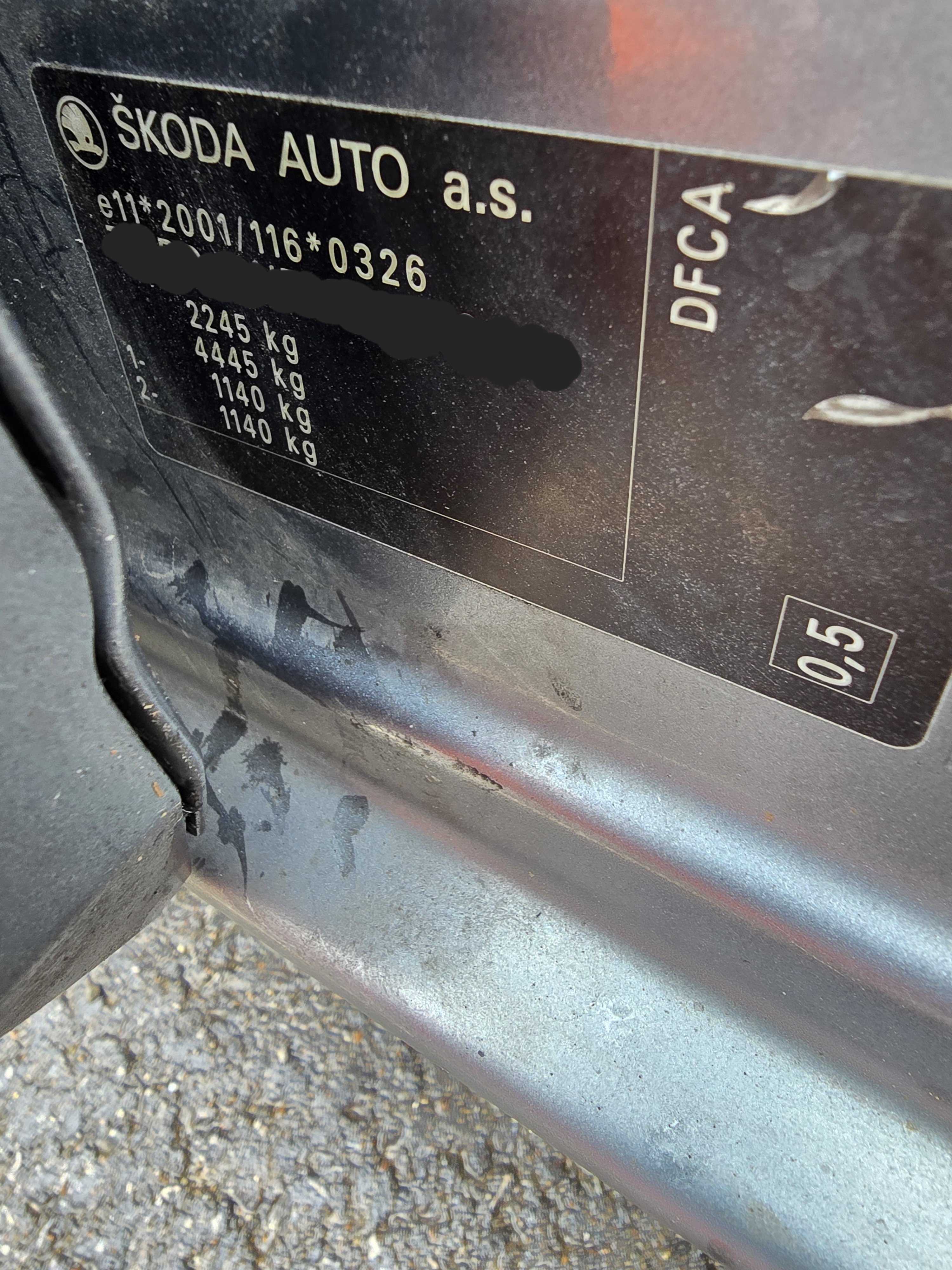

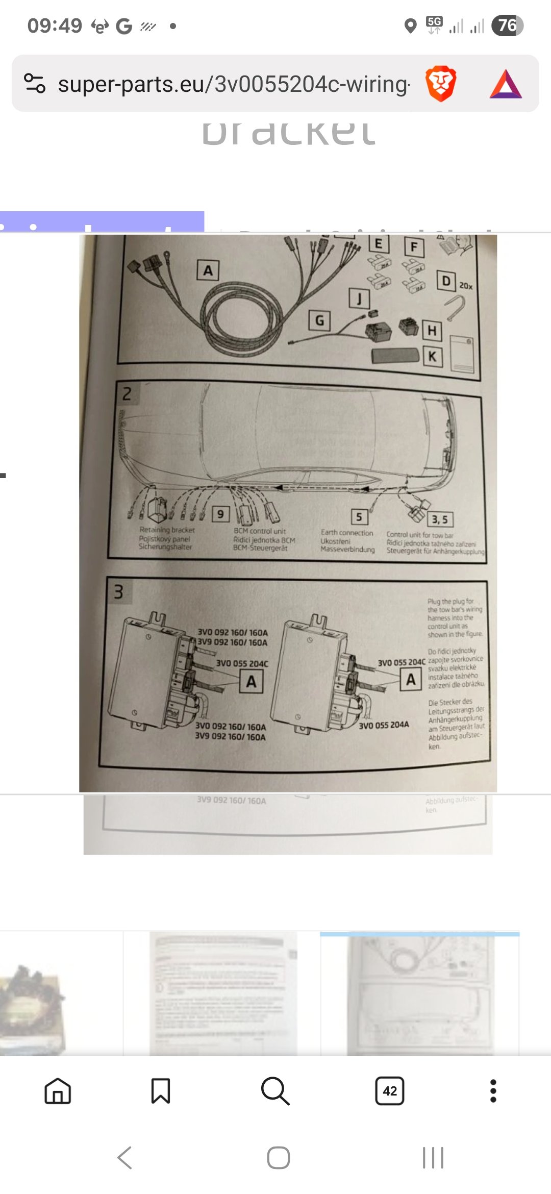

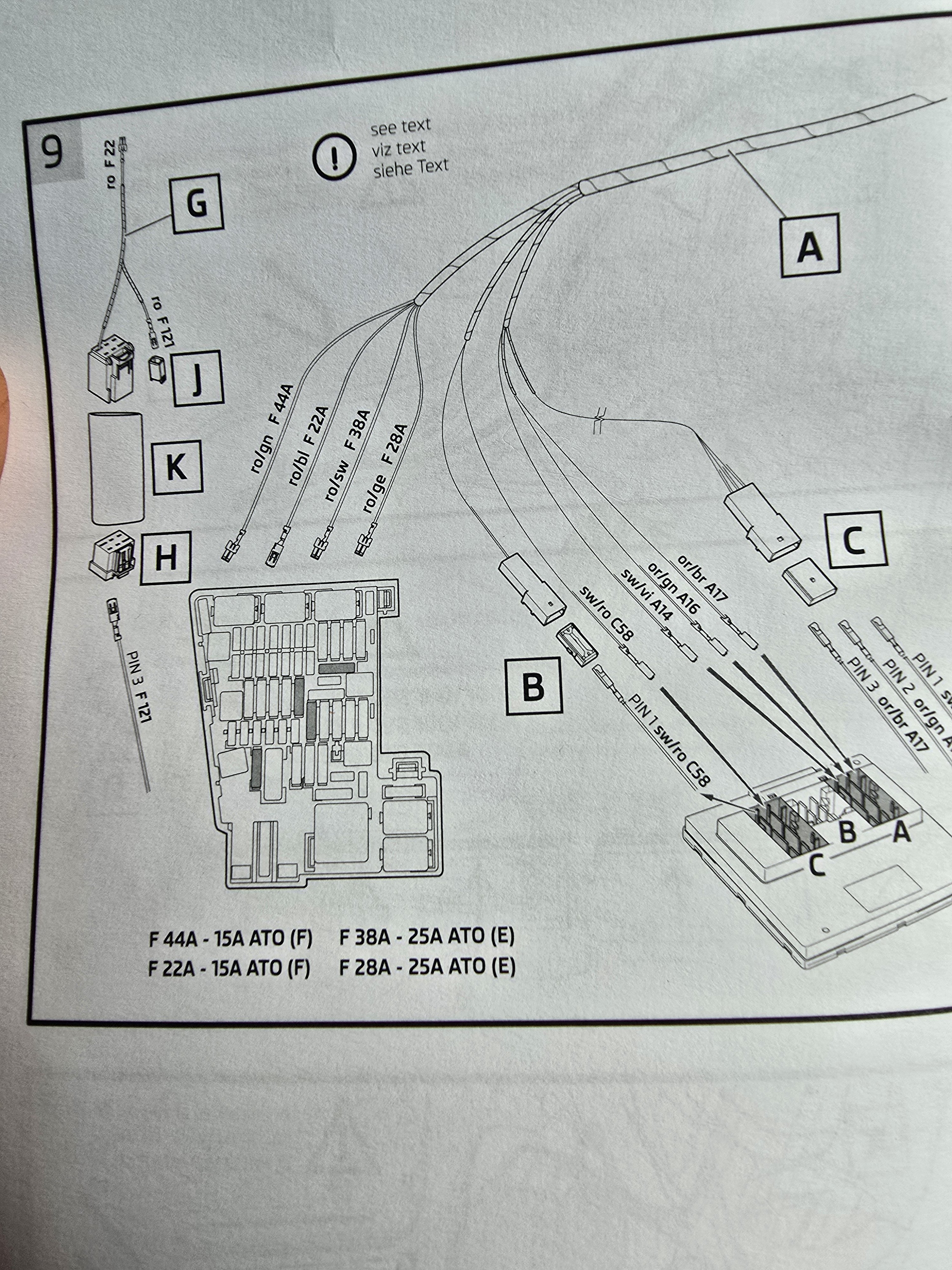

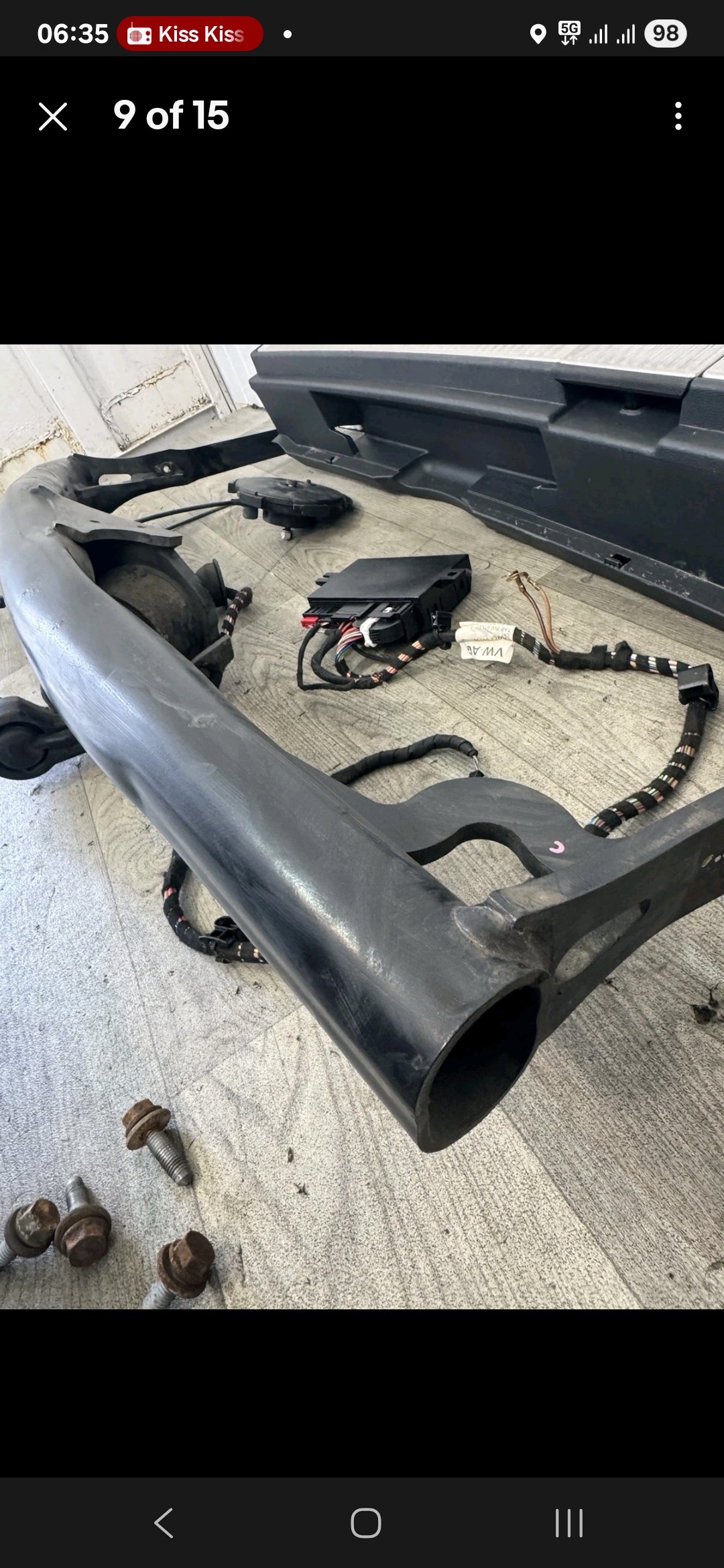

  1. On the vin plate is showing the gross towing weight My concerns was that skoda will not install a tow bar on my car configuration 2.0 140kW TDI DQ 4x4 engine, retrofitting a towbar is not possible They didn't give me any explanation why I bought full towbar from another skoda Wiring is a bit difficult The book I have doesn't explain in details I need to research more so I don't make any mistakes
