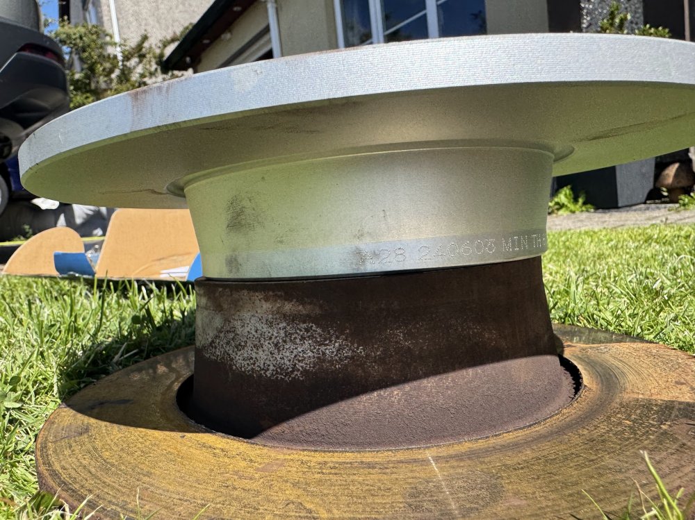

  1. They supplied what was marked as the part on their website but i was unaware there were two versions so doubt i'd get anywhere. I took off the parking brake via the normal switch and then ran the 'start lining change mode' in VCDS to roll the EPB back while having a battery charger attached.
  2. Bought them a few months back and only got round to 'fitting' them today and its a 28day return policy - ill see if anyone on FB marketplace or ebay is interested and if not ill turn them into functional sculptures or something
  3. Yeh just frustrating that left with essentially useless discs - will look to get some 58mm ones from the local merchants. Shouldn't have relied on the put your vehicle in and here are your parts etc...
  4. Looks like on the Halfords website they are quoted as 48mm discs but on other websites 58mm discs are quoted for the rears ...
  5. Just gone to replace the discs and pads on my Karoq with Pagid ones that I ordered from Halfords but realised that the central hub part of the discs isnt deep enough ? Ordered as per the halfords search and they sent these - 272mm diameter - Pagid Brake Discs 104442078 They are the correct diameter but are no way near deep enough ? Difference of about 8/9mm Anyone know what part number is should be ? Bit annoying as given they have been opened and ive tried to fit them i cant look to take them back :(
