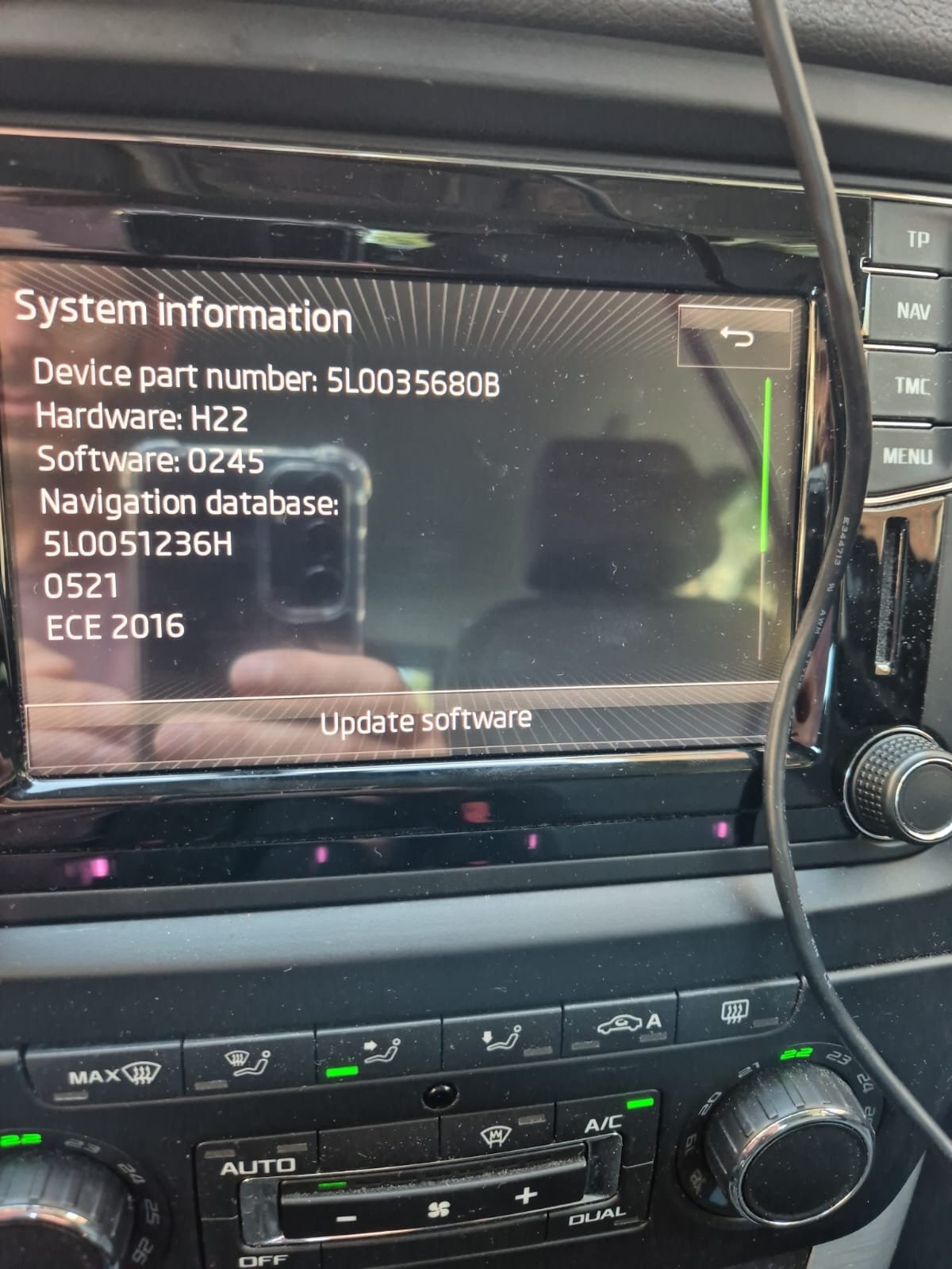

  5. Eranb52 posted a topic in Skoda Yeti
